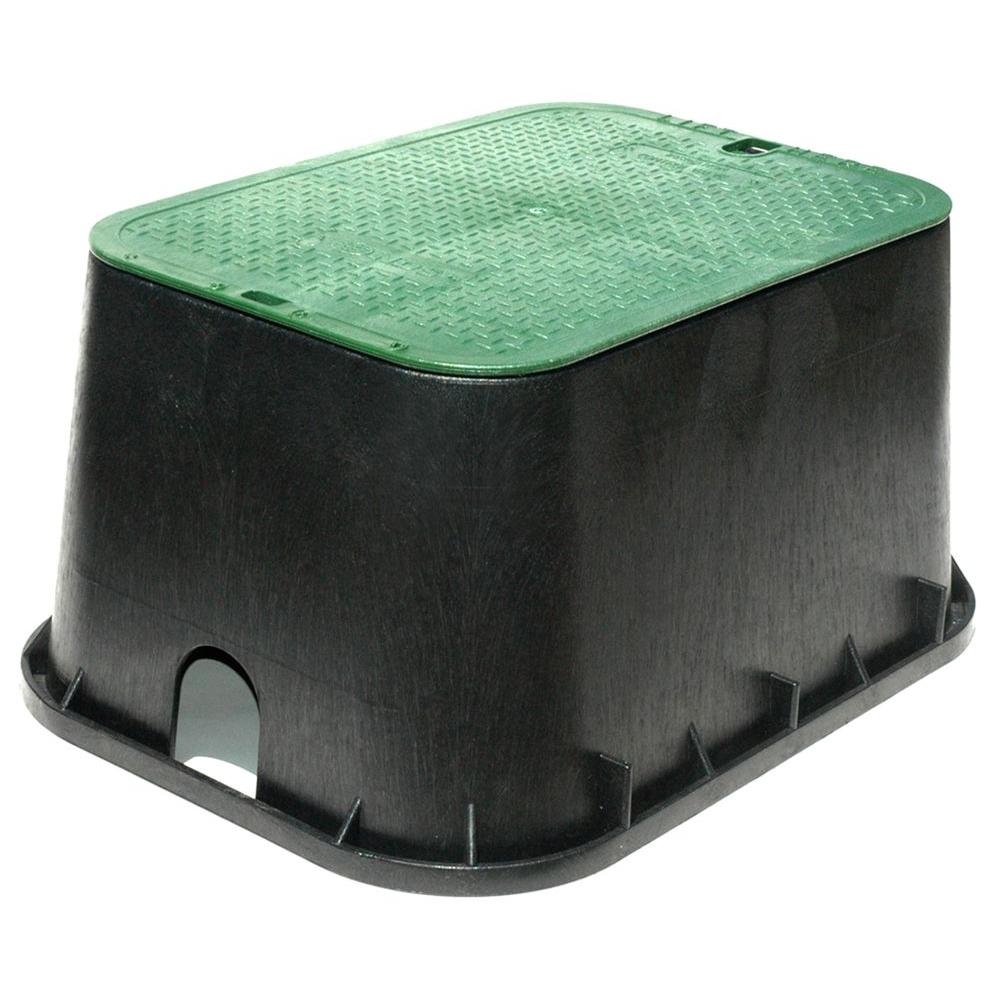

Is it OK to put a plastic landscape irrigation box OVER the concrete D-Box?
I want to be able to access the D-box without having to dig in dirt to uncover it. So I was thinking of placing a plastic landscape irrigation access box over it and that will give me easy access later on.
/ Septic System - Infiltrator System #84
I would be concerned with freezing here with that box unless I packed some insulation in. The standpipe that is buried 4' from septic tank to d-box froze where it came up to the d-box (d-box only 12" or so below surface). We dug down and drilled a small hole in pipe and then put drain rock in, no more freezing (that was 23 years ago).
/ Septic System - Infiltrator System #85
I see no reason why the irrigation box wouldn't do the trick. I often put risers on the D boxes for easy access.
Mine is at the surface and has never froze. The only time I can see that being a problem would be if the field was backing up so the effluent was above the distribution pipes.

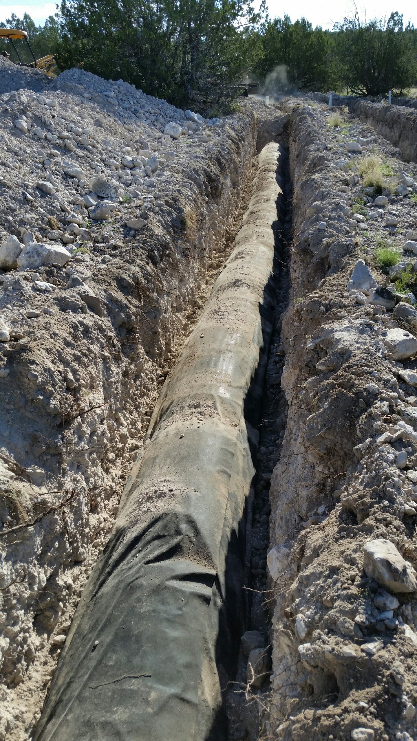

I added the landscape fabric and the fields were covered over today. Project is complete!
/ Septic System - Infiltrator System #87
<img src="http://www.tractorbynet.com/forums/attachment.php?attachmentid=479292"/>
That is the last time you will ever see it, as good of a job as you did with it. Nice work!

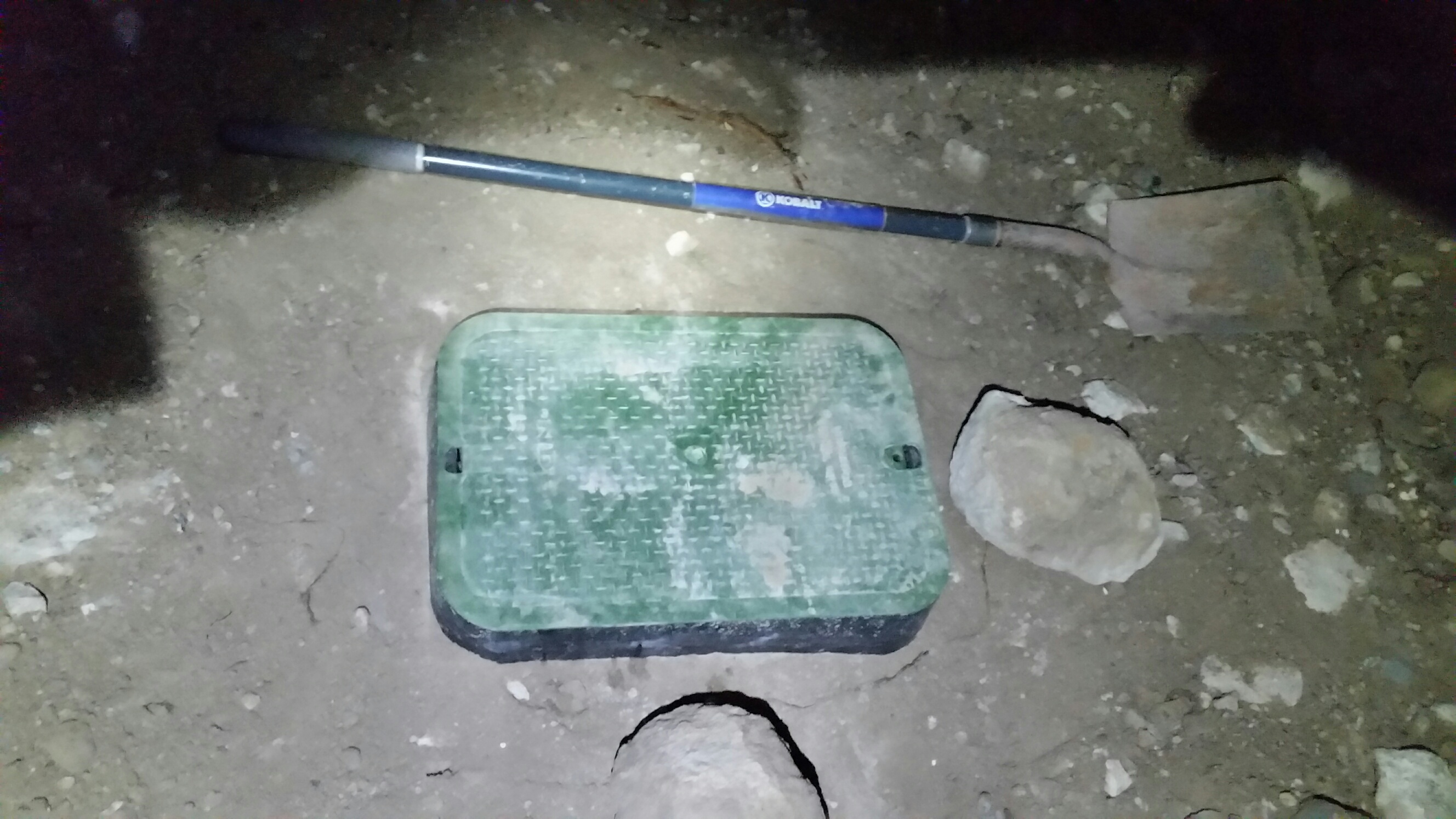

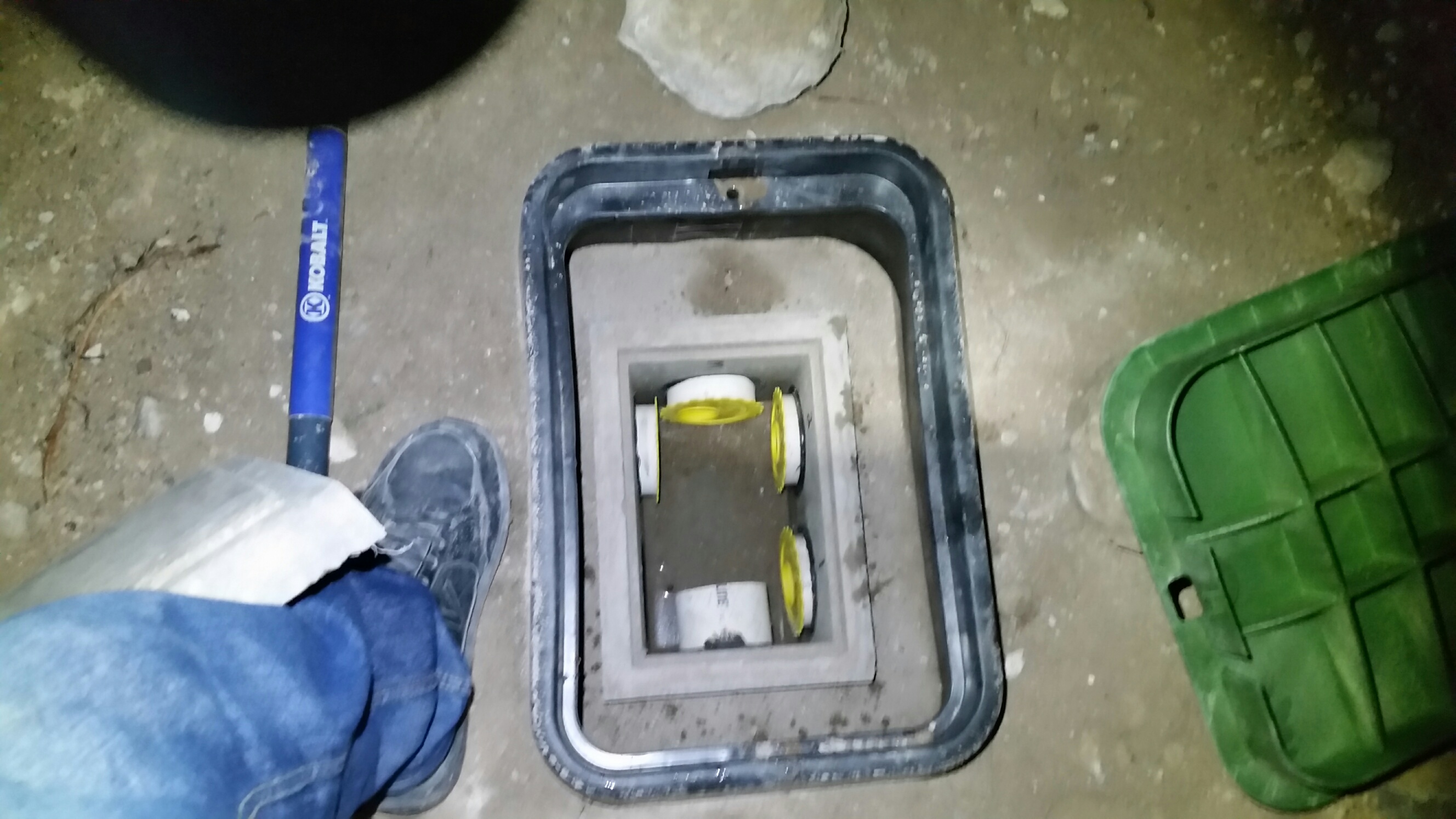

Got the landscape valve box in place over the concrete D-Box. Will make for easy access to check on the system to make sure it is working properly.
/ Septic System - Infiltrator System #93
^^^ I should have done the same when I recently had my septic pumped... it is always a pain to find the inlet and outlet inspections covers... the main lid not so much.

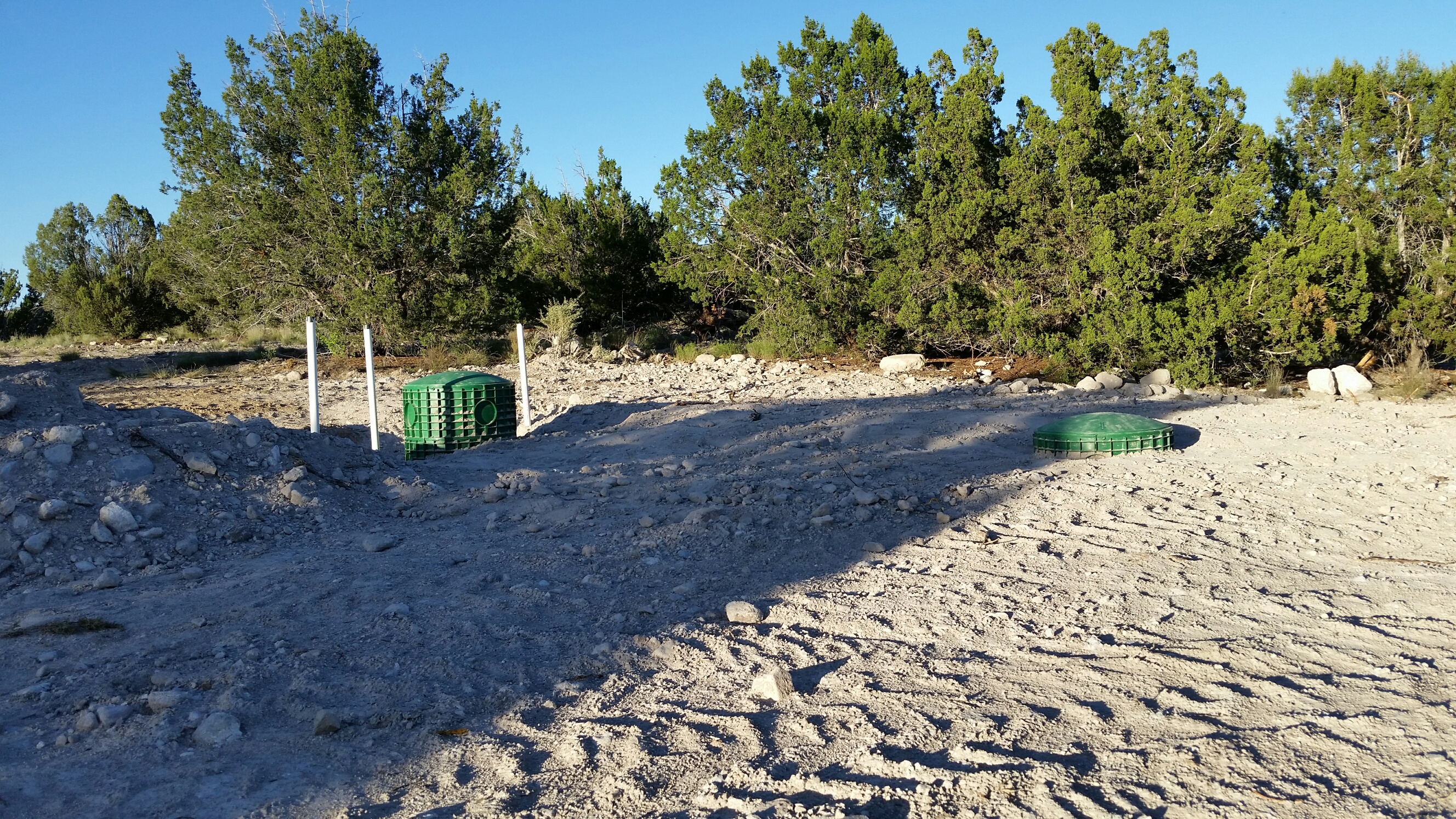

Put a foot of soil on top of the tank. I have the 12" riser showing on the 1st chamber (left side) but it might be a little too tall. Should I remove it and install a 6" riser instead of the current 12"? The finished grade is shown in the photo.
/ Septic System - Infiltrator System #95
It does look like a 6" would do the job. The systems I do since I'm getting paid the final grade I rake out just to the top edge so the customer is happy so it looks good aesthetically.
#96
I agree, I went with the 6" riser.
Good to go.
The county said it's one of the best designed systems they have seen for a residential. They approved it for up to 7 bedrooms and 1050 GPD
