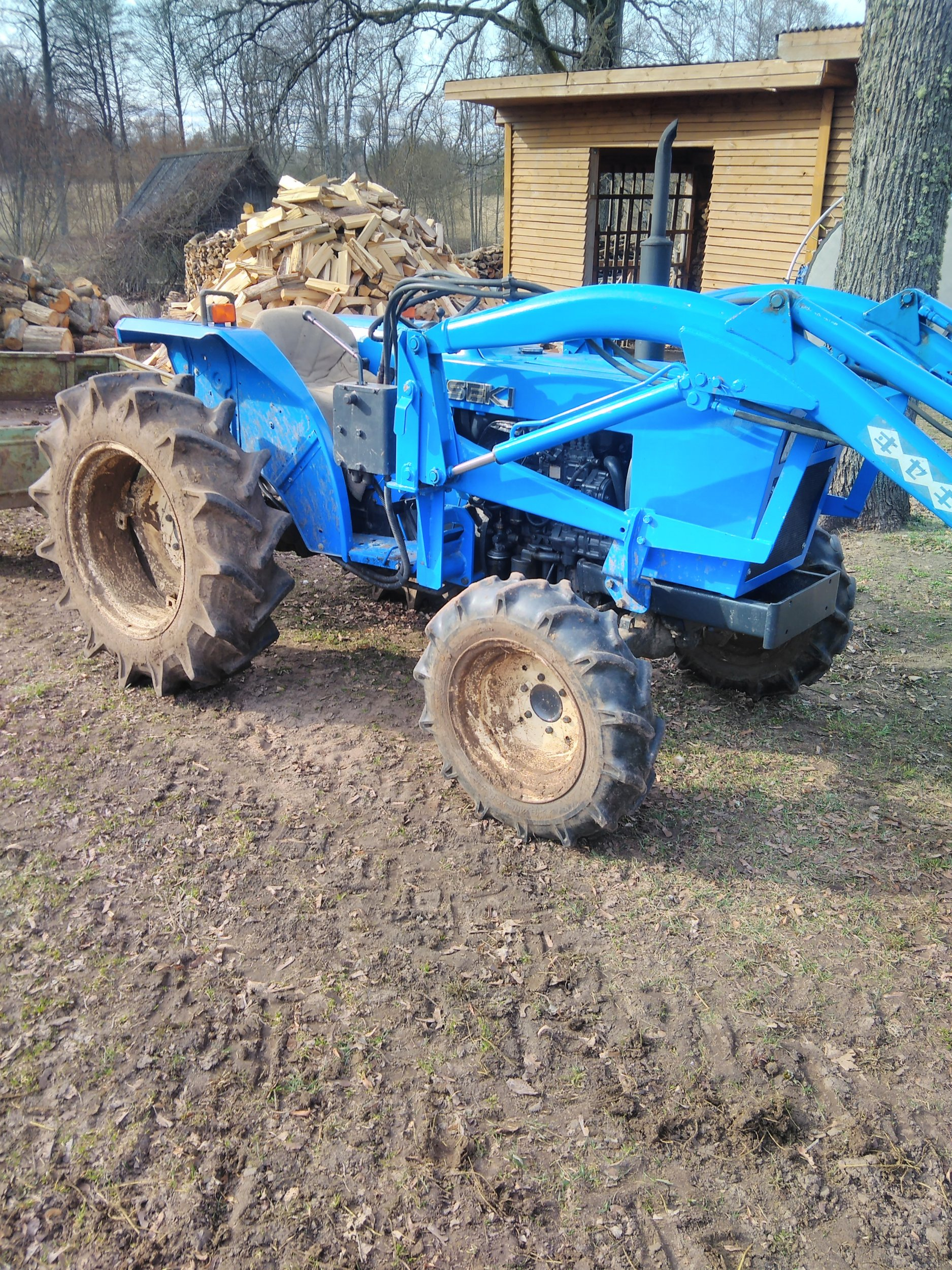

Hello Guys!
Some of you maybe have some Iseki TL2300F or TL series 4x4 service manual version?
My front right side wheel few days back started bleeding oil. Now I'm got off front wheel and thinking step by step what I need take off and repair.
There is my little trusty workhorse. :)
Cheers
Rudolfs

Thanks mate, I changed my front right axle oil seal. Now I would like to know how is the right way to check the correct oil level. Mine tractor has two screwable nuts in the axle for filling oil one upside, one at the downside. Now quastion is what is each of them for? ;)

Hey Ruud3a ! I would fill the upside till it starts to flow out a wee bit & wait for it to stop! Then put plug back in ,& go to the downside & do the same .:whistle:These are to lubricate the hub assembly,bearings , & pinions gears (y), You will notice how the front differential is offset on 4wd the downside gets less fluid & the upside gets more:unsure:! Just make sure You are on level ground & let then both weep fluid out until they stop then reinstall plugs ,Just make sure You have let all the excess fluid weep out, Or You will ruin the seals again overtime from to much fluid pressure:oops:! Good day mate.:cool:

Thank you very much! It helps me a lot. Now I need to do things this way how You describe. Good day You too mate! :cool:
