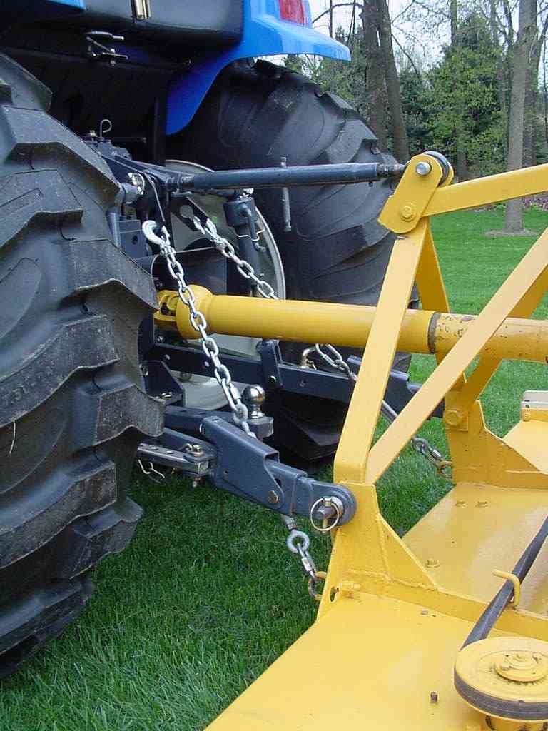

Ron,
I tried to PM you this photo but apparently PM does not allow attachments. Anyway, attached to this post is a picture I just took of the check chains installed on my B7400. As it happens, the Bush Hog is on the 3PH also. This setup should be identical to what yours would be like if you had check chains. Hopefully this will allow you see how they work.

As most have pointed out, check chains are the way to go.
I used to run a Howse 5' bush hog off of my TE20 for many years of good cutting. The check chains keep the depth accurate without having to constantly adj the 3PH and if you need to go into higher grass, you just raise the BH up, raise the chains where they connect at the top link connect a link then your GTG.
A pic of my setup. I've since sold it and find that I miss it some now /forums/images/graemlins/frown.gif as it worked great and gace a near finish quality cut for me for nearly 15yrs.
