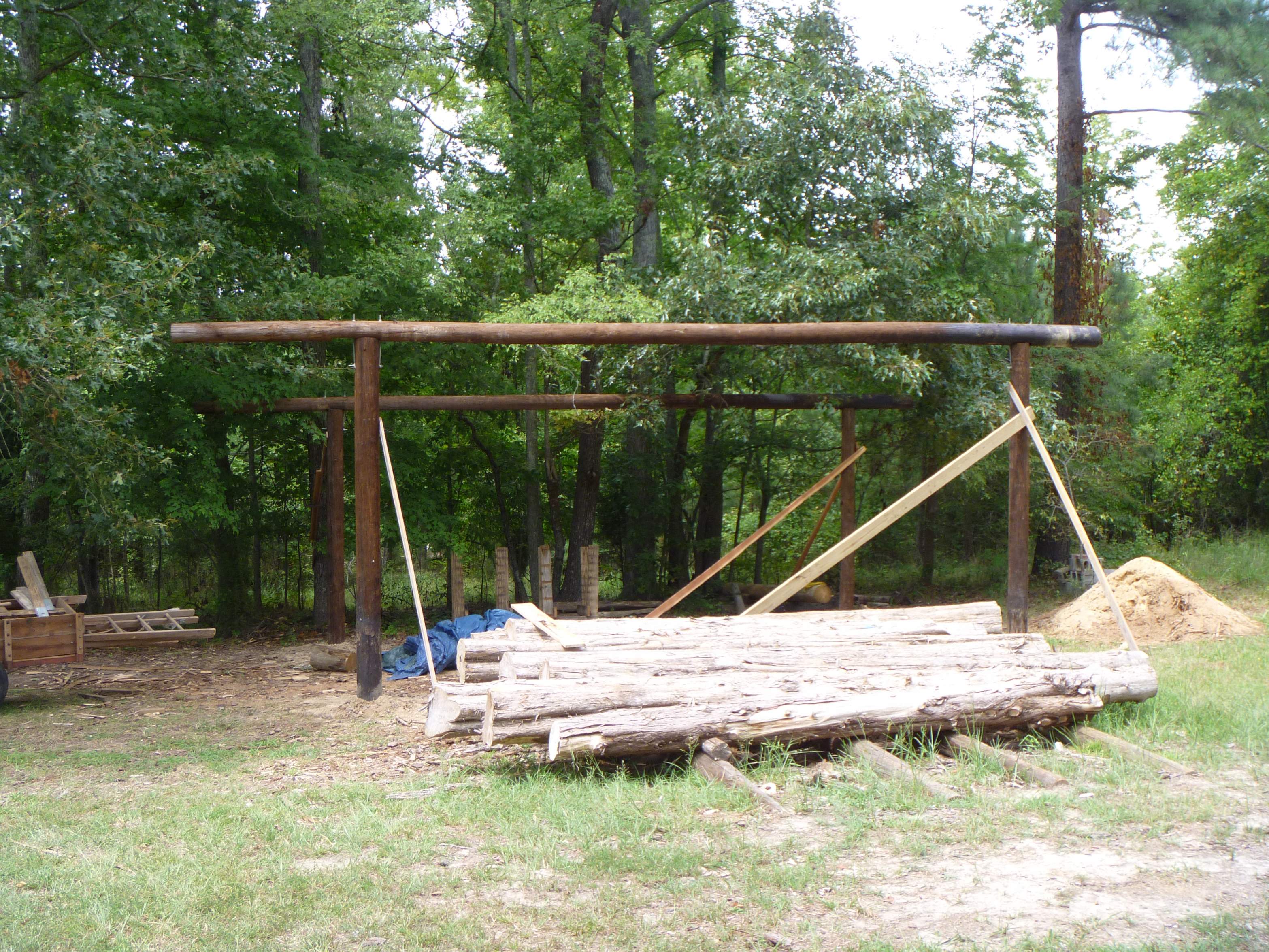

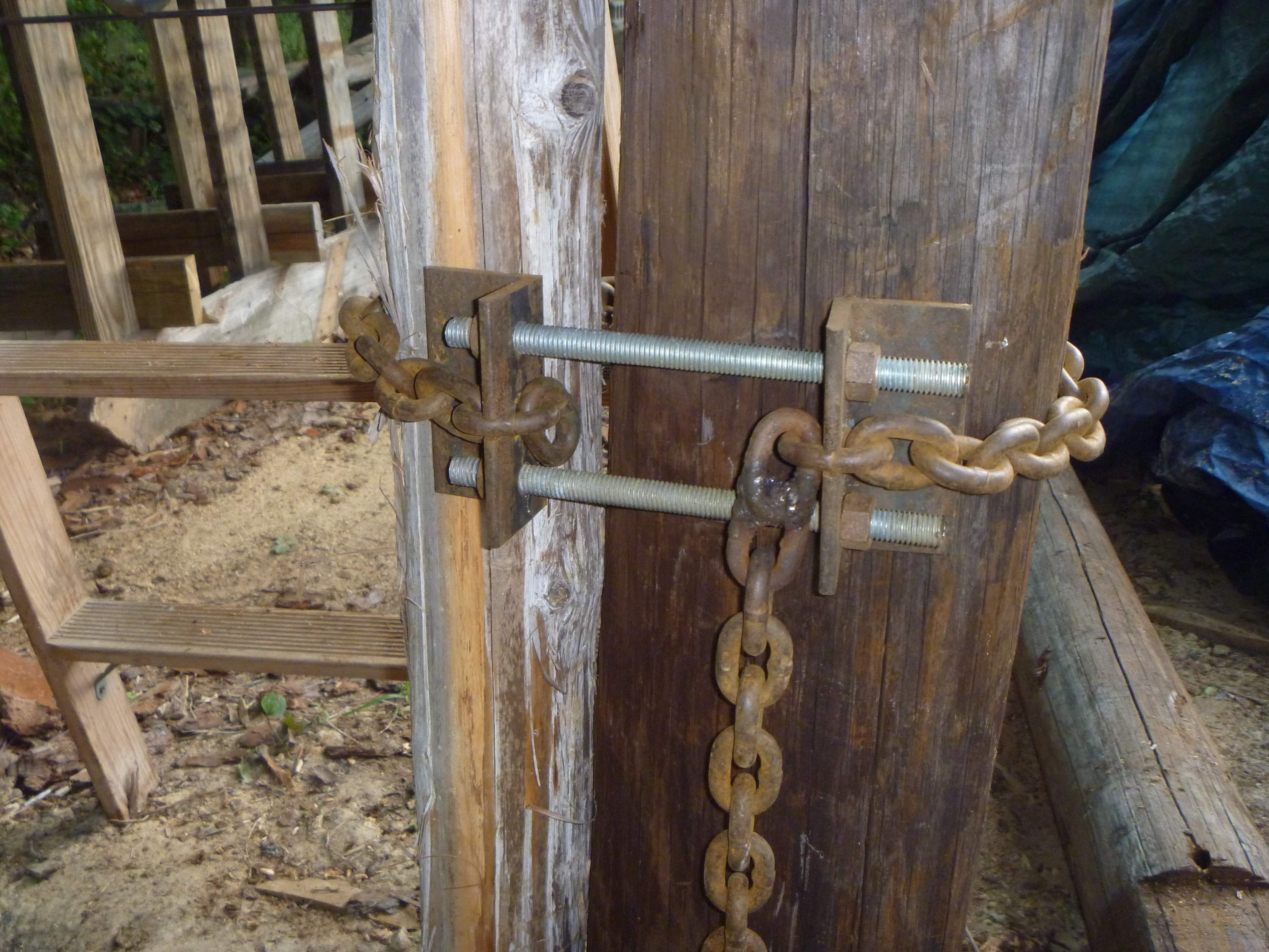

Well, I got the posts in the ground. A neighbor and I (mostly him) picked up an end and walked them up just as someone suggested. Piece of cake. Here are some pics as how we raised the beams in place. 1) Cinched a long cedar pole to two posts at a time and put a chain hoist on top. 2) raised them up in stages securing the load after each pull. had chains going everywhere, 3) after final pull the notched beams rested on top of the posts and were held in place with 1/2" threaded rod.
The rest of the sawshed awaits cutting pine rafters. Shed will measure 13 x 30 with a 21 foot open area.
