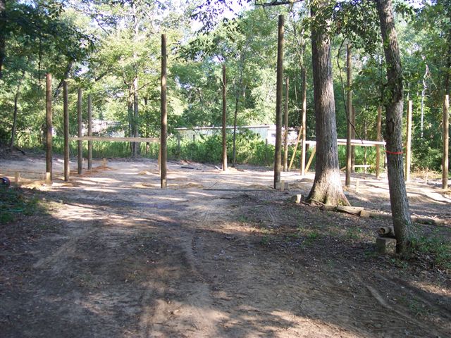

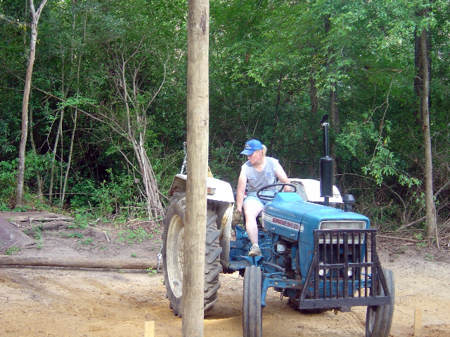

I set all my pole barn poles by myself with my boom pole on back of my Ford 3055. I would drag the pole to the hole, then position the traction to lift the pole, turning the tractor as I backed up and lifting the pole at the same time. I had the pole chained to the boom so that the butt end of the pole would be heavy. I put in 18 poles like this with the tallest two center poles being 22 feet long. It can be done alone, but real slowly, thinking all moves out carefully.
hugs, Brandi
Turning while backing prevents the post from leaning over your head as you set it, right? The post leans to the side and the tractor boom sorta swings it in place?
It kinda works that way. My old Ford 3055 could turn on a dime and give change.:cool: Just be sure the chain cannot become unhooked from the pole, but have enough slack to pivot
It realy is satisfying sitting your own poles.:D Good luck.;)
