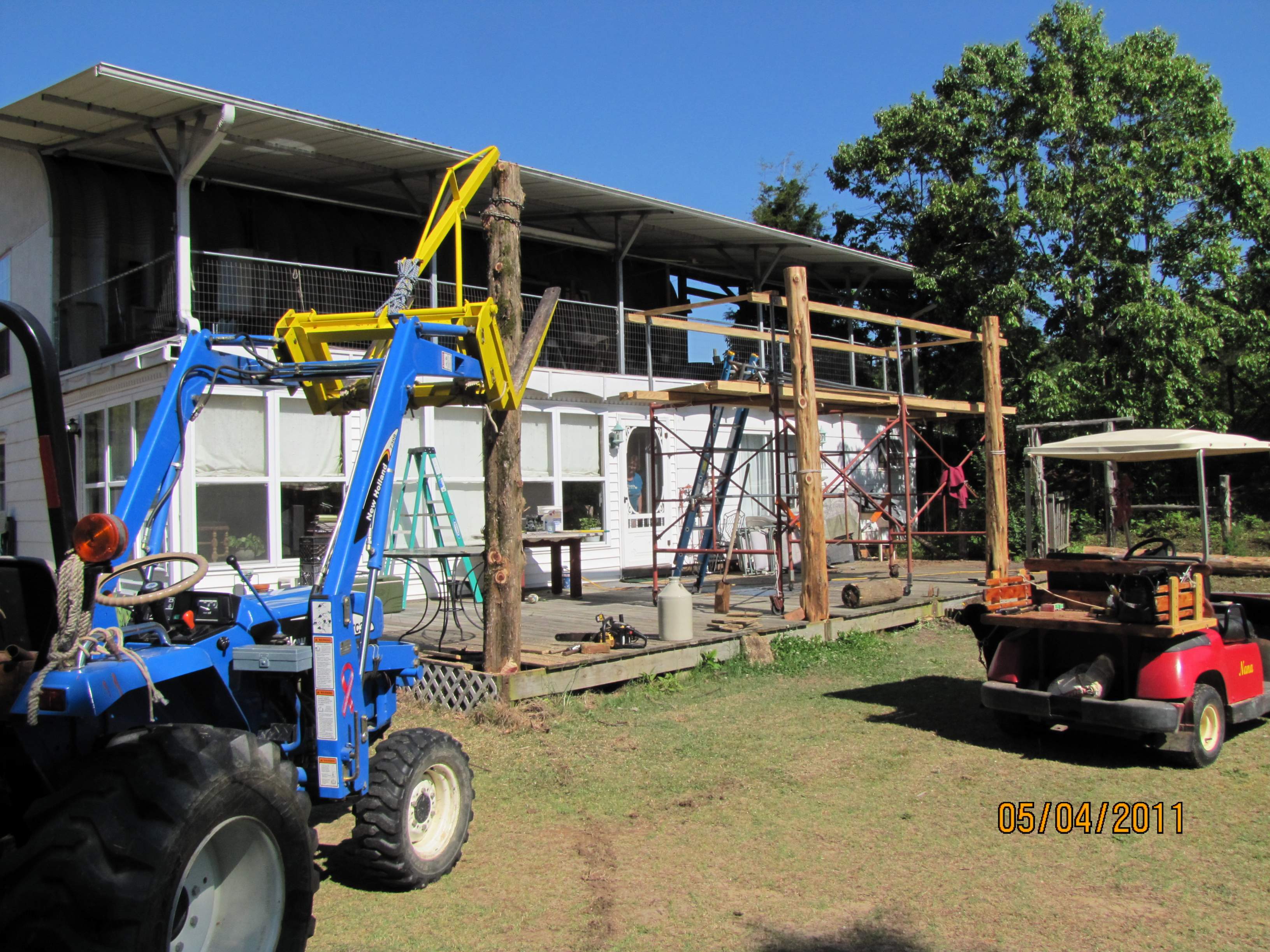

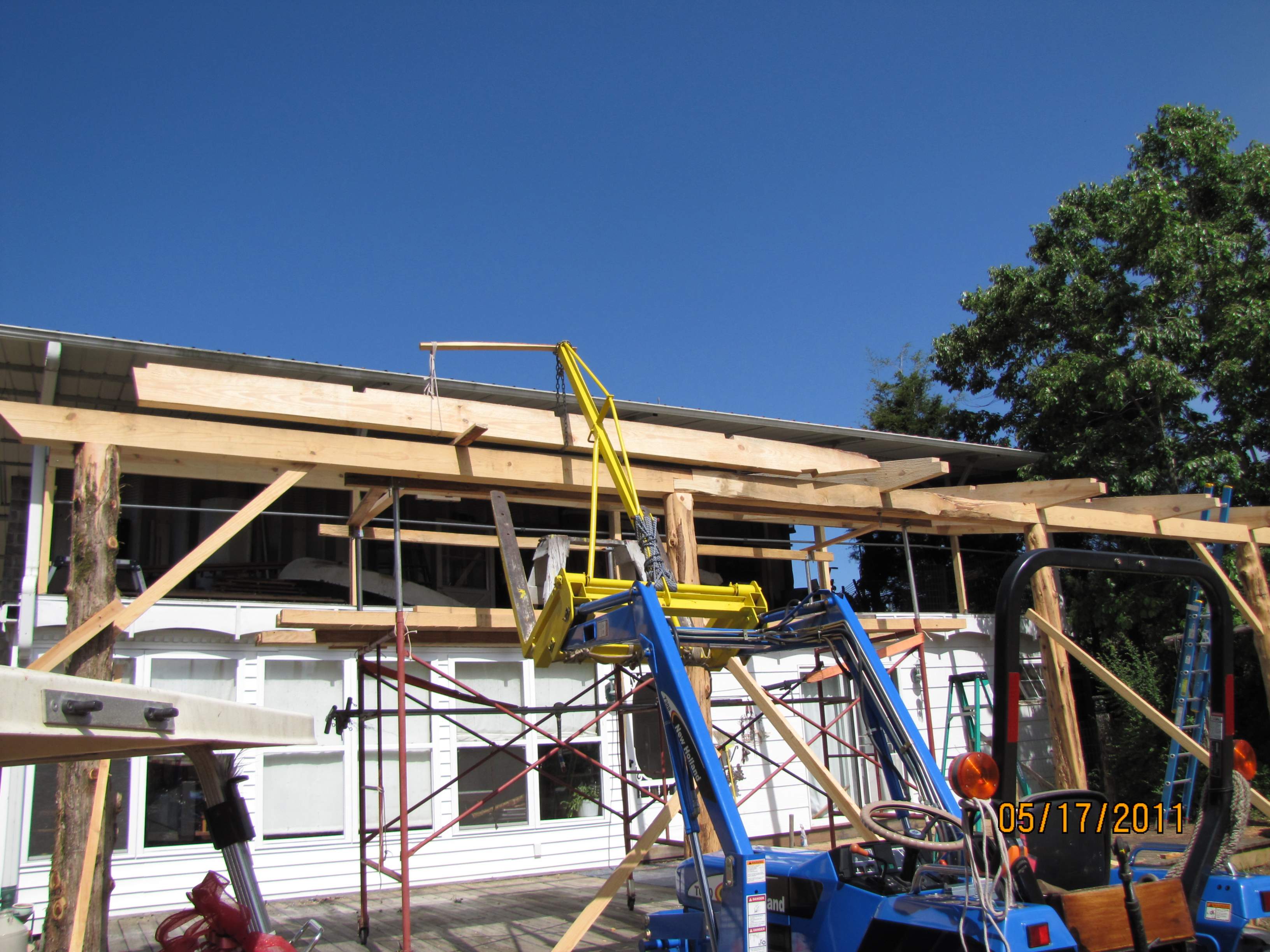

I did it alone using my lifting 3 pt jack boom. lashed to my forks. (bucket would work the same.set everything it worked great.
Army Grunt
