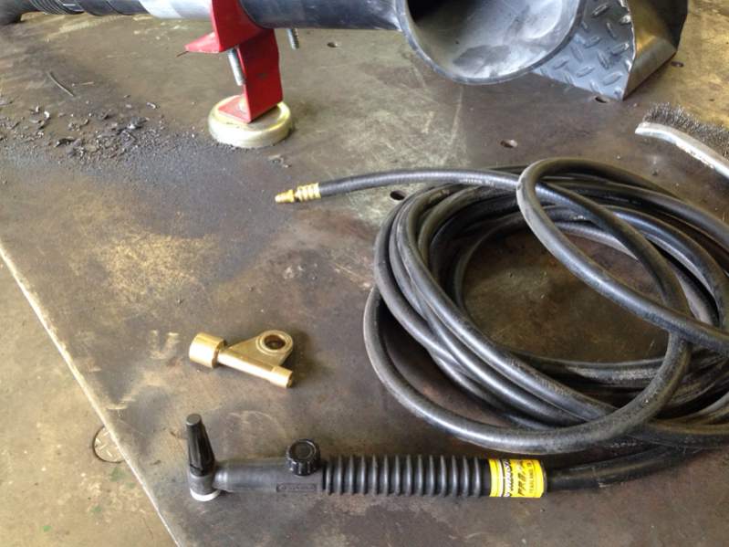

   / Setting up Powcon 200SM to mig weld? #3
^^what Rock knocker said. For scratch start you'd need a bottle of argon, a flow meter, tig torch with valve, a power block and a length of hose suitable for inert gas..
BTW. I saw my first Powcon just recently. An aluminum boat builder owned two and swore by them! Used the old Profax spool guns with them. And this is a guy with with a shop full of newer machines. Terry

   / Setting up Powcon 200SM to mig weld? #5
I's simple to add a tig set up. Just have the guy at the LWS draw it out for you. Easier than you think.. We used to call them
Kapow Cons because they were the very early inverters and had a history of going Kapow!
