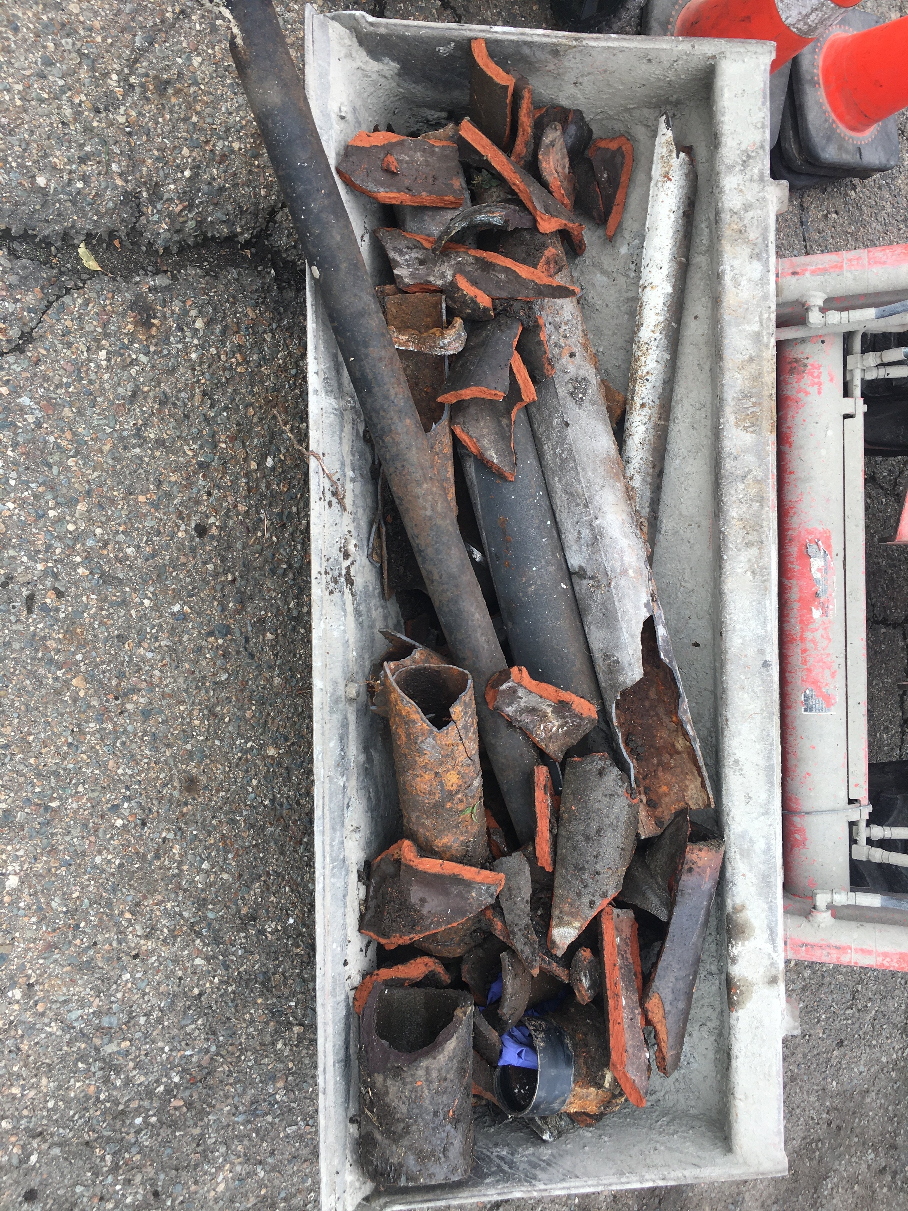

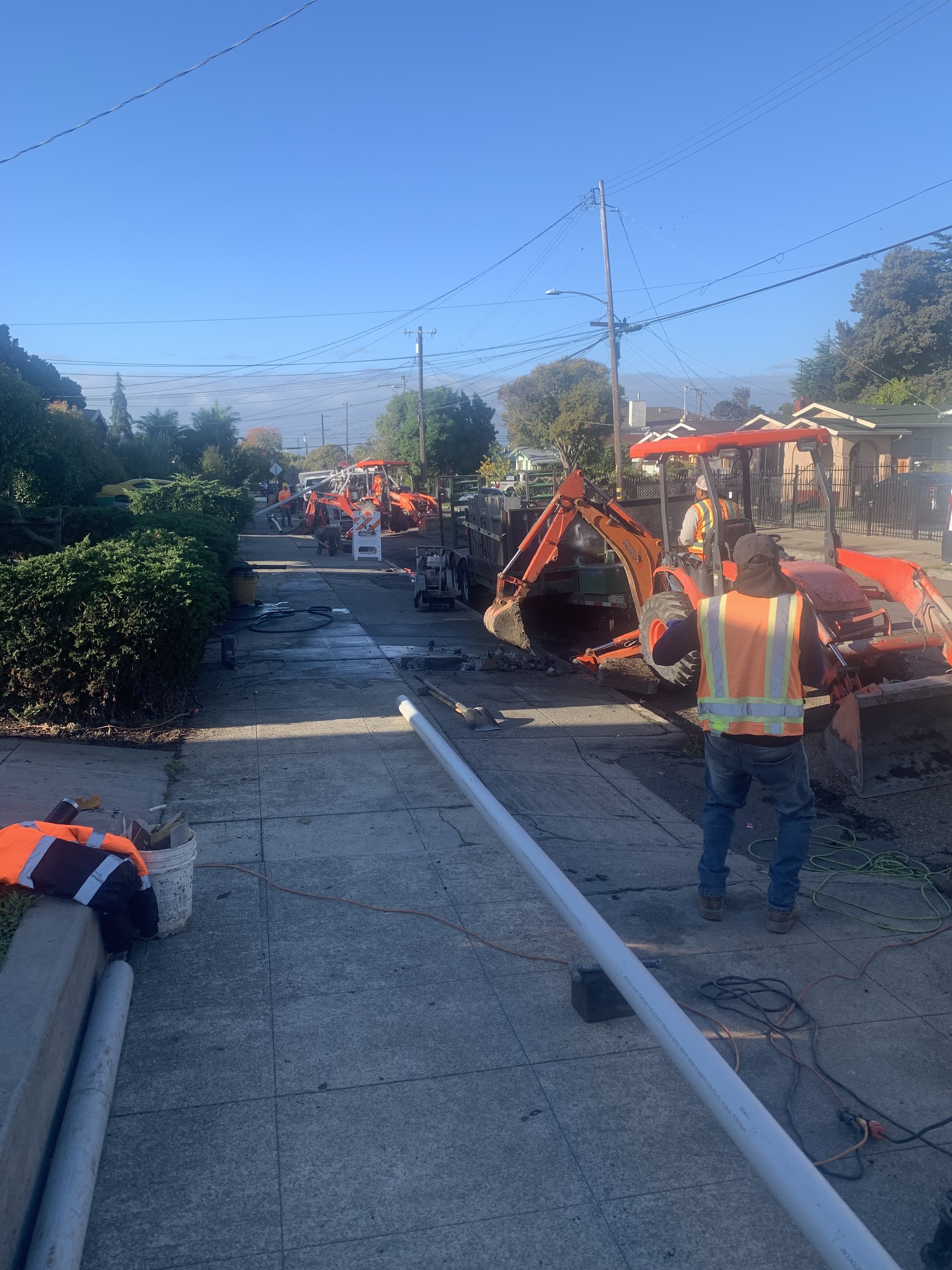

Today having 1922 clay sewer laterals replaced with heat welded 4” plastic…
The clay needed annual root clearing so the idea is to replace and be good for another 100 years.
The contractor uses only Kubota b26 tlb and had two on todays job.

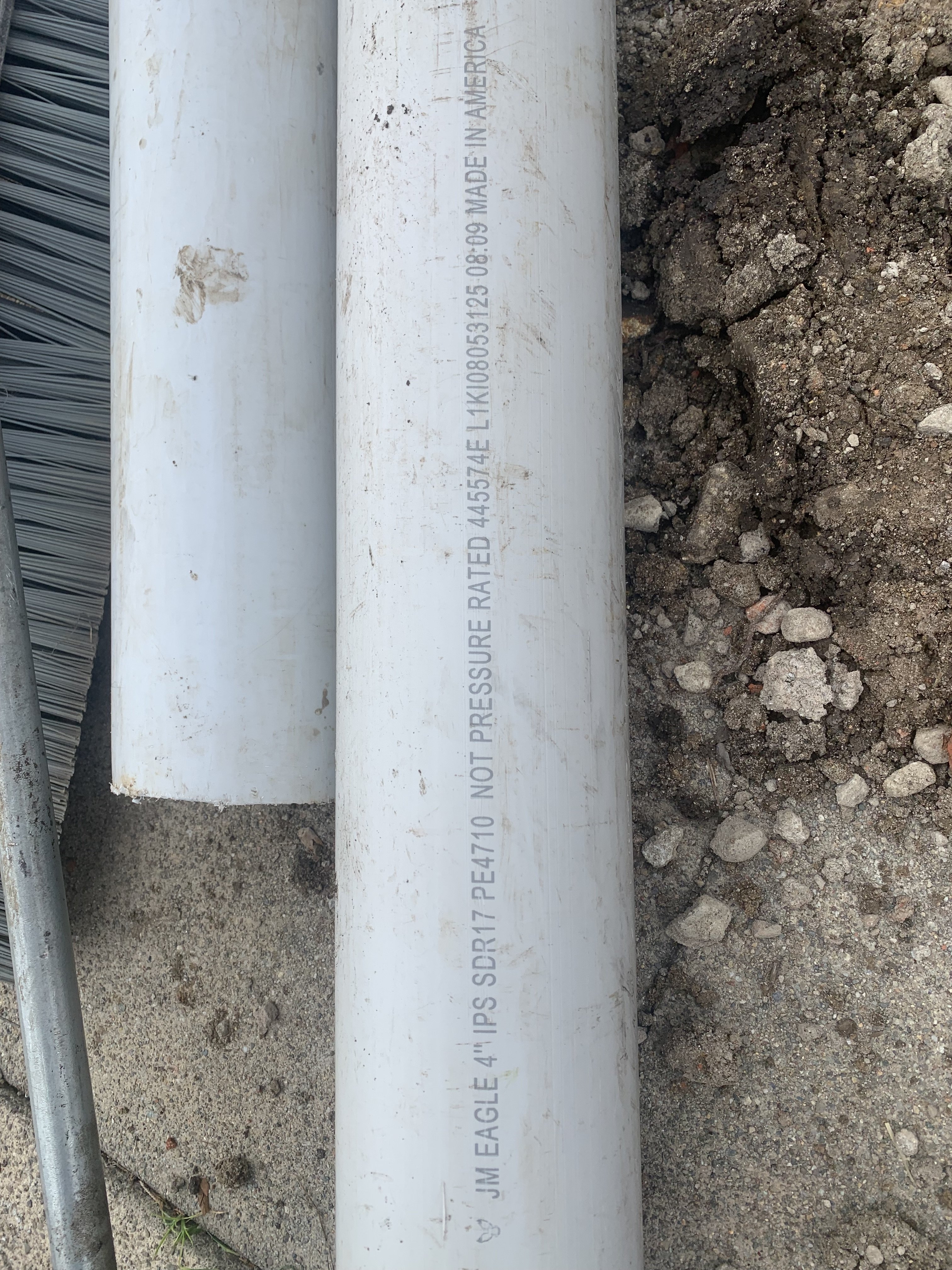

Looks like they are using schedule 40, is that code there? I bet it's some $$$$$$$ to replace.
18k for all 3 including permits.
City permits nearly doubled this year and $2,400 of the 18k is for permits.
It would have been nearly double if street excavation required.
I’m piggy backing on the sewer main the district replaced as they ran a clean out to curb… so it could be worse.
Also getting together to do 3 at one time gave a little price break.

If it had been to a center of the road manhole, I would have suggest pipe bursting. But no need since it had the curb clean out. $2400 for "maintenance of existing" is highway robbery, but if it makes it feel better, you would be hard pressed to do 3 septic tanks for that price
/ Sewer Lateral Replacement
Still did pipe bursting from curb under sidewalk and driveways… the old clay just gave way as the new pipe pulled.

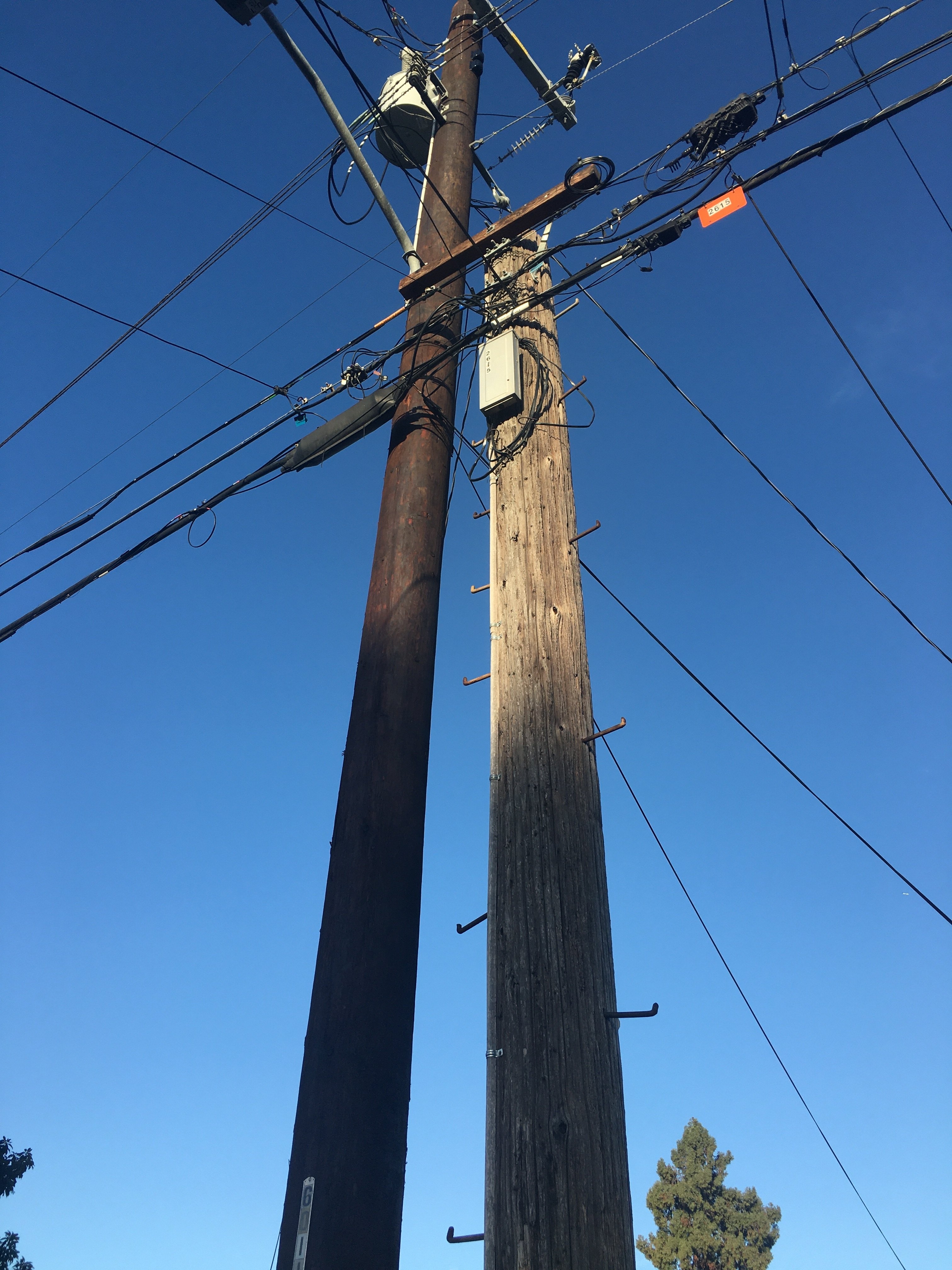

Everything here dates from 1922 including the utility poles…
The utility started upgrading because these 3 bedroom homes were set up with 30 amp 120v mains and that doesn’t work with the all electric house and car vision
