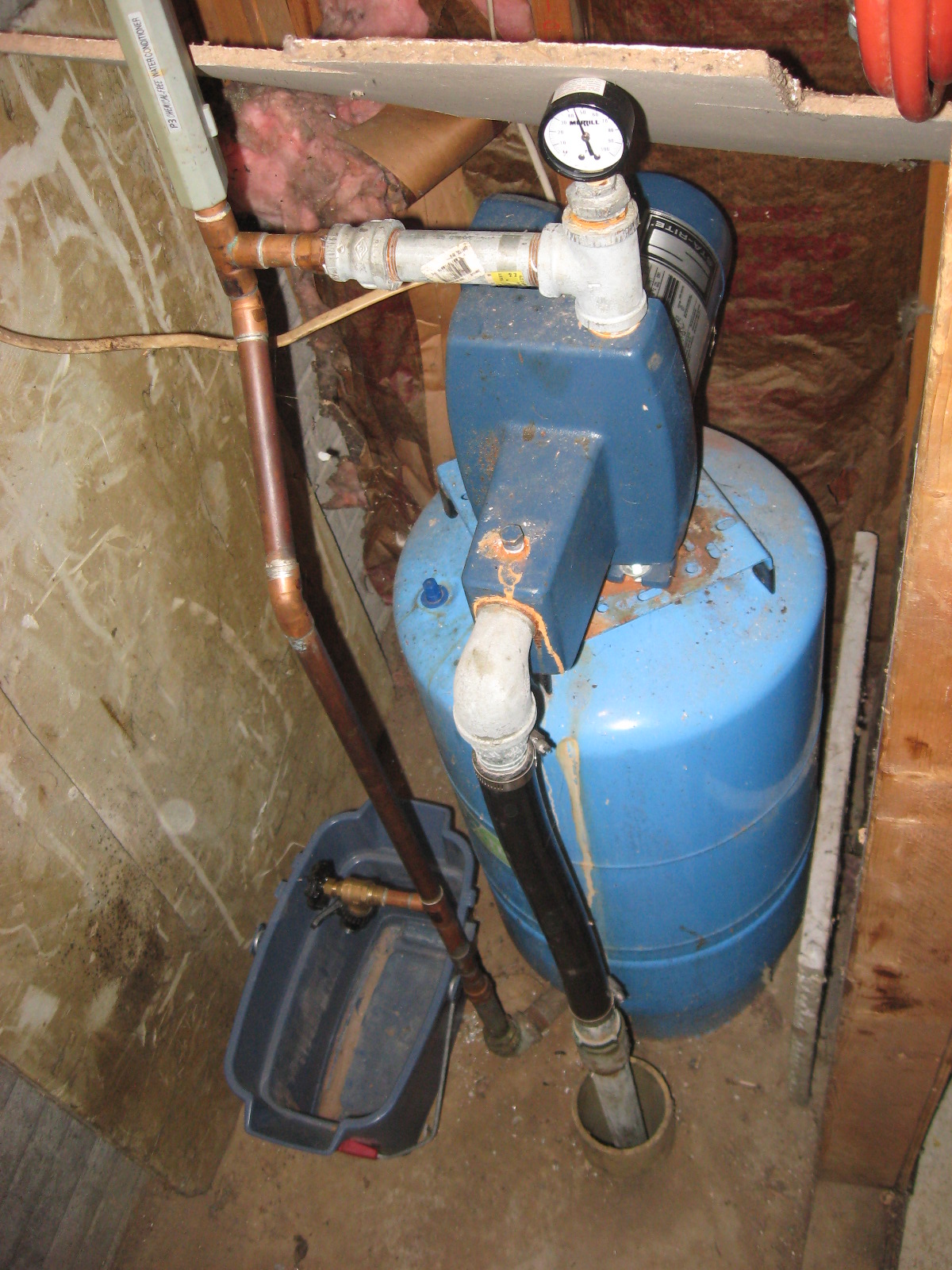

I doubt that my static level ever falls very low, that my well (-pipe) is more than 15' deep, or that it is anything but a cavity for a point/ft-valve that's fed entirely from the stone pit (16'x18'), so apples to oranges I guess. I'd say my static level has never been less than 5' or more than 10' below the pump itself in my 15 yrs here and with the 3rd pump. Horizontal distance 'point to pump' is ~26'.
My flow problem has never been more than asking a single stage pump to do too much. (Of course I get great flow/pressure from the tank until it empties) I've never drawn air or sand into a pump or the filter/housing that I know of.
Dutch, I wish there was more info here that'd help you, but we just seem to have very different water sources and circumstances. Now I feel guilty thinking that I'm the one who 'might-could' use a submersible in a shallow well and perhaps not overdraw it.
btw, What I called a 'cap' is actually a plug with a 4 1/2" dia thread. I'm going to work on getting that off ... (we'll see what that takes :laughing:) and get a camera down there if I can't see(/pull) enough right away.

Since I'm not getting the flow I'd hoped for from < a dozen ft of suction head I'm drawn to suspect something throttling-back my flow below ground, like a clogged/corroded pickup screen. Nothing is interfering with the foot valve, and it works ok. I still don't seem to be cavitating or drawing air, as released from the button on the filter housing every other day or so and with only a few cc from each burp with either pump in place.
'Worst case scenarios' include sinking a new pipe (~15' max to clay base layer) and/or digging for an outlet from the cistern that I can tap into for a 'sub'. First, I have to see what part(s) of the original setup can be used. I haven't ruled out creating a replacement for the cistern, sort of a septic-in-reverse w/lines laid out along shore several yards back from the waterline and up to 100' long with a concrete distrib box or poly ejector crock for a sump. (they'd have to be pretty tall to house a sub)
MY 'sub' of choice so far is Grundfos 3" 5SQ05-90. Its way of performing on par with 4" pumps is to use a 10k rpm motor, and I can easily go two-wire w/g with the 230v model and no controller needed. 'SQ/SQE' is said not to require a cooling shroud below 30C/86F and only fractional GPM for continuous running. That said, I could still shroud to lower intake if the pump is tall for my well or its tie-in from a cistern. Carbide over ceramic thrust bearings per stage is supposed to minimize thrust wear with its floating stages.
I'm cleaning and re-applying 50/50 ATF & acetone to the 4 1/4" pipe's top thread every few hrs to uncap it. (working better than Kroil or PBlaster, btw) Depending on what's in there I'll know what options I have.

OK, the plug is out and I don't know what I'm looking at just yet.
I lowered a bob from the top. It went 36' down and clunked on a wet-looking bottom, then came up dry. Note that the top of the pipe is atop a steep ~4' slope and no more than a foot higher than the pump. Of my half-dozen bore/inspection cams none will reach more that 15' so I can only guess that it's drilled well into the clay, but not drawing water. The hard bottom is far below the nearby/static water level on shore <50' away, to a depth beyond a S-W pump's ability to draw. (35' below the pump!)
I don't get why the metal pipe is isn't filled with water, or why it's even there. I suppose it could be from a failed attempt to drill, but IMO there's a lot of weird to guessing why it's all metal, fully cased, so deep, and hard/'dry' at the bottom. It seems to have nothing at all to do with my well or water supply. :confused3:
I do have room to dig into or around the stone pit, but with 16 sq of siding to put up (by myself) It'll have to wait for Spring. At least I'm doing my 'bucks-worth' better since upgrading the pump. :) t o g

DB, the oddity with the pipe is that it terminates so far below static level and I have no idea how a S-W pump could draw from so far down. In that area (50' from the beach) I can find groundwater easily with the Terramite or with the Earthquake PHD and no extension on the auger. There's 15-20 ac/ft of water minimum in this former sand pit, according to seasonal level. I've live within 1/2 mi of here since '89, 15 yrs here, and can guess from familiarity and by pond level whose sump pumps nearby are running at any time of year.
The bob I dropped (to 35' lower than my pump height) went easily to the bottom, hit something solid, and came up dry. Perhaps a pitless adapter is what's there, but that's 25' below static level anywhere near here. According to county records on a well drilled up front in '95 there's a dense clay layer not far down and 50' - 60' thick. It starts <10' below my lower lawn, the top of the stone pit, the patio and basement floor, and obvious on the pond's bottom where there are sidewalk-like exposures of clay that nothing ever grows on. (avg depth <6' was limited by digging ~to clay eveywhere)
So, if there's a PA that far down w/sump below it was bored well into the clay and if also connected to the pit or whatever its point is fed from that's at nearly one atm higher than my static level. IMO, that's like 'ersatz-artesian' and explains why I never draw much air or lose prime, but that a S-W pump works at all. It could literally 'pressurize' a point that far down and I'm back to drawing 'net' from much closer to static level after all. :scratchchin:
As to drawing down excessively, I can come home from a week away and jump in the shower or wash the car to see water pressure flag just as the pump comes on, it recovers flow/pressure no more noticeably quickly than when doing a second consecutive load of laundry or amid a vehicle washdown. Total flow/refill is never very high/fast but is always consistent regardless of use.
I'm working on getting a camera to the bottom of the pipe. If there's a PA there then what I described above seems to make some sense. It also means that there likely won't be much tinkering with what's there, being ok for now, and being willing to drill anew to the aquifer below the clay layer. That would put a submersible easily 60' below my static, as is the norm locally and it appears to bottom-fill from a typically 170'-190' bore.
