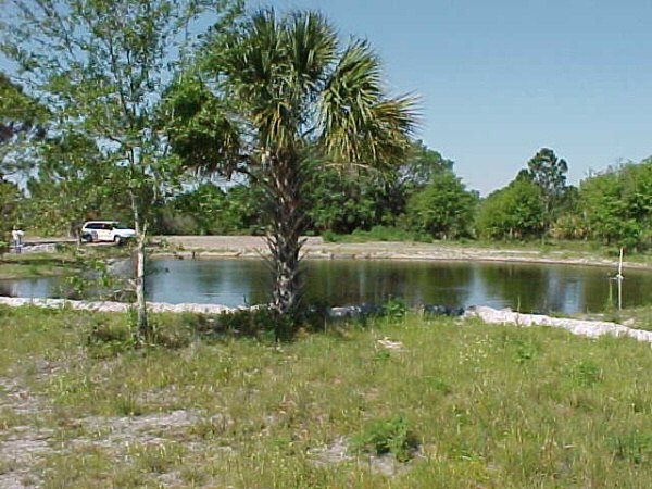

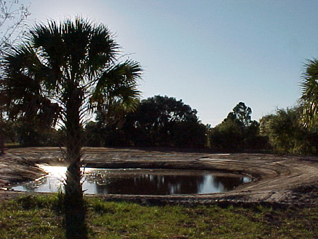

The only thing I can relate is the experience I've had, and let you extrapolate the differences.
Florida land is sand. Our ponds are dug and fill from the bottom, depending on the height of the water table. After a good rain, our pond is nearly full -- within 12" of the surrounding land. When we go through a dry spell, the water table, and thus the level of the pond, drops as much as 6'.
My pond is small, about 110' x 115' x 6' average depth (at a guess). Attached is a picture shortly after we had it dug. This is the typical water table level when it has been relatively dry.
   / Shallow Well to Feed Pond #13
I wanted to maintain it at a much higher level regardless of where the water table is. I talked to my well guy, and he recommended a 6" well with a 1 HP submersible pump. The pump will supply a steady 25 gallons/minute. Our well came it with a capability of about 75 gallons/minute, so if I need to once the house and barn are built, I can go to a higher HP pump.
I ran a 1-1/2" PVC line from the well to the pond (about 400' or so) and installed a Hudson float valve Hudon float valve to automatically maintain the level. Attached is a picture of the pond after the valve was installed.
The initial fill took 3 days (72 hours) of constant running at the full flow of the valve (something less than 25 gallons/minute) to bring it up to this level. Since then, the well runs a couple of hours per day to maintain the level versus the seepage through the sandy soil. The system works very nicely.
However, currently I have it turned off, because we're not living there yet, and it seems like a waste to maintain the level when no one can see it. I did keep it on for several months to try to determine the cost; it looks as if it will run about $30/month to maintain the water level year round. We're planning on a 1/2 HP fountain in the pond, and estimate that will run another $30/month.
