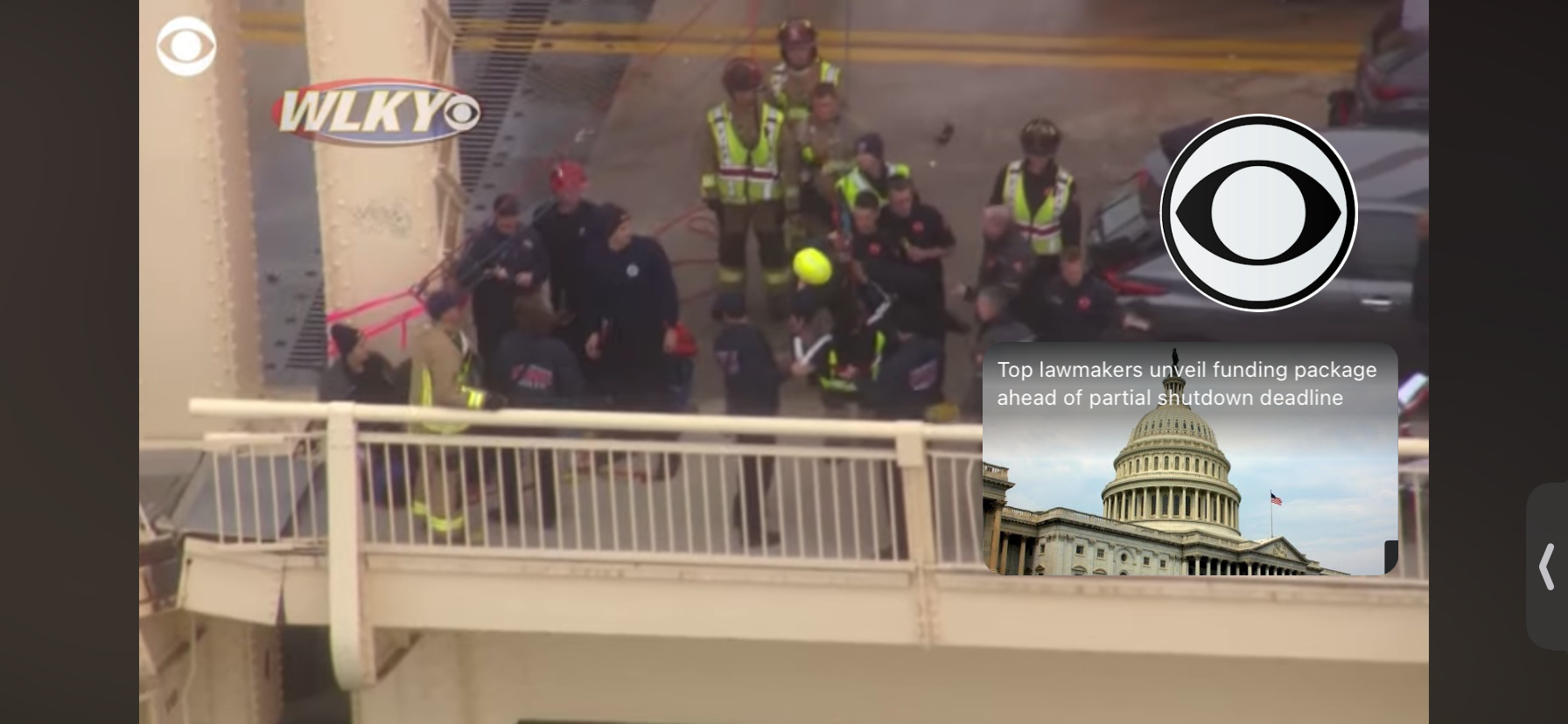

Rockbadchild--a question on rigging. Thanks for your explanation; I have no experience in rigging for live evacuations.
In a different video taken from the bridge deck it appeared that a "fall" line ran from somewhere (fixed?) on the bridge deck to a block (A) at the tip of the right rail of the ladder, then down to a movable block (B) from which the rescuer (and victim) was suspended, then up to a block (C) at the tip of the left rail of the ladder. and thence back to the bridge deck. I assumed this was done to equalize the strain on the falls as there likely is some concern that uneven strain might twist the ladder making retraction of the ladder problematic. It would also give an additional 2:1 advantage and reduce the strain on each part by half. Presumably there is a fast acting brake on movable block B should the fall line fail. As the rescuers haul on one line in bcp's video one can see the two "fall" lines move apart from the camera's perspective.
no, I understand its hard to see from the video(s) but it’s two separate line and units …see picture attach you see the two anchor point (pink straps). If one continuous rope is used from the one anchor down to the rescuers back up to the anchor that would mean both person are hanging from one rope without backup if that rope get cut for any reason any where between the anchor and the guys pulling both person fall …as a rescuer no one put the his own life and the life of someone without backup (safe line) and you can see two team pulling on two ropes. Go back to see post 19994 and the attached picture it’s a bit different then their set up because they work with a redirect and not overhead like the picture then check the video again and you see them sliding the prusik knot on the lines that along with a pulley gives them the 3:1 mechanical advantage. They could’ve used 5:1 but no one does that unless you only have one guy to pull. Then read again 19997 i explain how each person is tied on both ropes. There is an interview of the firefighters rescuer and he talks about his rope rescue training if they would’ve done it the way you described it, it would’ve be without training or qualification. Our trainer goes to the USA to get trained likely the same facility as their trainer.
this is a drone footage it’s hard to see but I can tell it was done the way I am describing it because that’s the way I am trained and because I know how it looks and what to look for.

Thank you, Rockbadchild. Your explanations and the drone video make it a lot clearer.
