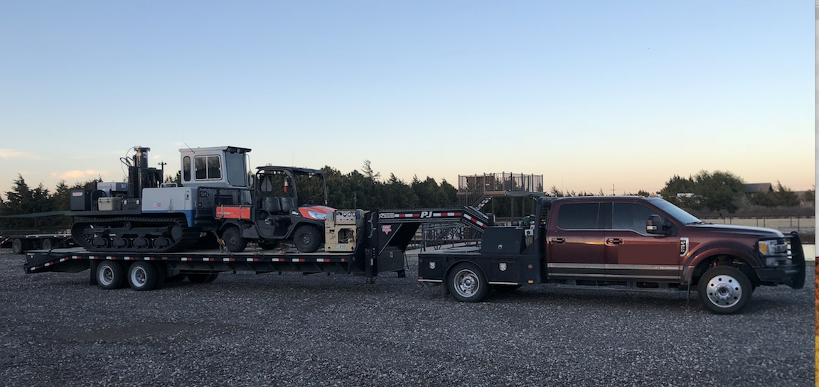

I'm intrigued, what were you hauling?
It is an IHI IC-45 rubber tracked crawler, a kubota 900x RTV, and a 10k watt diesel generator.
It is behind a F-450.

I would guess you were good on the truck axles but over on the trailer unless that is a pretty big dog trailer. On my 3500 dually Ram, if I max out my steer axle and rear axle and the pair of 12k axles on the trailer I am still just shy of 40k. Rarely do I haul over 32k gross combined, but I am tagged for 40k just in case I do that math wrong and get a little heavier than expected. We are running hydraulic disc brakes on the trailer and that makes for smooth stops.

The trailer has two 15k axles and electric over hydraulic brakes. Normally I haul this kid with my peterbilt and 53’ trailer but the jobsite we are heading to tomorrow is tight and I am not sure I could maneuver the semi in there.

That's a real-deal trailer for sure. Sounds like you were legal.

Care to share pictures of the rig? Jon

Pictures!!
   / Share Pics of People Hauling or Towing Something Wrong #7,459
Sorry for the delay. Today I hauled the load about 200 miles to our job site. It handled it no problems. Cruise set on 70 most of the way. Once on the job site I had to go through some rough terrain to get where I was going which required 4WD. I unloaded the crawler before attempting it and had the crawler out front in case I needed a tow. Attached is a picture of the load.
