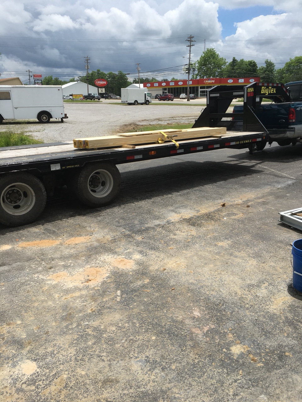

That would have gotten you an improperly or unsecured load ticket here. Anything that is not up against a bulkhead or other load restraint must have two straps, at least here in WA. Learned that one from experience.
It’s only a mile trip. I thought about being eligible for the thread and going strapless. With the 1 strap it’s not going anywhere. Usually I’d use my smaller trailer or just use my dump truck but over the course of the 3 overkill towing pictures I’ve posted I’ve hauled the tractor, the CTL, and my box truck. The dump truck has been parked with a load of sand in it for the rock guys. I’d rather pull my light trailer for light loads, but dropping trailers sucks worse.

I got another super heavy load for the 10 ton GN. I figured 1 strap would work this time View attachment 555729
It's this kind of dangerous scofflaws that are a hazard on the road! You should be ashamed at hauling that overloaded trailer! Think of the children!
:D
I thought is was one every 10ft, minimum of 2, with a 3rd for 11'-20'?
edit: Nevermind. You are correct, as per below:
Minimum Number of Tiedowns
The cargo securement system used to restrain articles against movement must meet requirements concerning the minimum number of tiedowns. This requirement is in addition to complying with rules concerning the minimum working load limit. When an article of cargo is not blocked or positioned to prevent movement in the forward direction, the number of tiedowns needed depends on the length and weight of the articles. There must be - one tiedown for articles 5 ft or less in length, and 1,100 lbs or less in weight; two tiedowns if the article is -
5 ft or less in length and more than 1,100 lbs in weight; or
greater than 5 ft but less than 10 ft, regardless of weight.
In the following example, one tiedown is required because the article of cargo is 5 ft in length and does not exceed 1,100 lbs. If the article of cargo were greater than 5 ft in length but less than 10 ft, two tiedowns would be needed regardless of the weight. When an article of cargo is not blocked or positioned to prevent movement in the forward direction, and the item is longer than 10 ft in length, then it must be secured by two tiedowns for the first 10 ft of length, and one additional tiedown for every 10 ft of length, or fraction thereof, beyond the first 10 ft. An example of this is provided below. If an article is blocked, braced or immobilized to prevent movement in the forward direction by a headerboard, bulkhead, other articles that are adequately secured, or other appropriate means, it must be secured by at least one tiedown for every 10 ft of article length, or fraction thereof.
Cargo Securement Rules | Federal Motor Carrier Safety Administration

Alway nice to see the tie down straps wraped around the rub rails on the side of the trailor then hooked. They stay hooked up that way even if the strap gets some slack.
Drives me nuts when I see straps dropped over the edged then hooked up. A little slack or load shifting and the straps are unhooked and useless.
Congrats on the nice trailor and I agree with the swapping out trailor issue being a pain.
