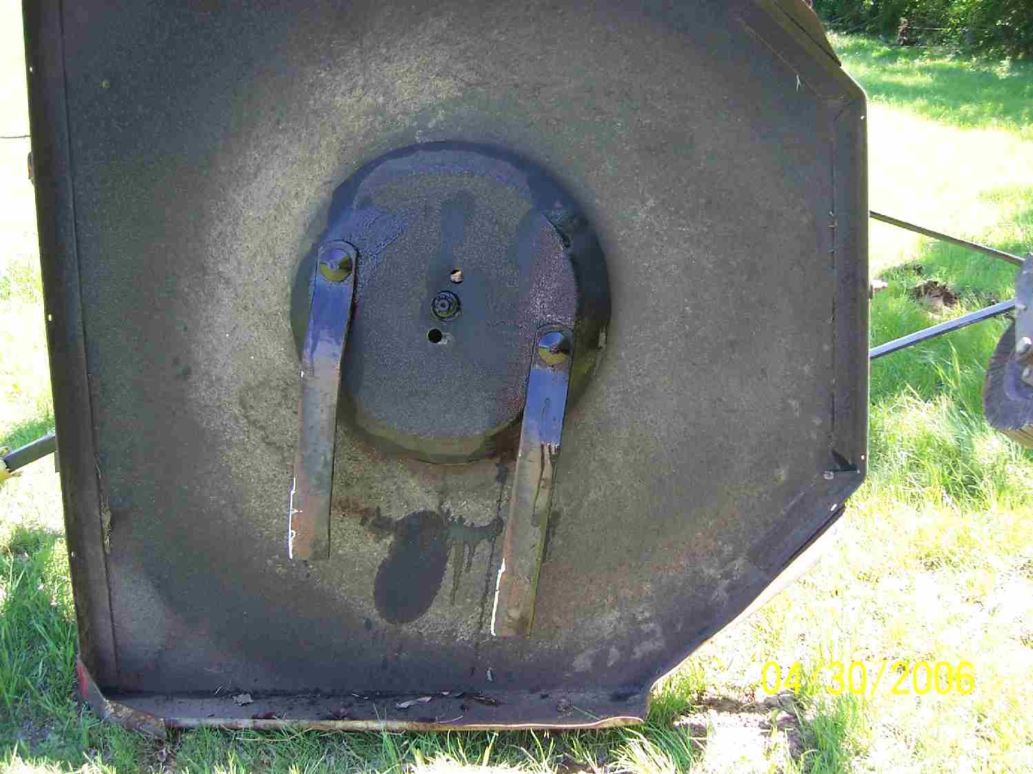

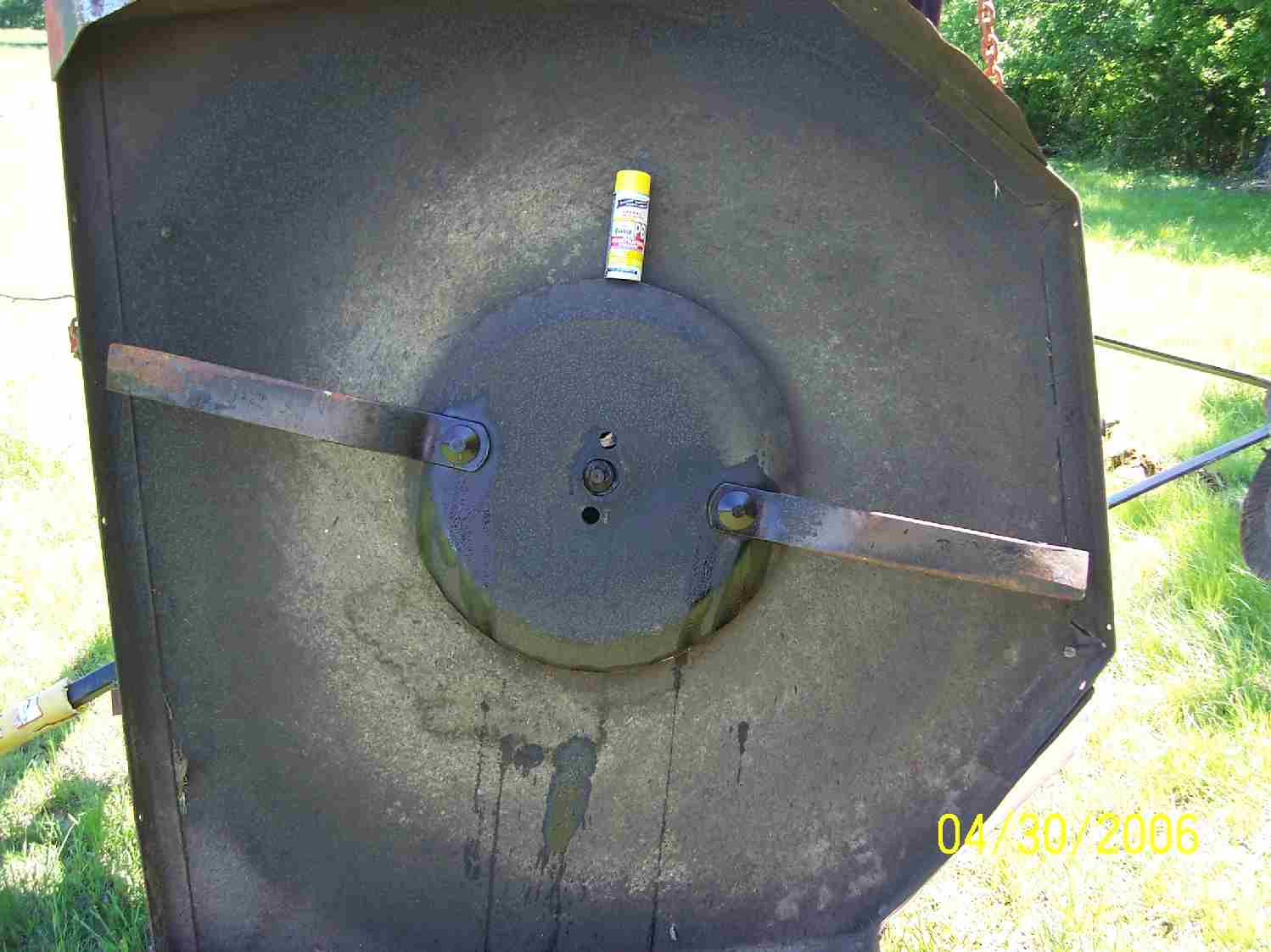

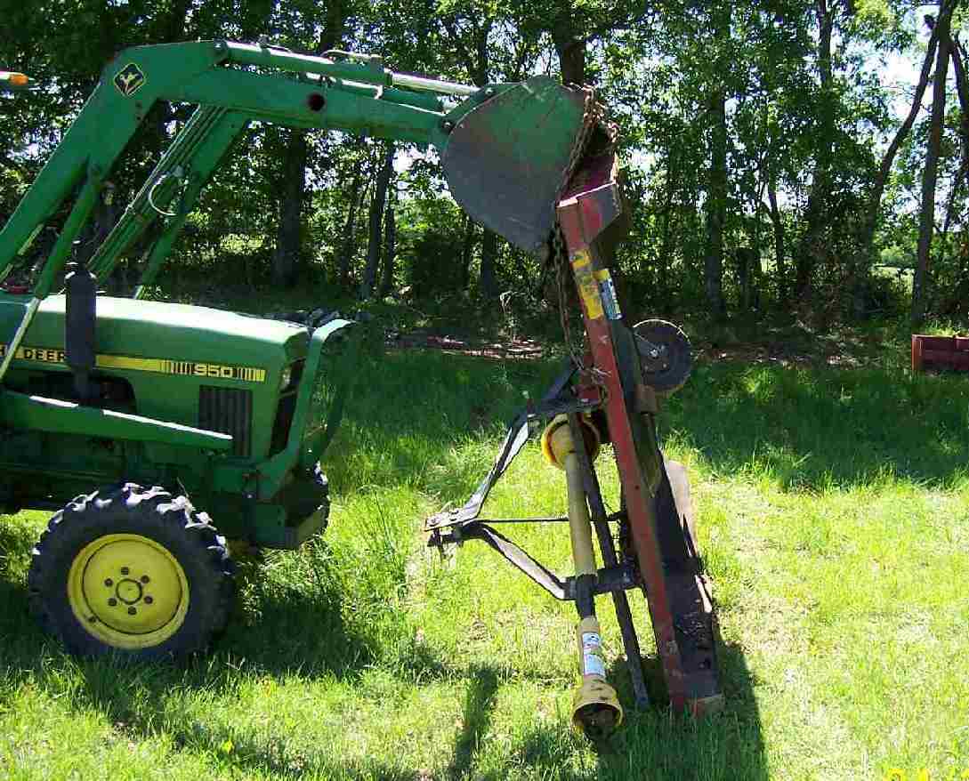

Ken - If you have an FEL, use a chain and tilt the cutter up on its side so you can easily get to the full length of the blades. Make sure it tilts back and leans against the FEL with the chain tight for safety. Mine is a 6' Howse and I also use an angle grinder. Also makes it easy to inspect the underside and free up the blades if they are stuck. See pictures.

/ Sharpen Brush Hog #6
BB_TX,
Great idea. I have a new L39 on the way and can't wait to use the FEL to do the same. Been tryin' to figure out how to sharpen the BH for a while now but I have asways come to the conclusion that it's either to dangerous or too much work for the gain I'd have.
