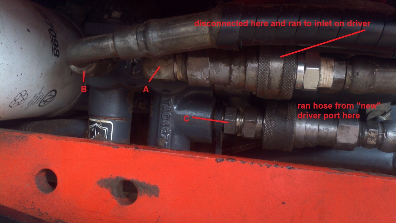

You do not necessarily need power beyond sleeve in this port of the driver valve to have both driver and 3 pt function. With the flat open center plug installed flow from the tractor valve "A" port (when lever in detent) will go through the driver valve and directly back to tank either through the open center circuit when not driving a post or the driver piston return circuit when pounding. To regain 3 pt function, put tractor valve back to neutral. When the tractor valve is in detent it sending oil directly to tank, by-passing the 3 pt down stream from the tractor valve.
Option 2 - have 3 pt function while tractor valve is in detent: Install the power beyond in this plug and run another hose back to "B" port of tractor valve. Typically valve work ports are marked A & B to one valve spool, C & D for the next spool, E & F for the third, etc. This will allow 3 pt function unless you are driving a post at the time. The driver needs that large direct to tank return to dump the oil out of the driver cylinder fast without restriction to obtain speed and force.

SSdoxie, You said,
[ When the tractor valve is in detent, it is sending oil directly to tank, by-passing the 3 pt down stream from the tractor valve. ]
When the remote valve is in detent, the flow is going to the pounder, and in wfd2's pounder, the return should go to tank.
Don't know how sparkslinger is feeding his pounder.
   / Shaver HD10 not lifting pounder head #73
SSdoxie, You said,
That was based on picture he posted yesterday. It shows taking oil from what he called A port, but when he tried running the extra hose back ran to "C" while the hose he has marked "B" looks like the other work por tfor that valve spool.

Detent? Just when I thought I was starting to understand power beyond, open center and closed center, I have to learn something new all together. Are you sure this isn't a test or something? Someone please enlighten me. I may have to go back to drilling holes and mixing soup again. I'M probably really going to be sorry I made this post, but hey, gotta learn some way.
Wfd2, My local hydro shop isn't having any luck finding me a PB sleeve. Is one perhaps included in your open center kit? Hopefully I will figure out what JJ & SSdoxie are trying to help me understand and I won't need it. HINT HINT

Just cut off the CC plug and re-use as open center plug, and run your return hose to tank.
If you need 3pt, you could put a simple valve in the circuit and switch when you want either.

Explain what what you are doing with float, as there is no pressure in float, and float is usually on the FEL valve.
What is your fluid path from pump to tank if you don't mind?
   / Shaver HD10 not lifting pounder head #80
I usually don't do anything with float except clear snow. I thought when you said "your loader probably has a detent in float" you meant my three point might work with my current configuration if I put my FEL in float. I'm not sure what my fluid path is. There is a pressure line from the pump going to the front hydro block and there are seven other lines attached to that block as well, so I have no idea what the path is from there. This is all very confusing to me........I'm going to take a nap.
