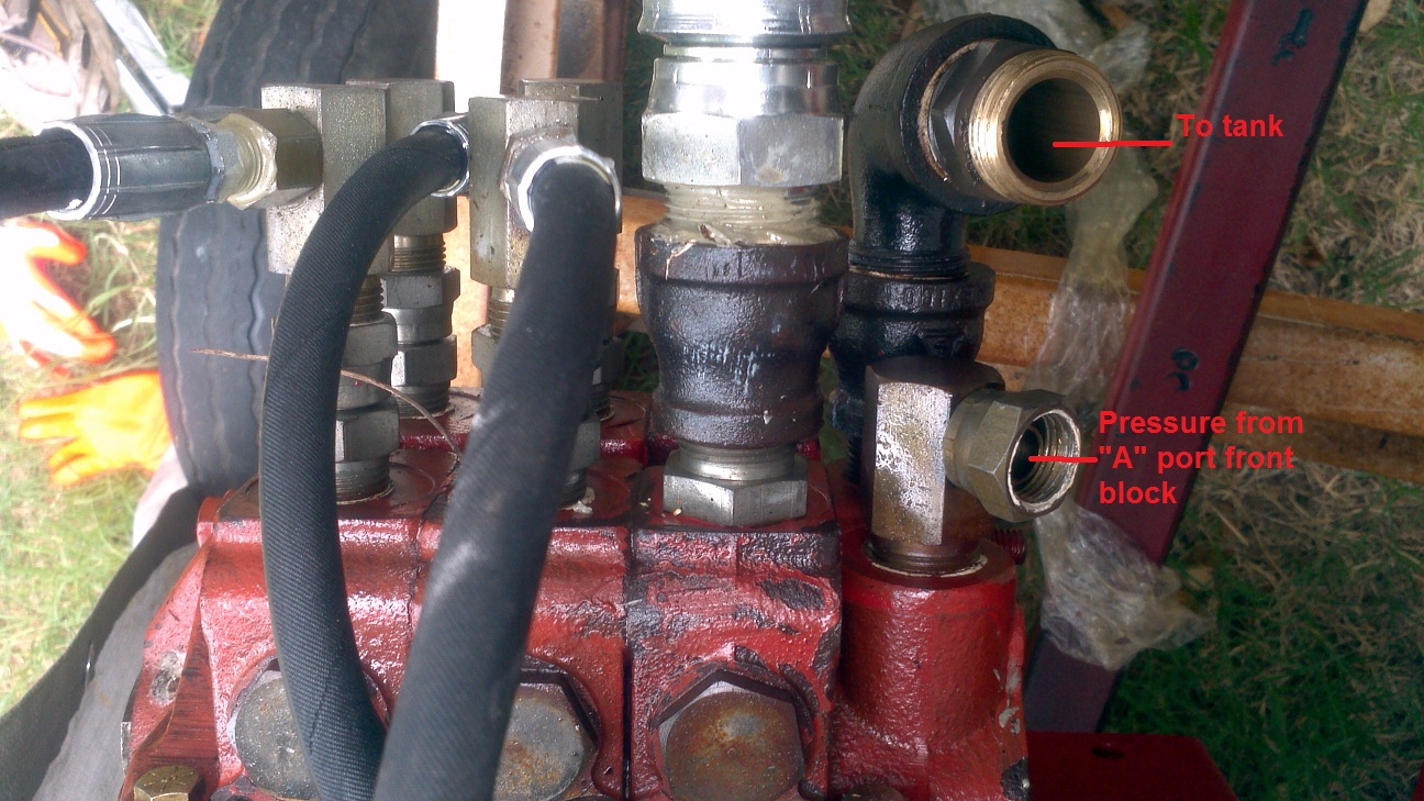

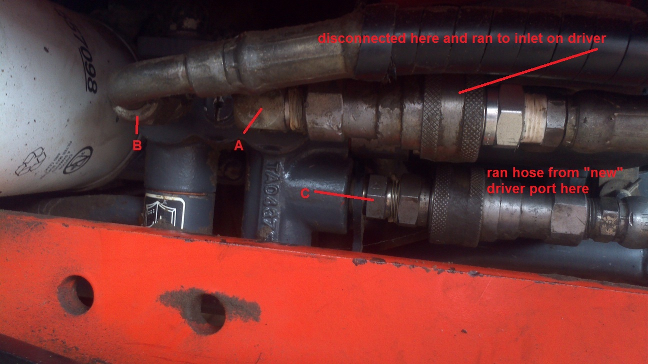

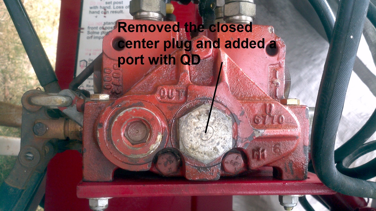

Here is how I did it

That is exactly what I am trying to do but I dont know which hose from the FEL is PB. According to my local hydro shop, when I remove the "closed center plug" from the driver valve and add an adapter with QD the driver valve becomes PB

If you remove the closed center plug, you need to add a PB sleeve to make it PB. Your OUT port would go to tank.
If you just remove the closed center plug, and added a QD, that would make that port another OUT port.
PB is acquired when you separate the OUT /tank port with the main gallery which passes the fluid downstream.

I have this very same valve with a similar problem, previously used on a John Deere. I pulled the shiny plug and discovered it was a closed center plug. Took it to my local hydro shop and they said remove the plug and install an adapter for hose or QD. Disconnect FEL from "A" port on front block and plumb to inlet on driver. Run a hose back to FEL from new port on driver and all should work. I will test this tonight and post results.
Sparkslinger,
Can you take a picture of the Closed Center plug so I can compare to mine? Also, does your local hyd shop have an open center plug for this valve? I'm having problems finding one. Everyone I talk to wants to sell me the entire valve body end, with the open center option, for $198. Seems way to high to me. I just need the plug.
   / Shaver HD10 not lifting pounder head
#60
Picture 3, large shiny hex nut. I believe the other plug with the indented hex, is another OUT port and is plugged because the other port is used, however, I would check out both ports.
You may find a long sleeved plug with two o-rings, or a hex screw, and a short plug.
http://i1119.photobucket.com/albums/k633/wfd2/2011-09-02_17-42-22_618_.jpg
Take pictures of both plugs and the inside of the ports.
