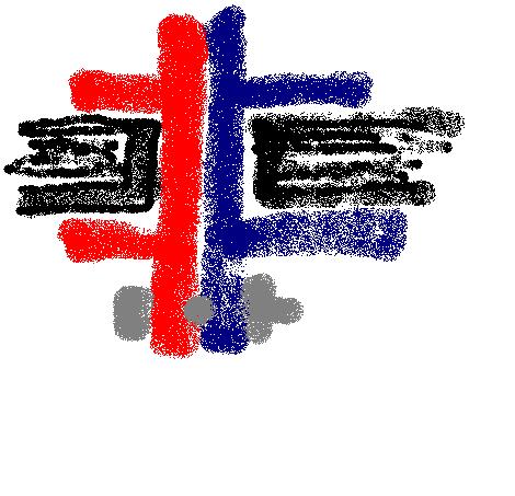

My 2910 has the 8-2 standard gear tranny. I dont recall anything in the manual about feathering but I will look when I get home. I will atempt to show how my shear pin works (Get ready to laugh)
   / shear bolt blues, need advice #25
this is ugly if it even works
Black= 2 splined shafts one on gearbox other is on the attachment end of pto
red is splined collar on gearbox
blue is splined collar on Pto
gray is shear bolt.
gray is shear bolt.
You're right that's an ugly drawing, did you use a crayon?

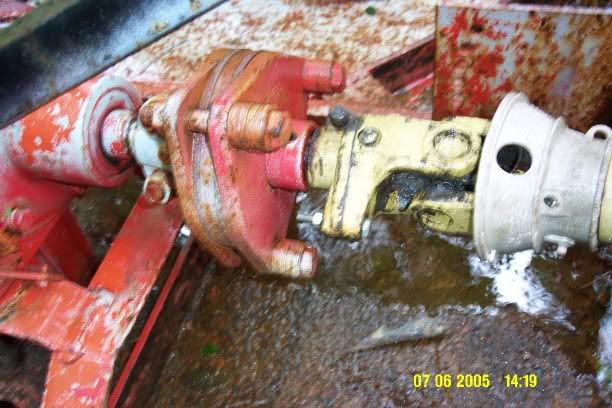

That's exactly what my shear bolt setup is. Let me go brave the rain a get a picture of mine.
gray is shear bolt.
Good enough pic.. I know exactly what you mean.
Check that manual. Do you have the oem blue/white cover NH manual?
