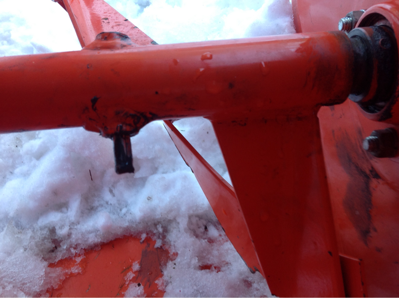

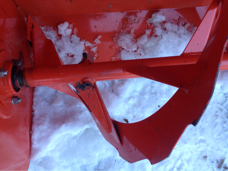

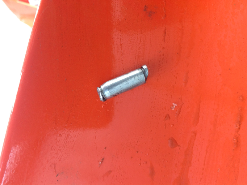

Okay, I have successfully changed the bolt and am operational again. Thanks to all that replied, every answer was helpful even if to just verify that I was already trying the right things. In the end, the bolt was rounded over on the front side so the advice about rotating it 180 degrees was the key. Even. Then. It took a moderate amount of force to drive it out. I did locate a pin punch but I'm not sure if that factored in at all. Here's some pictures cause I know we all love pictures.

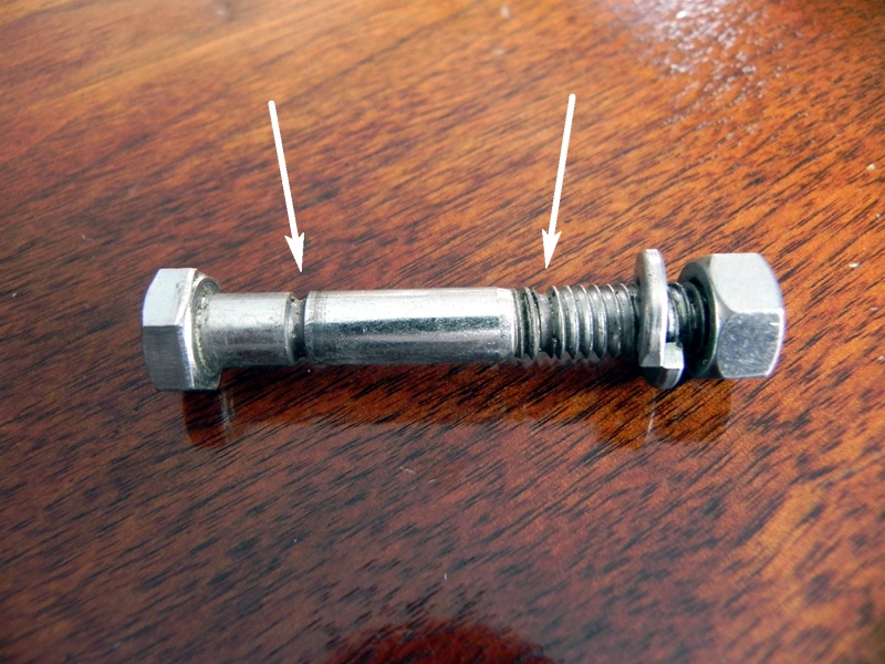

I don't think you understand the situation. The BX2750D snow blower uses special shear bolts which have a reduced diameter at the shear points as seen in this photo. This is a 2750D auger shear bolt.
The reduced diameters prevents a bur from jamming up the shank, in theory anyway. I have sheared 8-10 bolts with mine, auger and fan wheel, and have always been able to easily push the shank out with a nail. I use a nail because I think it's easier to find the old shank "feeling" around with the pointed head as apposed to the flat head of a 3/16" or 1/4" punch. The fan wheel hole cannot be seen without a mirror; it's back inside the shroud, so a good "feel" is necessary to find the hole/shank. So while you would not normally think of a nail as being a better tool in a shear bolt situation, I like it better than a punch in this situation.

If you look at your pictures you can see the drive shaft between the auger sleeve and the flange mounted bearing. What helps me with my blower is a center punch mark on the drive shaft and a corresponding center punch mark on the auger sleeve when a shear bolt is installed and intact. Then when the bolt shears I line up the punch marks and removal (and installation) is easier.
