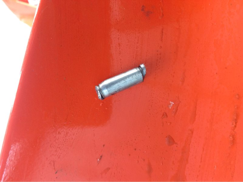

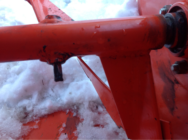

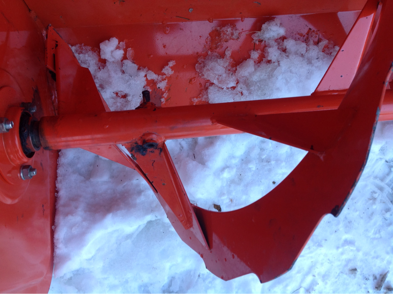

I did manage to snap some shots before we left home in the morning as the tractor is by the front porch and the light comes on. But it was -25C (-41C with wind chill, and -40C = -40F so you know what I'm talking about!) and my hands froze up in the time it took to do it and I had to go in and warm up in between.
You can see the hole by the fan. Sticking a pin in that hole does get a catch, but because of the position of the blade there's no room to manoeuvre. Oddly, sticking a pin in the other side where there is slightly no room gets me no catch. I don't get it.
I'm wondering: if I did pull the C-clip off, how far does the fan come forward? all the way? any chance of poking around the hold behind the fan? looks pretty tight....
Temperature staying the same all week so I lose nothing by being away... BlowerFanHole.jpgBlowerWhole.jpg

On my blower the shear bolt holes are very snug to the point that when aligned I sometimes have to tap a new bolt in. So alignment has to be near perfect to remove the old shank. Twice I have thought that a burr was preventing removal so I got a punch and tried to hammer it out. It turned out that both times was due to misalignment.
If the shear bolt hole and the other shaft hole are somewhat aligned when you "get a catch" I would align them and try tapping on the pin while moving the fan ever so slightly around. I think if you get it aligned the old shank will come easily if the bolt is OEM.
I agree with your assessment that the fan hub should come outside of the shroud area. It would make changing bolts a piece of cake.
Maybe you can peek in the hole using an inspection mirror.

This is what I have done on a half dozen occasions; Move the augers so there is maximum clearance directly in front of the fan. Expand and slide the C clip back so that it is close to, but not touching the gearbox. Rotate the fan so that the blades will clear the housing. It will not pull forward in just any position. Use a bit of penetrating oil and work the fan back and forth until the shaft hole is fully clear of the fan. The remains of the sheared pin should drop out. Return the fan to its proper position, if the holes do not align, use a pin punch from one side to help align them. Insert new shear pin, it may help to put a slight a taper on the end of the new pin. Tap the new shear pin into place. Replace C clip.
I believe the problem is caused by the fan bushing which is not seating properly and causing forward tension on the fan. This summer I will be investigating and repairing.

I did manage to snap some shots before we left home in the morning as the tractor is by the front porch and the light comes on. But it was -25C (-41C with wind chill, and -40C = -40F so you know what I'm talking about!) and my hands froze up in the time it took to do it and I had to go in and warm up in between. You can see the hole by the fan. Sticking a pin in that hole does get a catch, but because of the position of the blade there's no room to manoeuvre. Oddly, sticking a pin in the other side where there is slightly no room gets me no catch. I don't get it. I'm wondering: if I did pull the C-clip off, how far does the fan come forward? all the way? any chance of poking around the hold behind the fan? looks pretty tight.... Temperature staying the same all week so I lose nothing by being away...<img src="http://www.tractorbynet.com/forums/files/kubota-owning-operating/412265-shear-bolt-madness-blowerfanhole-jpg"/><img src="http://www.tractorbynet.com/forums/files/kubota-owning-operating/412266-shear-bolt-madness-blowerwhole-jpg"/>
You are probably already aware of this but you can clearly see that the blower fan is not lined up with the shear bolt hole in your first picture. I would rotate the augers until the unused hole in the fan shaft is closer to twelve o'clock and then try lining the fan up to it again. Might help to get all the snow out as well.
