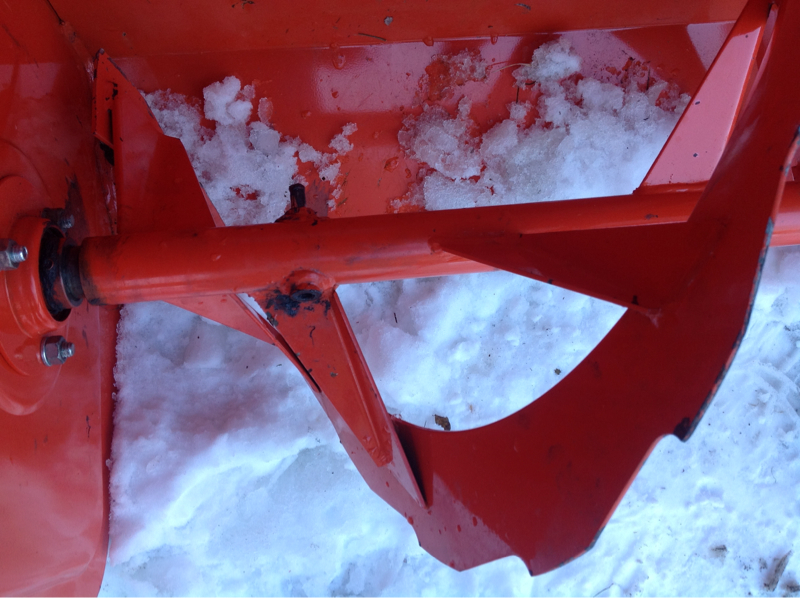

The keyword is 'most'! This morning, with a deck screw (i.e. pointed thing) I was able to locate the bolt, it is exactly where I thought. I could feel around the edges and the bump in the middle. Pounding at it did me no good.
BUT I now managed to get the fan out the rest of the way!! It was jamming on the burr. (See photos, from the left, then zoomed in so you can see the fan out, then two shots of the sheared pin.
So, the procedure has been (leaving out failed things): 1) move retaining pin from ahead of fan out of the way 2) sand off the paint so the fan can come forward (sandpaper actually worked better than power tool) 3) push, pull rotate, repeat, many times until the fan comes forward.
Now, to work on the pin....! BlowerBoltZoomIn.JPGBlowerBoltZoomOut.JPGBlowerZoomIn.jpgBlowerZoomOut.JPG

Even with the pin visible, and banging on it directly with the punch, it won't budge.
So I decided that I'd try the other side. But that means rotating the shaft; which means moving the fan back. Move the fan back, rotate the shaft, discover this cannot be done because the augers are in the way of the fan moving forward. Put it back, try to get the fan out, gets stuck again. Finally get it out, now sand the shaft behind the fan to get the rust off so it will come forward....
So it looks like now I may have to take the other two pins out so that the augers spin freely and I can get the hole where I like. And it looks like like it or not, I'm going to have to drill somehow, or go at the pin with the Dremel or something.

Studying the pics I believe that the sheared pin is a softer hardware bolt *that left burrs when sheared.
Generally grade 5 bolts are what most specify as the shear clean.
In as the location is so difficult to service perhaps you want to use a high grade like 10 or so and add a drive shaft shear protection system like used on bush hog mowers. Just a thought.
*In a pinch I once used a 5" nail as protection and that was the worst ever alternative.
Took me forever to remove and the holes were mangled for life with every subsequent pin a challenge to remove.
A shear pin hole is just as the name suggests, A SHEAR, and shears (scissors) want sharp cutting edges, not rounded over edges.

I drilled a half inch hole in the cowling and my plumber who was here thawing our sewage drain put a long punch through the hole, and he reefed on that sucker with his heavy ball peen hammer several minutes before it came out.
There is no way on earth it would have come out without resorting to such extremes. Anyway, now I have the hole for future use.

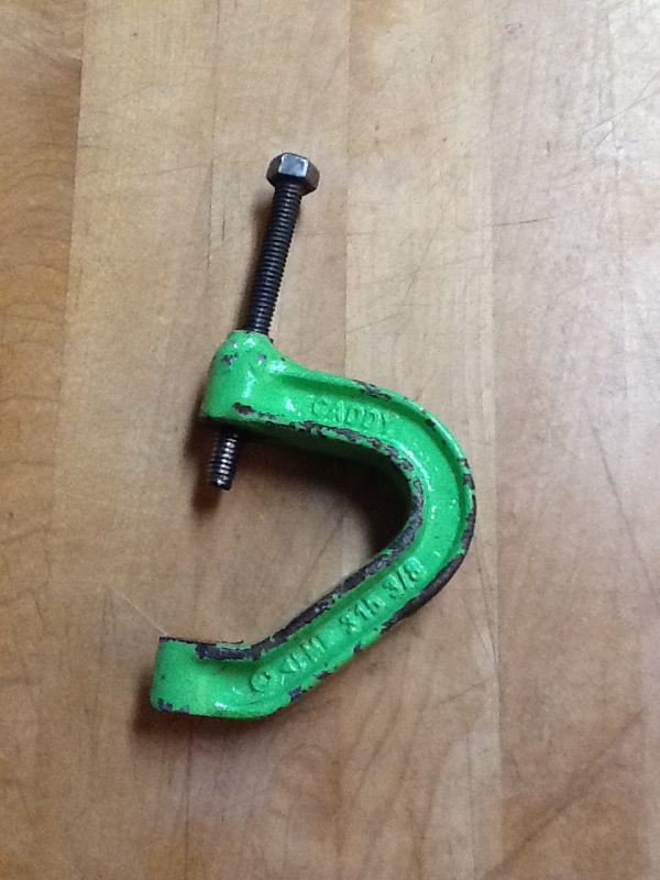

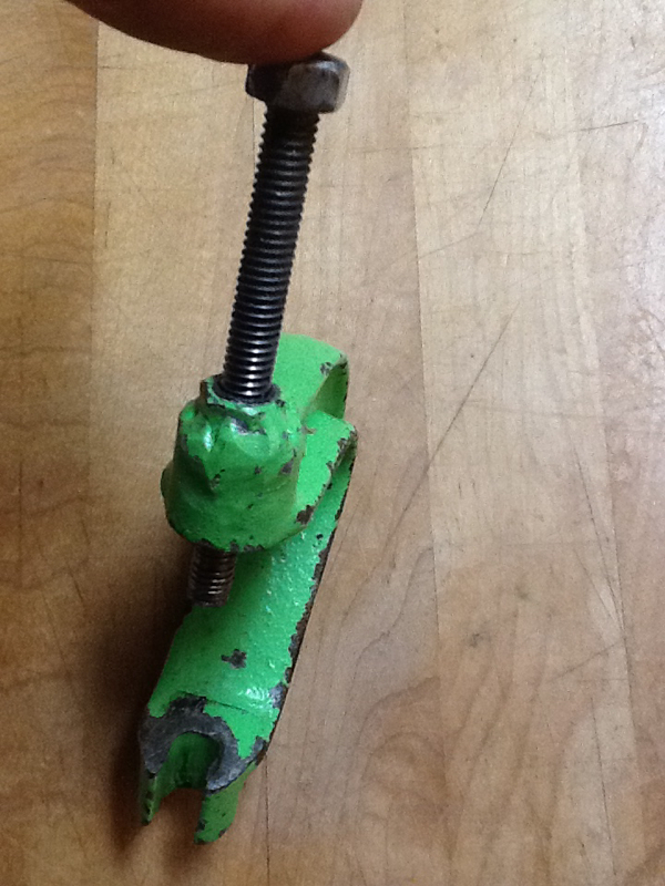

I thank everyone who took the time to offer some advice about this problem. I've attached a pic so that anyone else who has to pull out the big guns can see how I did it. The hole is high up on the cowling midway across as you can see.
