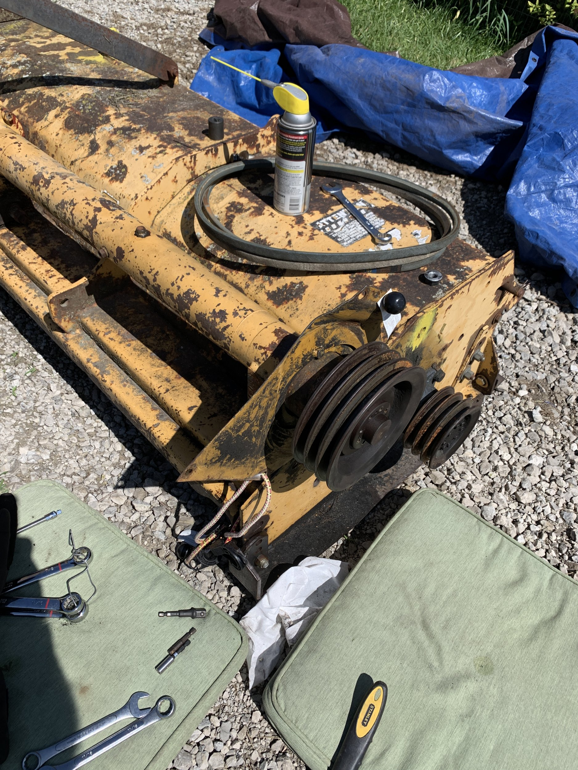

I’ve got a 9 foot flail mower. Need to replace the belts. I found that the pulleys really are not in perfect alignment. So I’m trying to remove this top one to move it out about 3/16. But it won’t budge. I’m afraid of putting more force on the gear puller. Could it possibly bend the sheave out of alignment. Also I noticed there are extra holes after I removed all the bolts. I’ve seen this where you insert screws in there and screw those in to push the pulley off. Strange thing is is that the holes are smaller than the bolts. Usually they’re the same size. Any advice??

Yes on those you screw the bolt into the sheve to remove not the pully. That looks to be an old Alamo flail?
3/16 really isnt that much.

using a puller will just tighten it on the shaft. The sheave is tapered you need to move the pully off the taper by using a hammer and drift to knock the pully back towards the mower and release the taper then remove the sheave. When you reassemble it consider putting back with the taper facing the other direction as long as you have room to access the retaining bolts it will make it easier to remove next time

Those smaller tapped holes are to push the sheave off of the taper lock hub. Use good bolts that will not mushroom as it could be really tight.
Ugh. 🙈 can’t find bolts to fit in those screw holes. They are really an odd size. 10-24 is too small and 1/4 - 20 is too big. In metric 5 mm is too small and six is too big.

It's a cast iron pulley so it does not bend, instead it breaks if you apply too much force with a puller or hit in a wrong spot with a hammer!
Using a puller on the outer edge will be counterproductive and possibly just make the taper bushing grab on tighter to the shaft.
It looks like whomever installed it last time tightened the tapered bushing bolts all the way down so it may be in pretty tight.
Why not check if the smaller pulley comes loose easier and if there is enough room to move the smaller pulley 3/16" in the opposite direction?
By the way, in your second photo it looks like the smaller pulley has the extraction bolts you are looking for.
Or just keep looking until you find out what size bolts you will need?

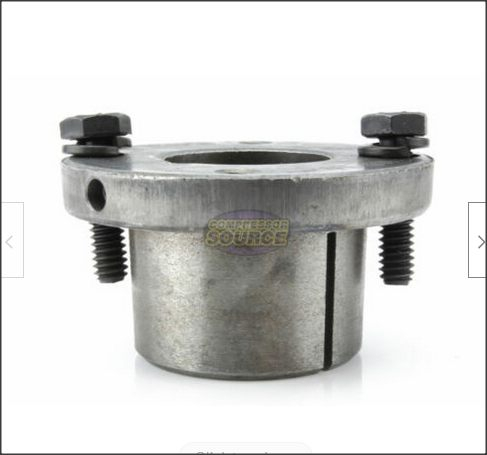

Here is what the rest of a typical (much smaller) H-style tapered bushing looks like.

Tapping is NOT an option at this time, the threads MUST go completely though the hub so the bolts can push against the pulley. With it assembled the tap will stop short of completely passing through the hub. However I would re-tap to a common thread after it is off.

Have you tried a 1/4" - 28 fine thread? Fine threads would provide more pushing power for the same torque. The other possibility is a #12 in fine or coarse.
Check the attach bolts and see if they are inch or metric. That way, you can eliminate half the choices anyway. In those sizes, there are no metric fine pitch nor is there a 5.5mm thread, so I think you have inch threads, you just got to find the right bolt.
I would not re-tap those holes. When you figure it out, use a paint pen and write the bolt size someplace on the machine. Inside the cover if that is a clean place. I do that often.

I think he already has the correct "pusher bolts" on hand - they are still screwed in the smaller pulley in his second photo of post #1
