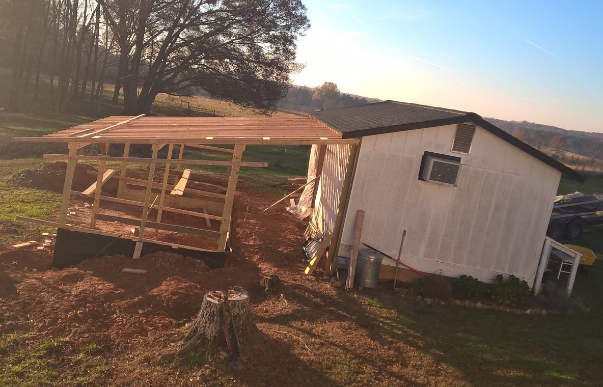

Here is a pic of the old roof and it shows the height we want the new roof installed at.
The current posts are about 7.5' from the building and we want to add 12' beyond that for horse stalls. There is 8 being added on to the left side to make the current long wall 24' long.

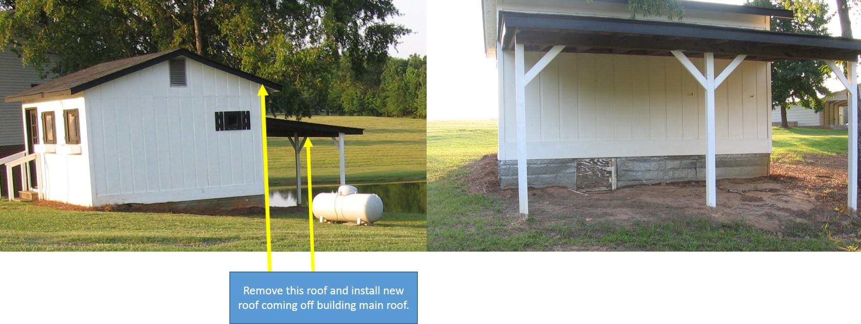

Here is a pic of the old roof and it shows the height we want the new installed at.
Another option would be to TEE off perpendicular from the side of that building with a ridge board that matches the height of existing shed. Or, go higher than the existing peak to gain enough room for a gable-end vent. It would mean removing the low shed roof that is there now. Where the length of the addition 24' extends beyond the back wall, you could have a section of hip roof over an extension that wraps around the existing wall.
Trying to save that small shed roof may be more trouble that it's worth. It is putting a lot of limitations on the result: pitch and headroom. You could also add on by building out toward the propane tank and leave the current shed roof in place.
It's hard to tell from a pic, but are you going to have horse run-off/drainage from the stalls into the pond? That would be bad I think.

We aren't going to save the old roof we'll build a new roof.
The horses won't be in the barn much cause I'm to lazy to muck.

We'll generally bottom out at 1" in 12": snow load is an absolute non-issue here, but that's pretty common.

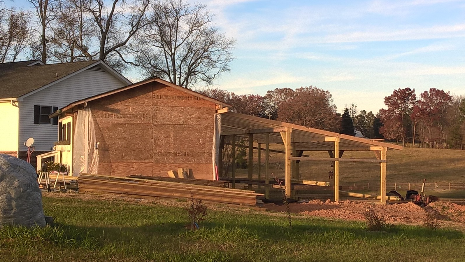

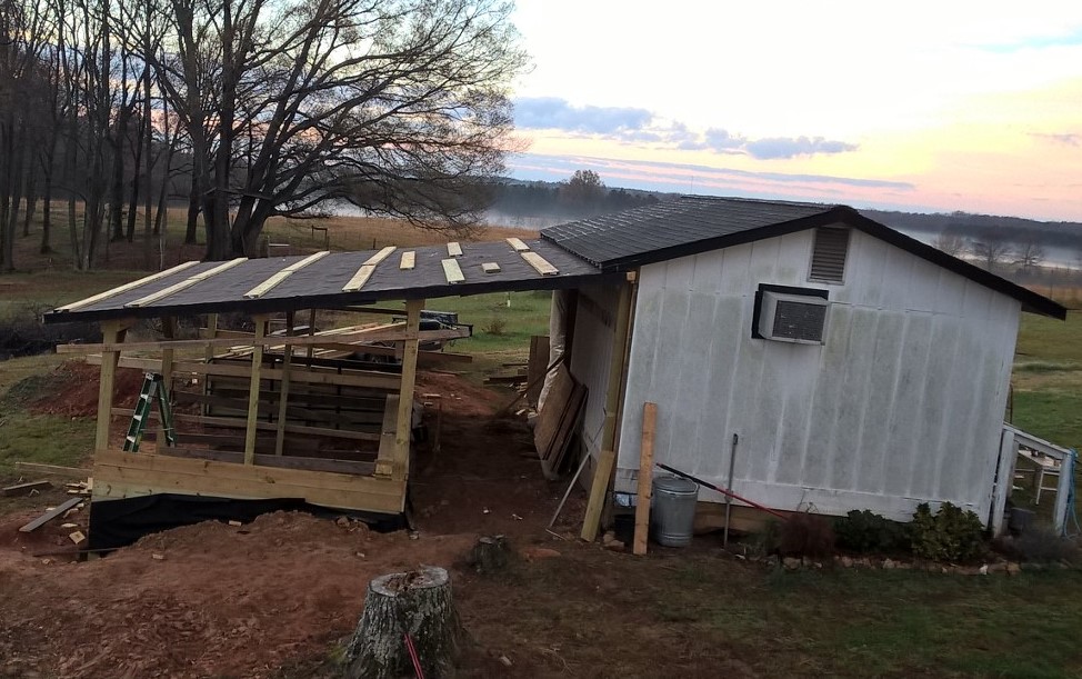

The roof is 2/12 pitch the shingles are rated for that with the underpayment with a 12" overlap. I went with more than 12" of overlap and I'm going to reduce the single exposure from 5.5" to 4" per the advice of local roofers.
With these per cautions and considering that the other roof was 1.5/12 pitch with the same type shingles I think it will be fine.
