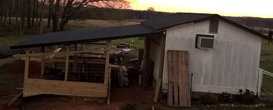

The roof is 2/12 pitch the shingles are rated for that with the underpayment with a 12" overlap. I went with more than 12" of overlap and I'm going to reduce the single exposure from 5.5" to 4" per the advice of local roofers.
With these per cautions and considering that the other roof was 1.5/12 pitch with the same type shingles I think it will be fine.

The shed roof ended up being 2" of slope per foot. We have had about 3" of rain the last couple days and it has not leaked.
