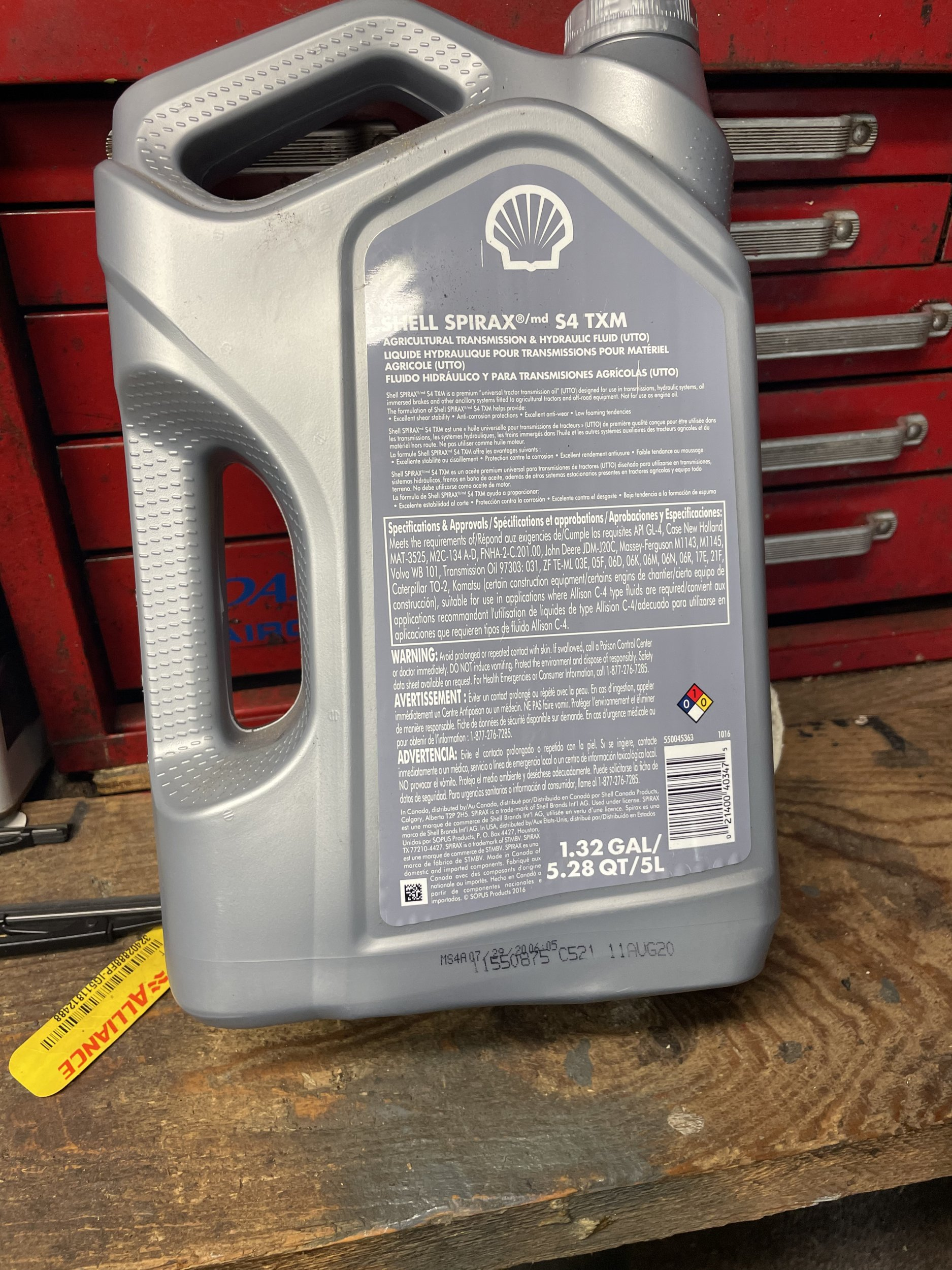

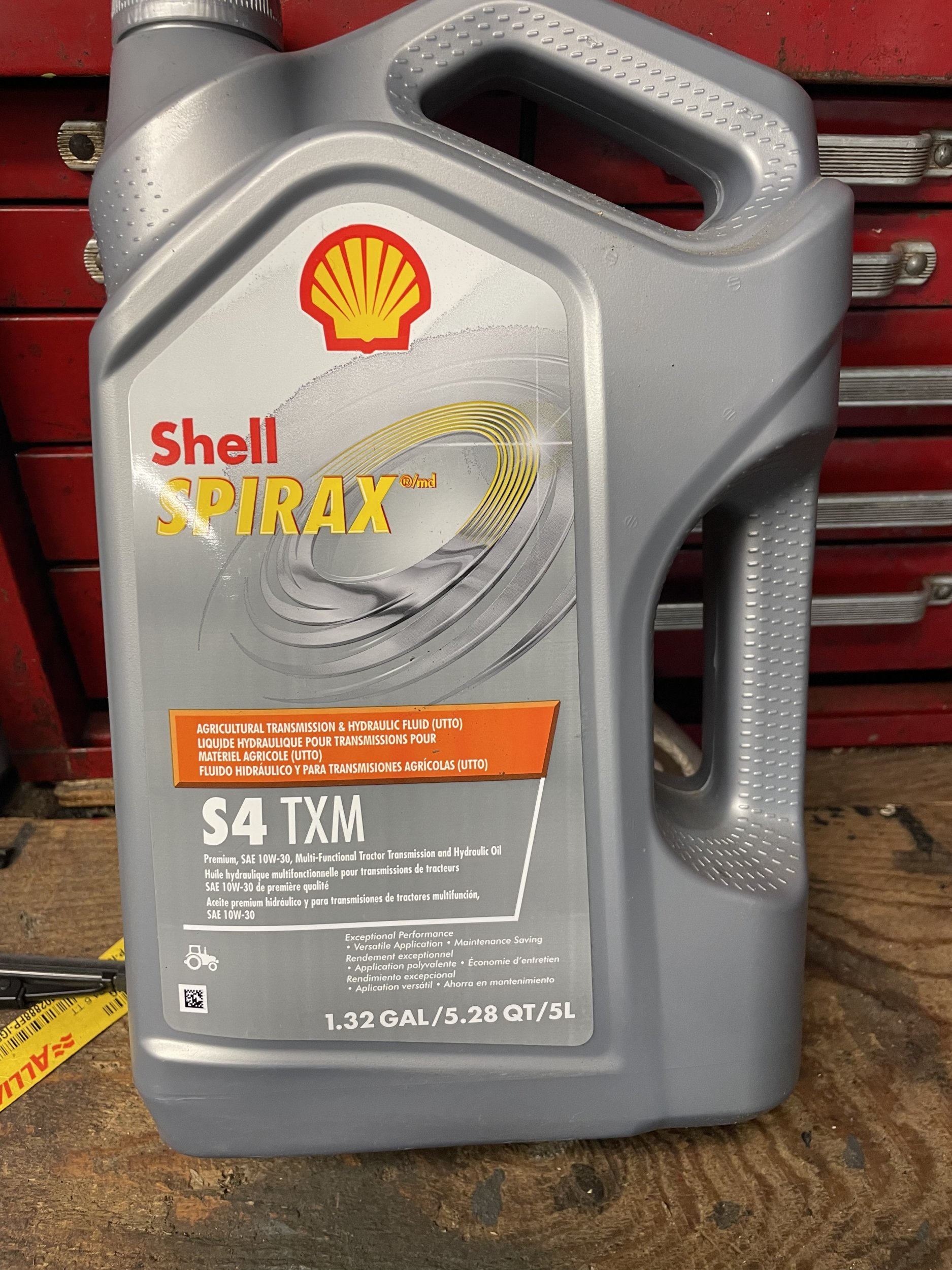

I have 8 jugs here for 1635 spring service, have been running it since first service on the 1635. Not one issue with it.

I realize this is an older thread, but I thought I would link the technical sheets for the two oils discussed here. The data almost looks like it was copied and pasted, with the brand name being replaced. Only physical property difference is the pour point; -42 vs -43.6
Shell Rotella HD
Shell Spirax S4 TXM ("Formally Known As: Donax TD")
Even the pour point is precisely the same. One PDF uses Celsius, the other Fahrenheit. -42C = -43.6F.

I spoke with Shell technical product support earlier today and asked what the replacement was for the discontinued Shell Donax TD was and he told me that it’s Shell Rotella HD tractor fluid.
   / Shell Rotella HD tractor fluid vs Shell Spirax S4 TXM ? #17
I just talked to Shell rep on the phone. He said HD is not synthetic. S4TXM is synthetic. (Spyrex)
