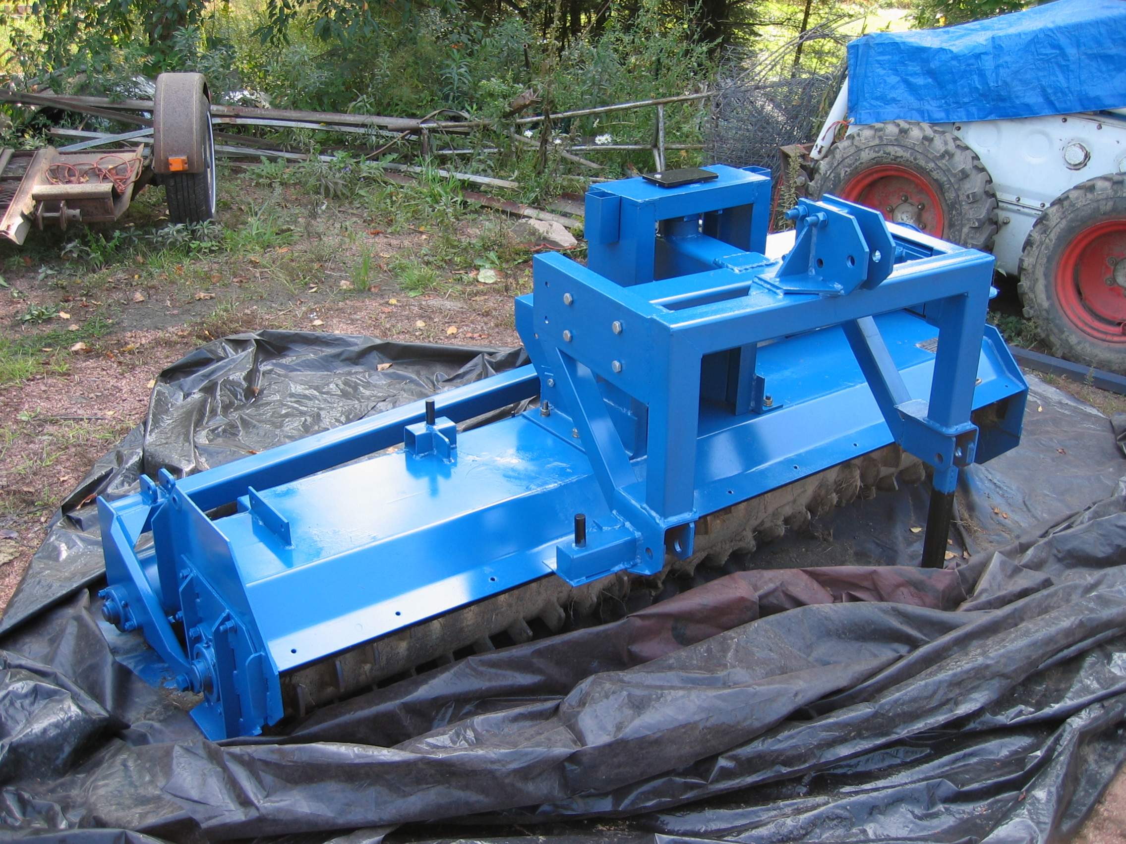

Great pics! The drum must have taken you a while to build!
   / She's DONE! - Power Rake Build
#22
Yeah it took me a day to get the shaft aligned, internal disc & end caps welded to the shaft, and then that unit welded into the pipe...
Took me a complete 9.5 hours to weld on all the teeth...

Dave;
Super job. The Harley people would be proud. I knew we were talking about going 6 or 7' on the drum. The one I bought and revamped has a 9" x 84" drum. My TC 55 has 18" wide rear tires and it just clears the path at a 15 degree angle. I have a guy interested in buying mine so I won't be getting rid of my spare parts too quickly.

Dave;
My tractor is pretty much exactly 60" wide so with a 75" Wide drum, even angled out at a little more then 15 degrees I got enough leeway, I hated to go TOOO wide because then navigation & where I can use it...All in all, I'm super happy with the way it turned out..

Looks good, Dave! I admire somebody who takes the time to do things right.
joes 427 vette: It looks like you began with a fixed-angle model 800 Preseeder. Nice job on the conversion process to hydraulic angle.

Nice build.
I wouldn't have believed it home made, especially with those suspicious looking "OEM" decals. I suppose they are OEM decals since you made everything from scratch. Thanks for posting some of the build photos. Did you have any parts plasma cut or are they all home cut / machined / ground? Either way it come out perfect and no doubt you should be very proud of your accomplishment. 9.5 hours welding teeth? thats insane. Another home build that should be in the hall of fame. Congratulations!
