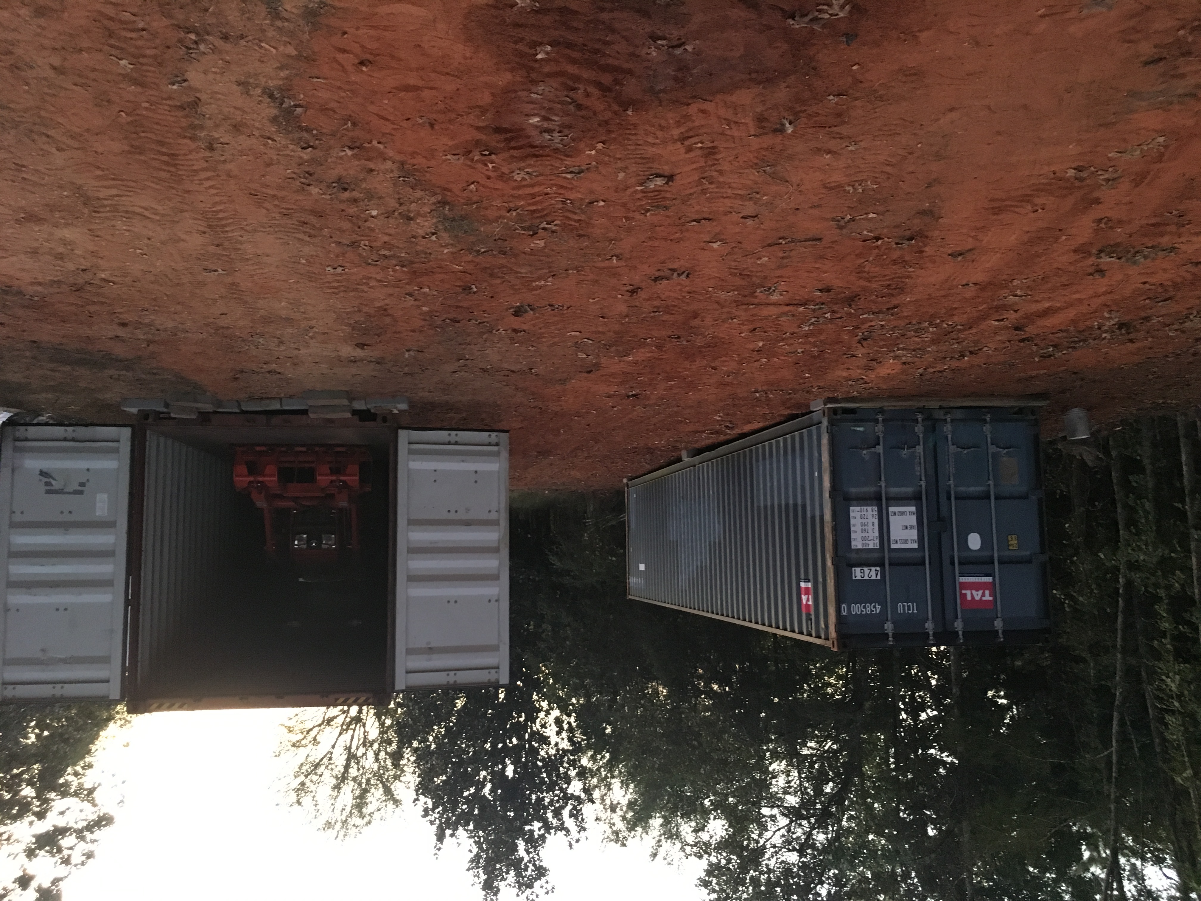

The single best thing about my shipping containers is that rodents don稚 get to my stuff.
