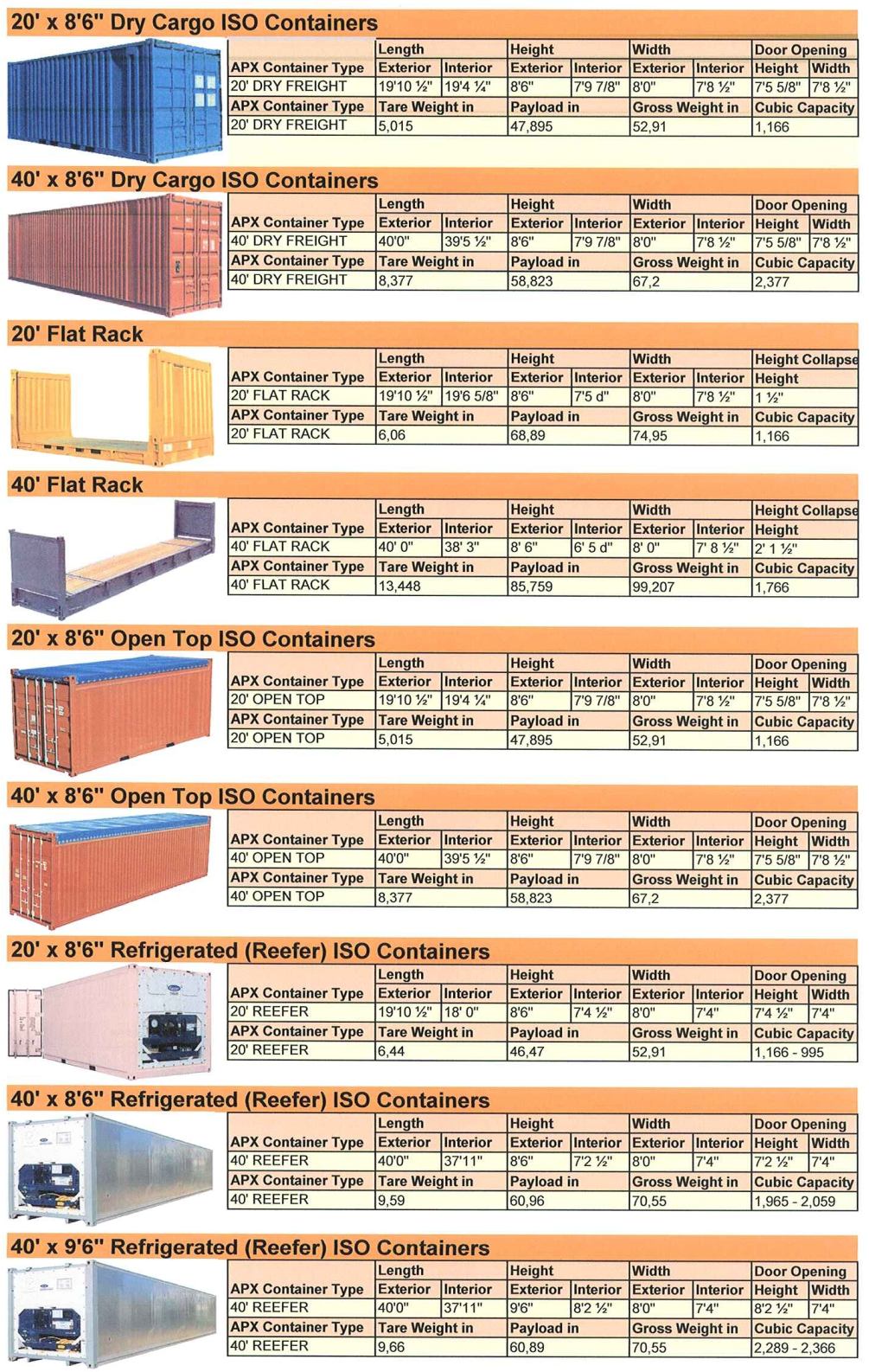

Im toying with the idea of a shipping container for storing tractor and other equipment on our new property. The ID of the container door is 101.5 tall at its smallest point. Specs for the tractor im eyeing are 100.7in tall with Ag tires. I have no way to test fitment before purchase......
Thoughts please.

I’m thinking about getting one, too. My tractor (with cab) is just over 8 feet tall. In this case, I need to go with a high cube container. A normal container is not tall enough. I contacted a local dealer and a 40 foot high cube is $5500 plus delivery. Less than the cost of building a pole barn, plus it will be rodent-proof. I just had mice chew thorough some wiring and need a safe space for my tractor.

How tall is the high cube (inside dimension)?

Be careful with height measurements. The entrance threshold is smaller... 101.5" once tractor is in im fine. Extra room. The threshold is my holdup. Building a metal shop or pole barn isnt possible at this time.

What's the limiting dimension, exhaust pipe, ROPS, cab roof, ....?
/ Shipping container for tractor storage
Top of cab at a manufacturers reported height of 100.7in. I measured the entrance at 101.5in

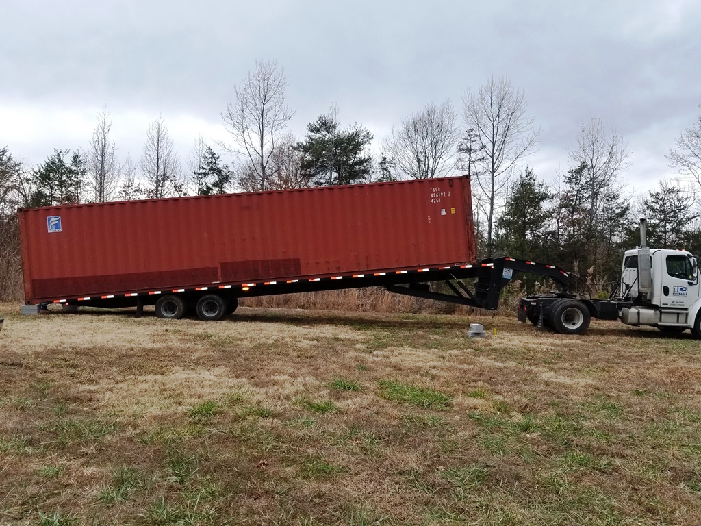

I did the shipping container after looking at a lot of various options. I couldn't build as large a structure for less $. And have it water tight, moderately secure, and mouse proof at least. My machine is smaller and fits just fine with ROPS up. But I will add this:
Cost for a 40' vs a 20' is just a small % more. Unless space is an issue, may as well get a 40'
It takes very little for ground prep to put one in place. Somewhat level is about it. Best option for me on fairly level ground was 4x4x8 concrete cap blocks. Just one under each corner point is all that's needed. I also used the smaller solid concrete pavers to level. Need solid blocks - cinder blocks are likely to crack.
For entry, I ran a 2x6x8 on top of the front corner blocks, flush with the corner pieces. This leaves a little overhang. I screwed 3' pieces of 2x10 PT onto that to make a ramp. That fits perfectly under the closing latches yet isn't a high enough ledgde that a tractor or ATV can't easily climb it. A basic riding mower can't & needs help in.
Leveling the container on blocks (or beams if you prefer) is important. You want left-right level and a very slight slope back to front. The left-right level is important so the doors open and latch closed easily. Unlevel and the doors can bind and be real hard to move. The slight slope toward the front is in case a heavy rain shower catches you - you wouldn't want the rain blowing in and running to the rear or otherwise not draining from the front.
There are various grades of container from "one-trip" (basically new) to pretty much unserviceable. There are grades in between. Most of the cheap sellers on CL are yahoos with an F250 and rollback trailer. They don't have the container. You order, they go to port and buy something that isn't suitable for another ocean trip & bring it to you a week or two later. No idea what you're going to get. I ended up getting mine from a local leasing company. It was still sight unseen, but was a container on their yard and something they would otherwise keep in service. Guaranteed to be free from holes, have a good floor, and be water tight. Not nearly new condition, but not scrap metal either. It was about $100 more and well worth it to know if I wasn't satisfied I could turn the driver away and they'd bring a replacement for free the next day.
As long as there is plenty of maneuvering room delivery is surprisingly simple. Mine came on a big truck with a rollback trailer. It was unloaded, leveled on blocks (that I had to provide), and within 1" of where I told them to drop it in all of 15 min or less. Once in place - or if you just want it dropped and worry about leveling later - it's simple to jack up one corner at a time and level the thing. They're heavy, but only lifting a corner at a time doesn't take much of a jack.
You do want it off the ground a little. I found a lot of the clist sellers saying it didn't matter - just drop it on the dirt. But after talking with people who make their living with these things it was clear that a little room for air circulation underneath will avoid lots of interior condensation problems and extend floor life. Mine is 8" off the ground in the back and 5.5" in the front. That is plenty.

I did almost exactly what CMV did, but went with a 1-trip and set on RR ties put across wise. Mine sits about 1 RR tie off the ground, and for ingress/egress I've got a pair of HD trailer ramps for the tractor, for the riders and my jon boat I've got a pair of alum folding ramps, I put my attachments on dollies and can pass my riders by the shredder and BH or each other, but I agree you do have to unload to get the jon boat from the far back out. A opposite end door isn't an option for me, as it's a drop off on that end that makes ingress/egress impossible. I also agree, but the best and most you can afford, they don't expand and you will run out of room before you know it.
