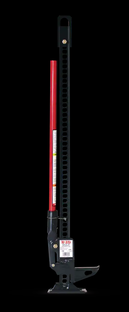

my thought as well.
If just trying to move it once big enough wheels in the middle means ends weigh almost nothing.
Could use two jack-alls on the corners and would easily lift to get wheels or rolls underneath.
I lifted a 40' with 2 jack-alls, placed 5" rnd fence posts under it bought from local farm store cheap and pulled - rolled it around with a utility tractor.
I bought one of these "cheap" 3 ton 60 inch jacks at TSC on sale last year. Flimsy castings. Broke the first time I used it. No thank you.
I need to go to some farm auctions to find an older unit NOT made in china or India.
