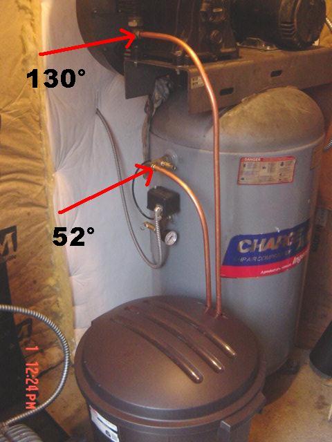

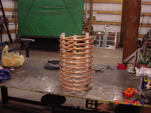

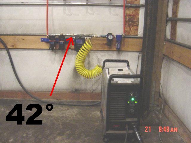

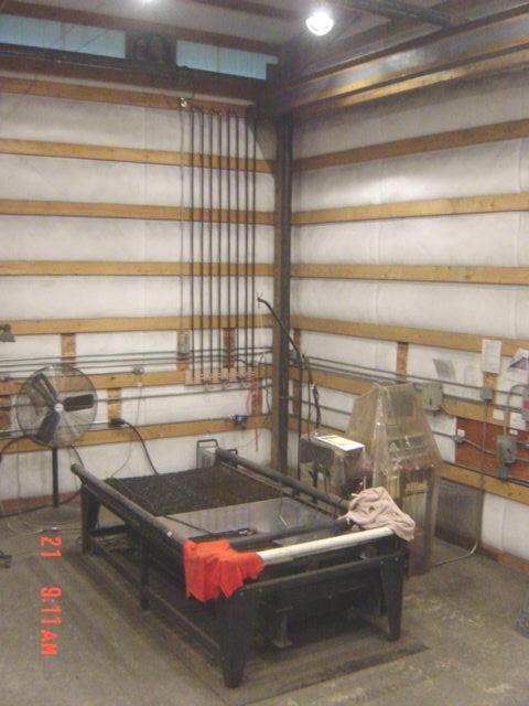

You could always make a redneck air dryer too. Inter cooler, and after cooler. :laughing:
   / Shop Air System Install #20
Interesting.... Is the garbage can just a shield to protect the coil from dirt and damage?
