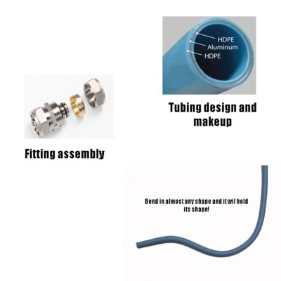

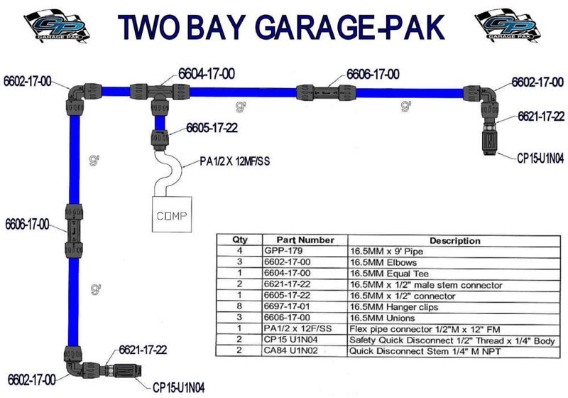

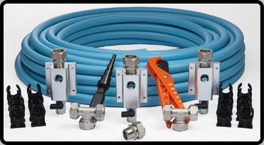

On my project list this fall/winter is a compressed air system installation for my shop. I'm starting to do the planning and research for this effort and thought I'd reach out to get some input on materials and design. It appears that the traditional approach has been either copper or black pipe. In doing some research, I've found some alternatives which include aluminum and aluminum lined plastic tubing. Here are some pics I've found on the internet:
So ..... What have you done in your shop with compressed air? Would love to get any/all advice on this project and of course, pics are always welcomed / desired.

Bubba, Thanks for your feedback and sharing your experience. I'm definitely not going to use PVC. The straight aluminum pipe was featured on Jay Leno's garage and the aluminum lined pipe is something I found on the internet by RAPIDAIR. image-4105809751.jpg Both systems feature quick attach couplers that avoids soldering or threading pipe. The aluminum lined pipe is quite a bit less expensive. Both are designed and sold specifically for air systems. Thomas

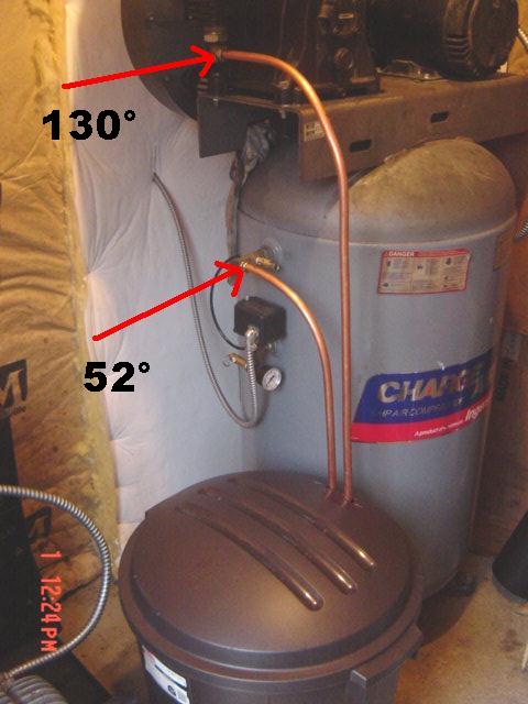

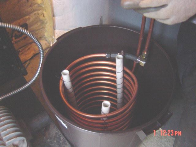

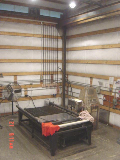

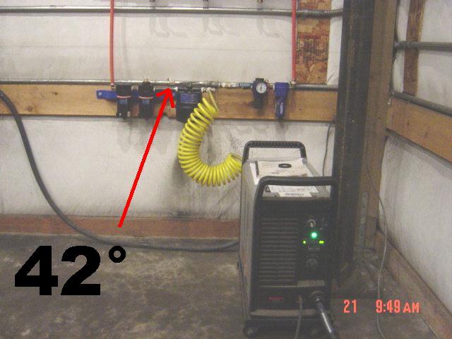

You could always make a redneck air dryer too. Inter cooler, and after cooler. :laughing:

/ Shop Air System Install #20
Interesting.... Is the garbage can just a shield to protect the coil from dirt and damage?
