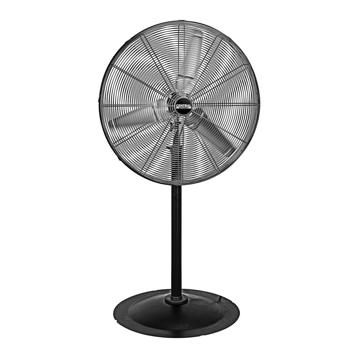

We just built my bil a 30x40 shop with 10 ft sidewalls and vaulted ceiling. We installed two commercial 70 inch three speed ceiling fans from Menards during build. Maybe you can retrofit fans to ceiling with surface mount conduit? If that's not possible maybe a large stand fan aimed up towards ceiling?
   / Shop circulation #4
   / Shop circulation #5
From harbor freight $159 it telescopes to 6 ft and tilts to 70 degrees.
