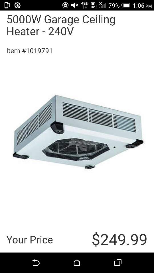

This is the ceiling Heater that I am referring to Screenshot_20180104-130626.png

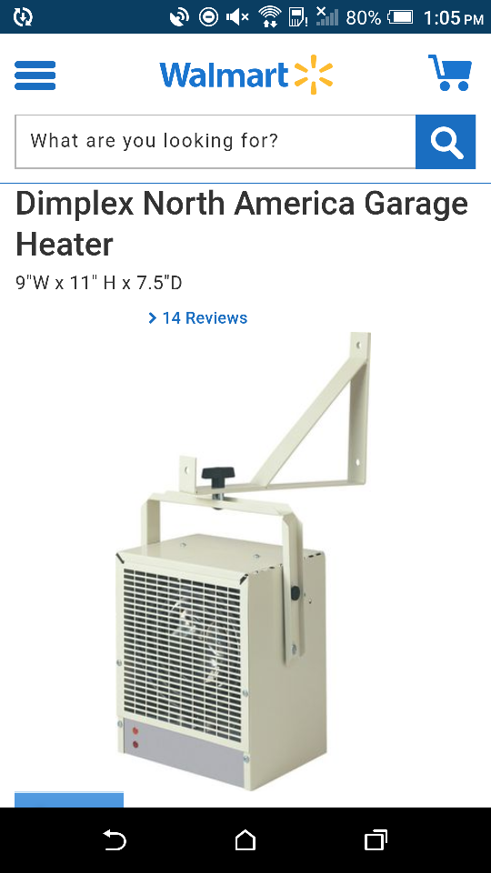

Unless your ceiling is 8.5ft or less, the ceiling unit helps a LOT.
