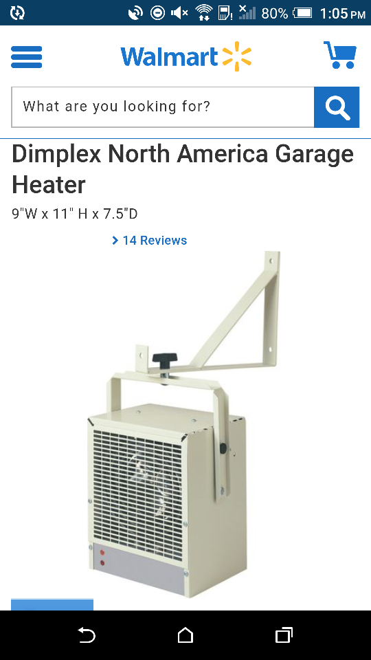

Are these really all they’re supposed to be? I don’t see how 100 percent efficiency can be improved upon.
It’s semantics (electric is 100% efficient) but yes their are ways to make electric heat cheaper.......urrr more efficiently. As an example, heat pumps make more BTUs/kw than traditional resistive heat.
Btw- it’s roughly 1/3 watt per BTU. So if One had a 40,000 BTU (heat output, not total output) gas furnace you would need about 13,000 watts to replace it. But again, sizing will need to be calculated.

rhe problem with these cheap heaters, there cheap to buy but expensive to operate. for example, a 5,000 watt electric heater run 50% of the time in cold weather (in reality it would probably never shut off in this cold) would cost
5,000 watt = 5kw per hour
X 12 hours per day = 60 KW
here in idaho we pay .06/kwh for electricity, therefore this heater would cost 3.60 per day to run. that equates to $108.00 per month to heat.
a larger heater wouldnt need to run as long, so is more efficient in the long run. Most electric shop heaters are in the 5,000 watt size, but i have seen a few 7,500 watt ones. the larger ones would need 30 amp circuit draw.

I have planned for years to install a natural gas line to my shop and one of those ceiling mounted heaters. I also want a ceiling mounted heater in the garage. BUT, our local gas utility has very, very strict rules on who can install lines and appliances. This probably was caused by a couple of houses exploding a few years ago after the homeowners changed something on their lines. I know both of them. One of the guys told me he opened the door and flipped on the light switch and his next thought, before he passed out, was "Where is my house and why am I looking at the sky?". The other guy's wife was killed in the blast.
Anyway, the cost will be very high to have the gas line run from my house, around a patio, over field tile, under a sidewalk, and to the shop. The heater for the garage would be easy to install. Just run a line up the garage wall and mount the heater. So I am considering having a 240-volt ceiling mounted heater installed in both locations. I think it would take years for the higher cost of the electricity to overtake the cost of installing the gas lines and heaters. The garage heater would be set on 40 degrees and would help keep the utility room warm and the vehicles not as uncomfortable when starting out in them. The shop heater would be set just high enough to keep anything from freezing unless I ventured out there to work on something.
Does anybody have this? How much power is used? Are you satisfied with them? How about the sizing for the shop? It is a 24' x 30' insulated building with an upstairs that I intend to close off.
Thanks for your advice.
