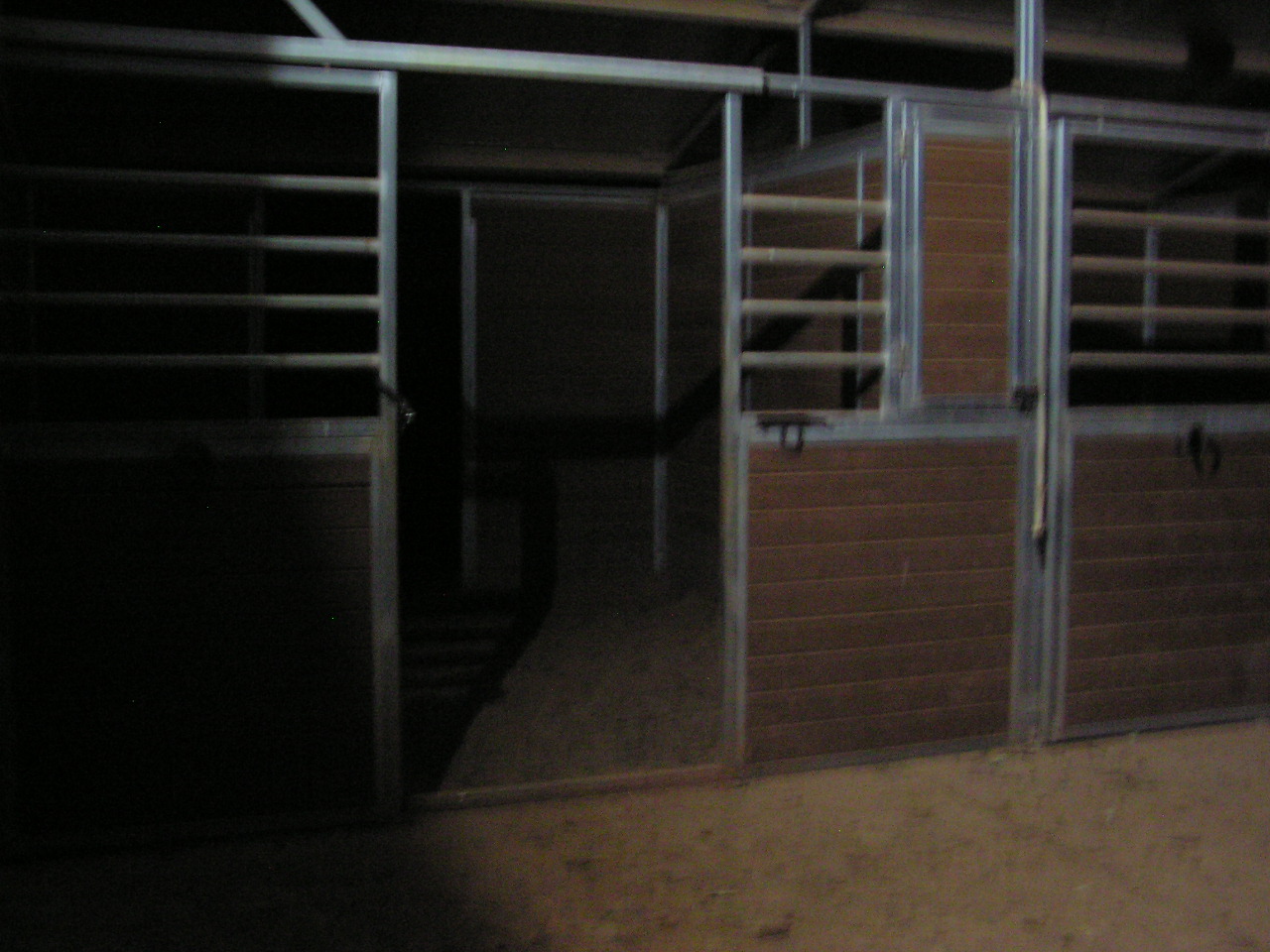

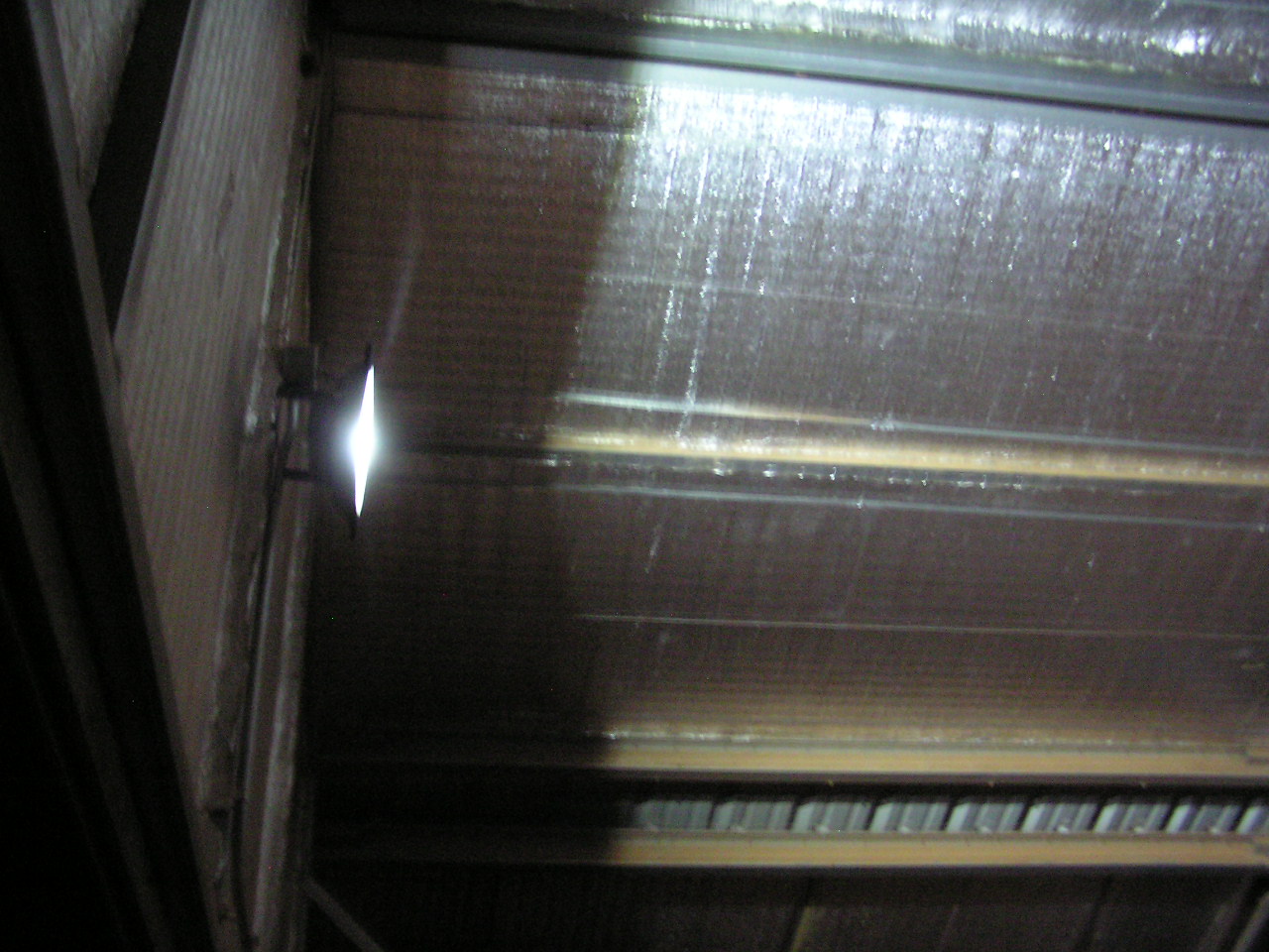

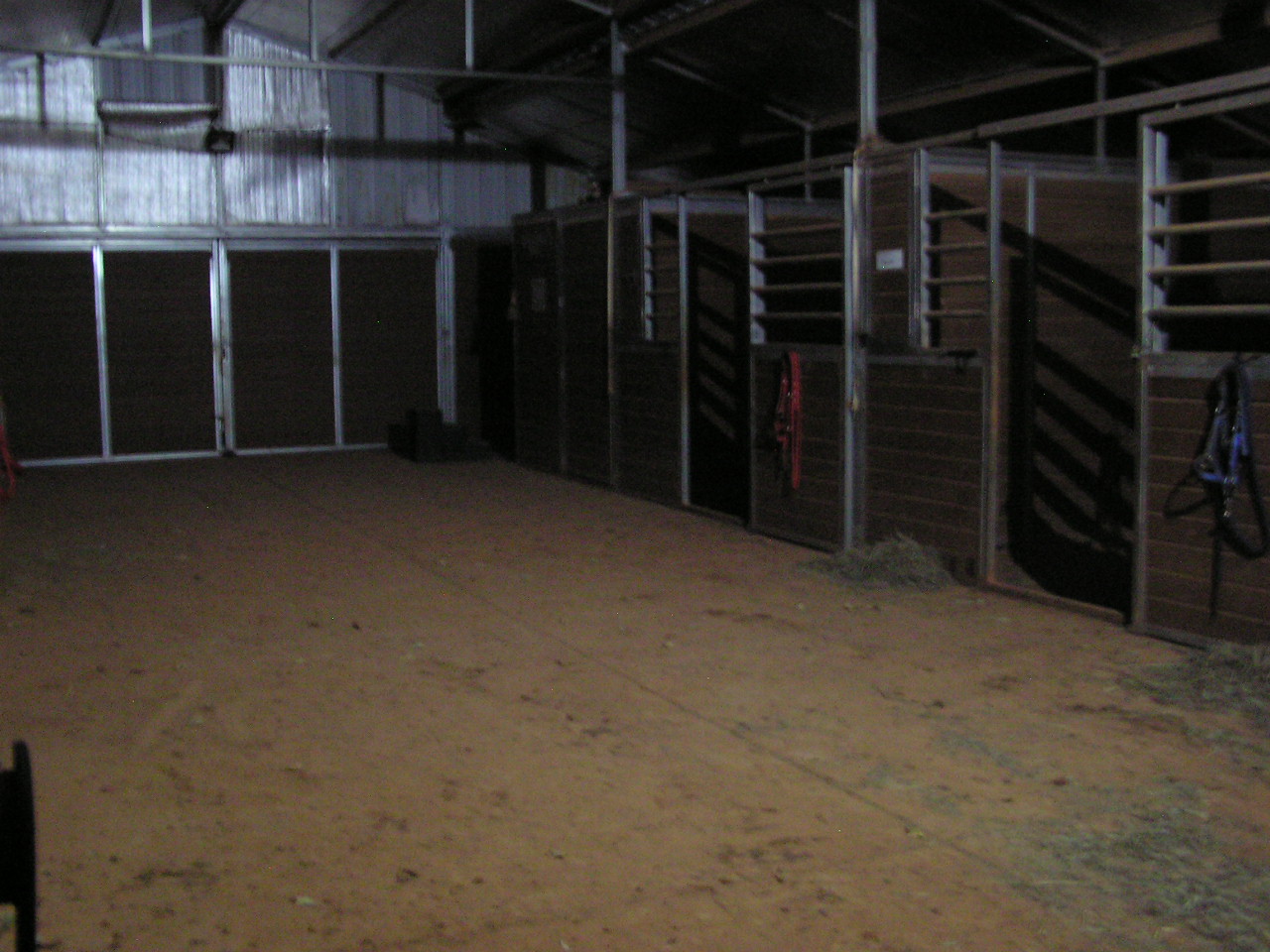

Night time interior pictures.
Standing under the LED, looking up at it to show the light pattern on the roof.
It is 52 feet to the other end of the barn.
The shadow line on the floor is 4 feet from the wall the LED is mounted on.
