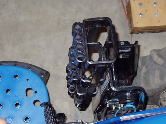

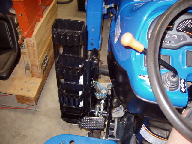

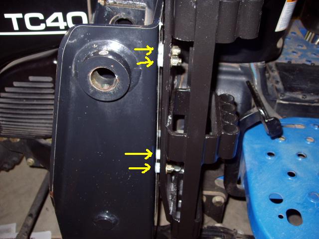

With the FEL detached I had several close quarter field jobs to do around here today before re-attaching the FEL and photographing the final scabbard mount photos with shotgun and shells in place but we were hit by a large (for our area this time of year) rain and hail storm for most of the day. I will try to finish up tomorrow but do have some permanently mounted scabbard bracket photos taken yesterday in the shop.
First photo shows the inside of the FEL dock and the four (yellow arrows) 5/16" grade eight hex bolts. There is plenty of room for the hex heads and the FEL vertical arms once again attached to co-exist within the same space. Note the two orange circled holes. These were pre-drilled by NH and covered over on the outside with a full length sticky DANGER/WARNING label, I did not know they existed until pulling the FEL.:mad: Due to the proximity of theirs and mine, I decided not to drill another hole and use their hidden hole with a washer.
Second photo shows the four through bolts and the four 5/16" white nylon spacers separating the 3/8" thick FEL dock from the 3/8" thick scabbard backbone. In this instance I didn't want the possibility of water/rust entrapment.
Third photo shows a view from the operator's platform. The shotgun's pistol grip will be positioned inward.
Fourth photo shows the clutch pedal in relation to the scabbard mount. Closests clearance is 1-7/8" and quite acceptable even for my size 13 shoe. Absolutely no touchee.

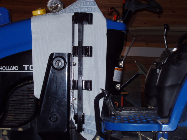

The last photo I put a white towel in the background to better show the profile. Not the backbone's angle at the bottom of the scabbard mount. I did this for several reasons:
The last/bottom scabbard bracket is narrower in width than the upper three brackets because it only has to house the shotgun's barrel tip.
In designing the scabbard bracket and with that barrel tip width in mind, by making that last bracket narrower than the other three allowed for extra clearance for the clutch foot pedal.
