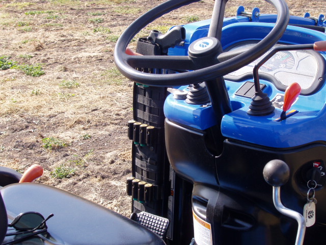

Third photo shows a view from the operator's platform. The shotgun's pistol grip will be positioned inward.

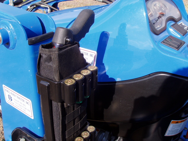

Fourth photo shows the clutch pedal in relation to the scabbard mount. Closests clearance is 1-7/8" and quite acceptable even for my size 13 shoe. Absolutely no touchee.
The last photo I put a white towel in the background to better show the profile. Not the backbone's angle at the bottom of the scabbard mount. I did this for several reasons:
The last/bottom scabbard bracket is narrower in width than the upper three brackets because it only has to house the shotgun's barrel tip.
In designing the scabbard bracket and with that barrel tip width in mind, by making that last bracket narrower than the other three allowed for extra clearance for the clutch foot pedal.

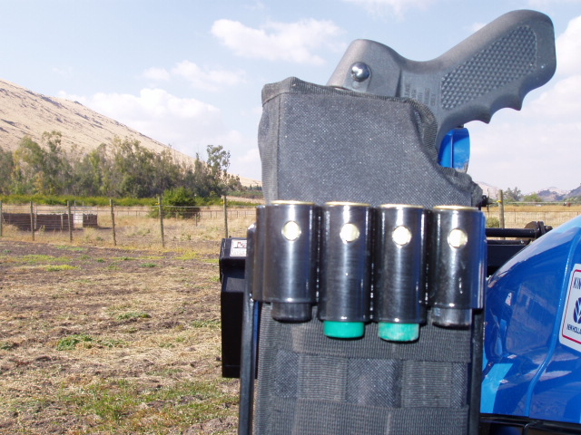

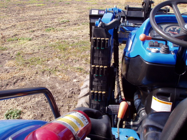

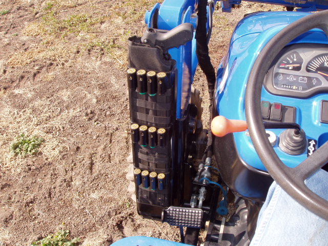

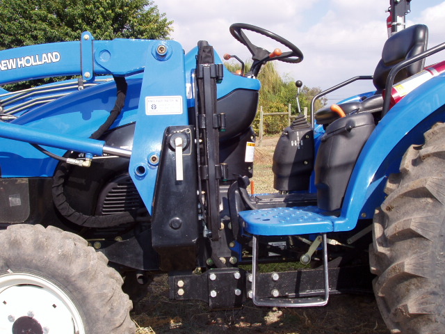

Here are the final photos-my first ever welding project-74 individual MIG welds. The synthetic scabbard can be reversed to place the pistol grip pointing to port, I prefer starboard.

About one second in, one second out but not loose fitting at all. For the rectangular metal rings, I first built a wood mock up and adjusted them to fit the birdcage, the scabbard and the shotgun.
Measurement wise, the entire fabrication process went better than I thought even down to the pipe tubes that securely hold the twelve 12 gauge shells in place.
