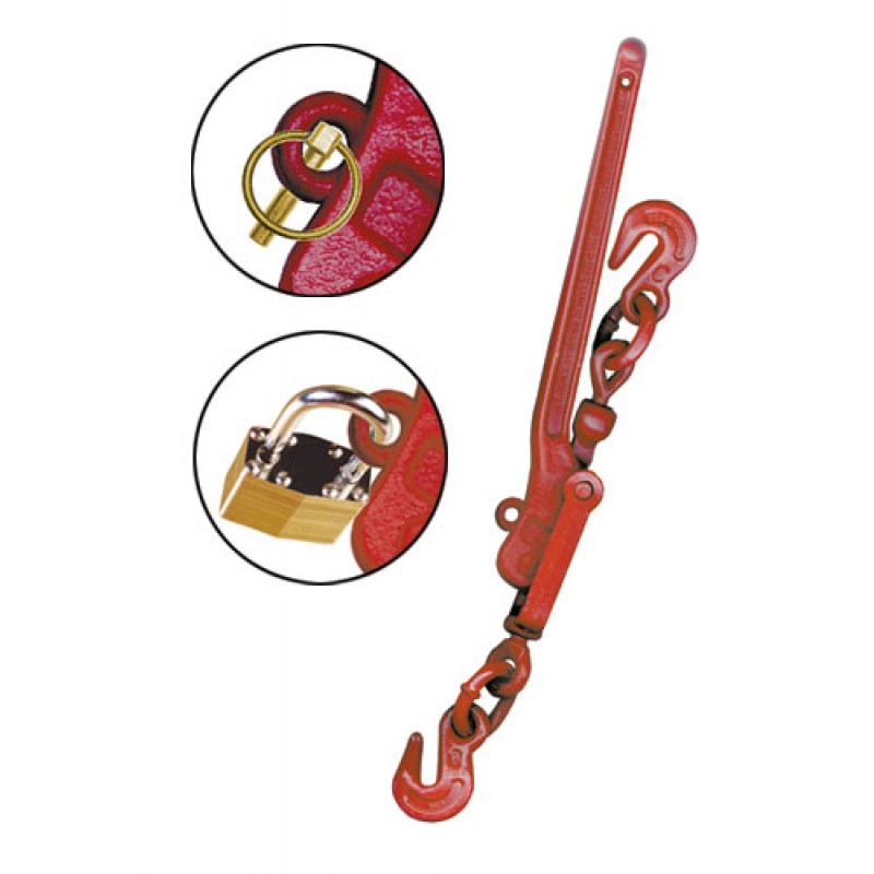

RATCHET BINDER - FOLDING HANDLE RATCHET BINDERS
I bought 4 of these to secure my tractor on the trailer. Very easy to use and eliminates the lever type binders that can snap back and hit you if you are using a cheater pipe ! The folding handles is a plus also. Not sure where they are made but they are heavy duty and good quality.
I'm also using these style binders, mine sourced from Northern Tool, I'm sure import, but decent quality. My G70 chain was HF on sale, and I dedicated them and binders to tie-down only, I don't drag as I've got a couple other chains I use to tug, pull, drag, etc. so if they get dirty or damaged I can still trust my tie-down stuff. I really like the binders as you can fold the handle and put padlocks on to secure - those things seem to grow legs in parking lots very quickly.

Those folding handle ratchet binders look interesting. So, the reason they are better is because they don't rust up and you can lock them?
EDIT...oops...yes, and the folding handle.
I thought the main point was the handle folds up.
