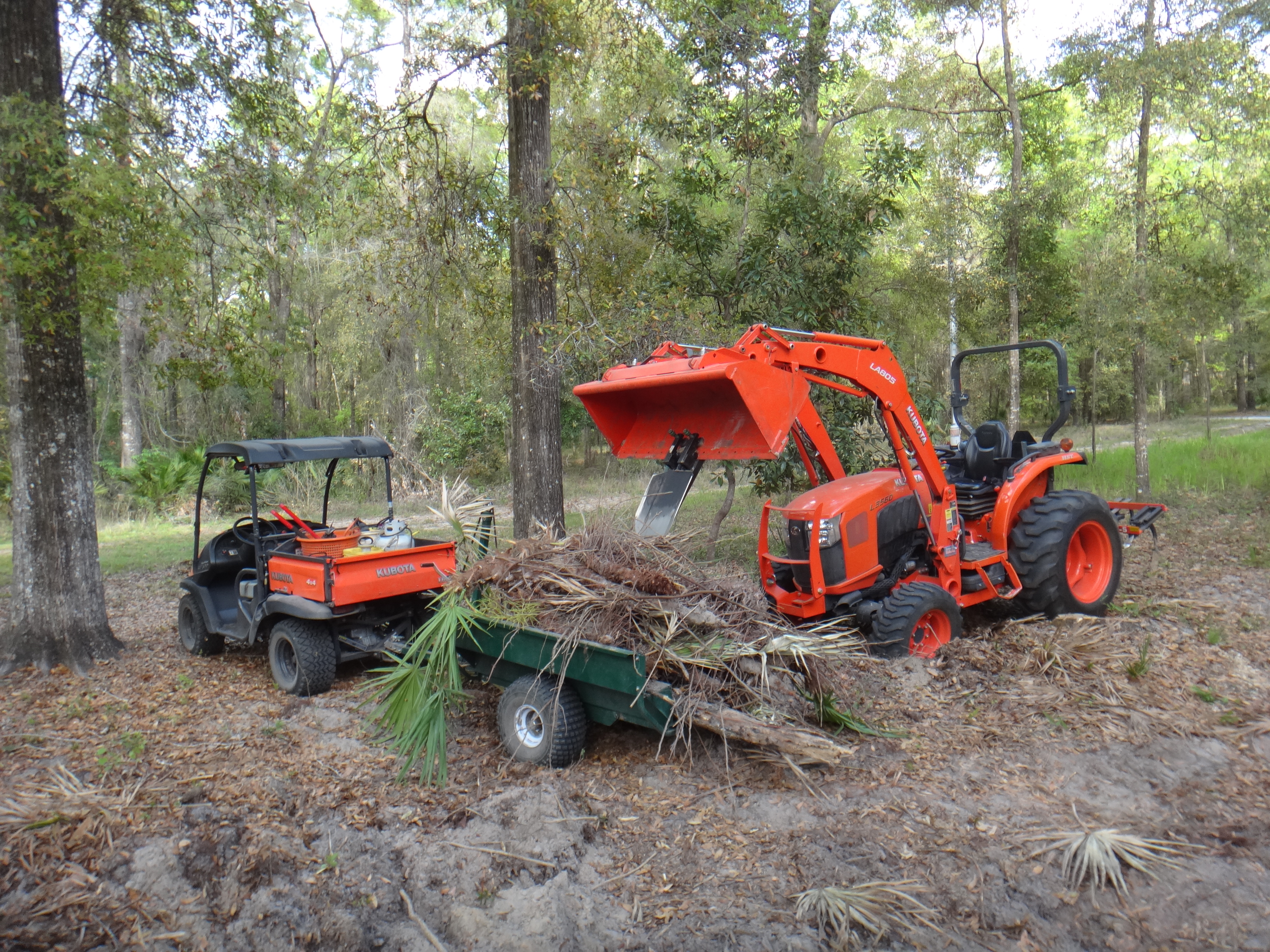

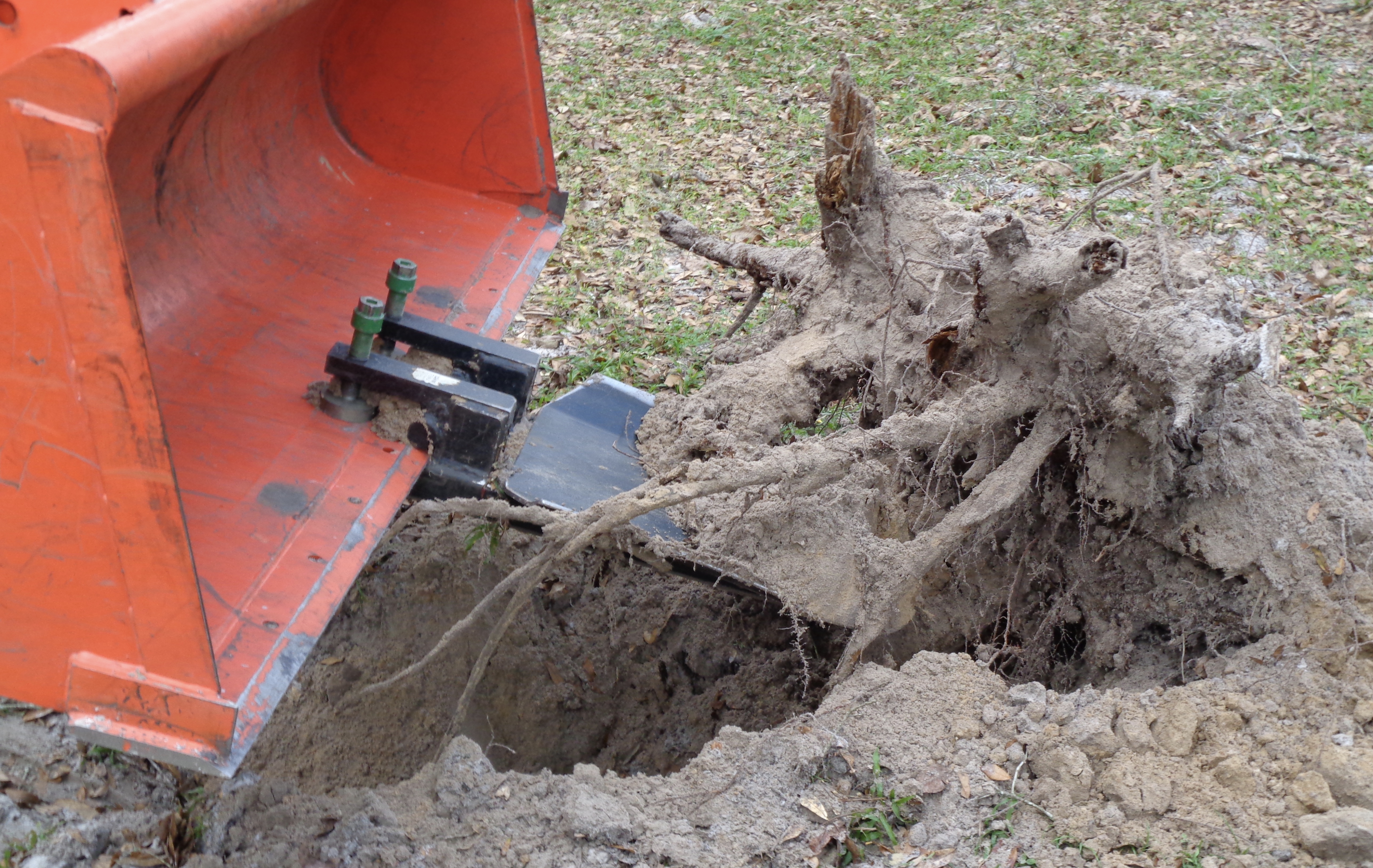

I have about 3 acres total, about 1 is grass/landscaping, 2 acres wooded. I have plans to refresh my landscaping as well as to peel out some of the trees and put in a garden. I also want to make some paths through the wooded parts for some small bike trails for me and the kids. I have some hills, so tippiness is something I have to keep in mind. I plan to fill the tires and add spacers with either rig.
For three acres total, forget the Backhoe. Buy a Piranha (digging) Toothbar for FEL bucket and a Ratchet Rake bucket attachment for tearing out brush and grading. That is all you need for three acres. Put the money saved toward the heavier B2650 without a Backhoe.
VIDEOS: tractor Piranha - YouTube
tractor Ratchet Rake - YouTube
In most cases a tractor FEL has about twice the lifting capacity of the tractor Backhoe.
A Bucket Spade will concentrate lift capacity in a reduced area.
With a Bucket Spade you move the tractor to a new digging area from the regular seat.
With a Bucket Spade the Three Point Hitch is available for use with an implement in alternative moments to the Bucket Spade.
VIDEO: bucket spade FEL - YouTube
