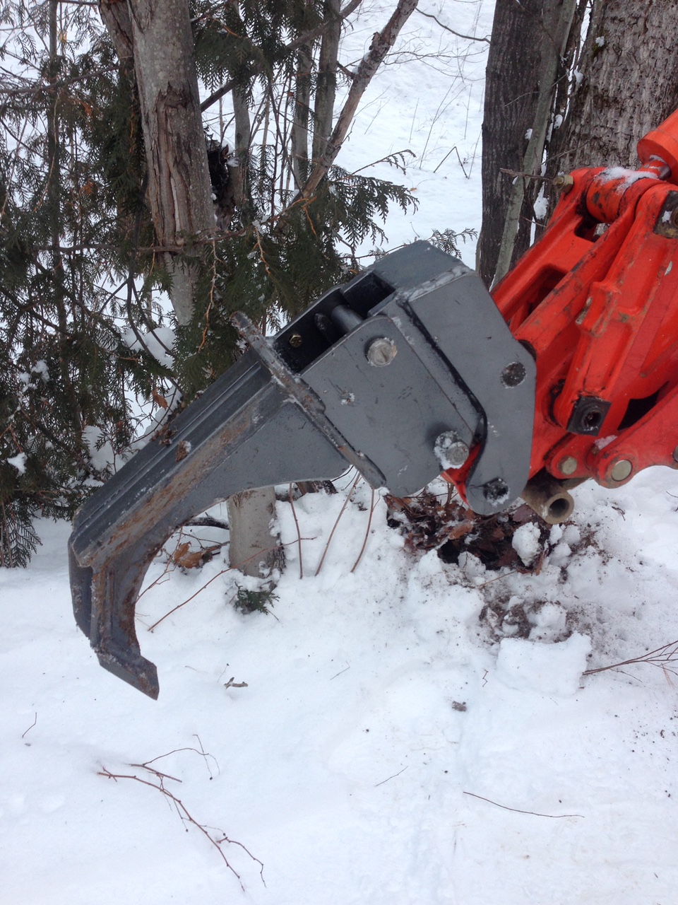

Digging out stumps is a real PITA, and don’t expect a Mini Excavator to make is easy.
If you do get the backhoe (and I do use mine), get a ripper tooth for it, with a Quick Attach. That WILL make a big difference in cutting stump roots.
Bro-Tek carries them, as well as BXpanded.com. The one above is from Bro-Tek, and shows the QA.
I was definitely going to get a ripper of some kind. The bxpanded one was my leading candidate. Thought I still had more research to do.
