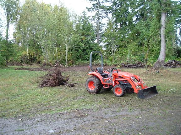

I looked at your 3130 Orangealex, nice tractor. Pretty much the same as the CK30 I have less all your fancy additions that I am very jealous of. I can't see why you think the 3130 is any different than the ck30. Please enlighten me. I sat on both and chose Kioti. If the price was the same, I would have gone 3130. Your tractor looks like mine.
Don't be defensive, just the facts please.
This picture is also thread related.

I paid just over 15000$ for my tractor and in the photo I am towing that stump to the pile. I dug it out with the loader.
