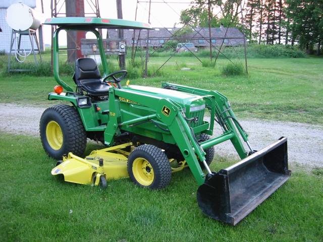

</font><font color="blue" class="small">( This picture is also thread related. )</font>
So is this one. /forums/images/graemlins/grin.gif
