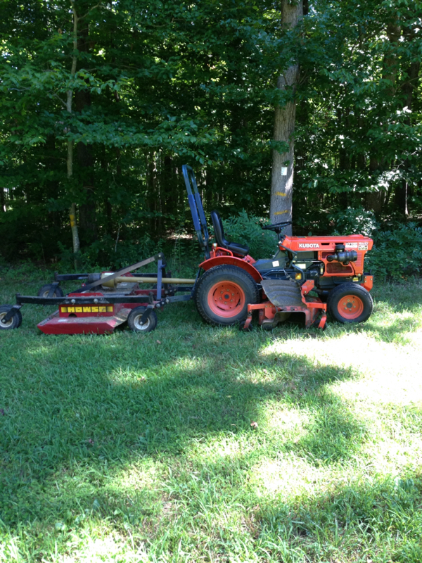

I have attempted to pull a 72" finish mower with a B7100. It is much harder on the tractor than using the 60" belly mower. The finish mower almost constantly lugs the engine, and then the mower weighs almost 3/4 as much as the rest of the tractor. Just dragging it around is quite a chore. image-559038074.jpg

I am actually planning on going to a twin spindle on my L3400. I dont think a ~1250# 8' twin is going to be harder on the tractor physically than my 1100# 6' single.
My most common 3 gears for mowing are Low 4, High 1st, and High 2nd. (4th, 5th and 6th gears). . Which IIRC is something like 3.5mph, 4.1mph, and 5.3mph. My next gear jumps to something like 8mph. There are many times I mow in 6th gear and it is hardly a load. (like the jobs that get cut 4 times a year). The 8MPH gear over-runs the blades and leaves uncut grass. And in the thickest of thick that I have been in, never needed to drop below 3rd gear.
It seems 9 times out of 10 I am slowing down due to bumpy ride, obsticals, unknown ground, etc. And not very often for lack of power.
So given that there are many times where I am going as fast as I can and have plenty of power left, yet never had to touch my slowest two gears, I dont think an 8' twin being 2' shorter and only a tad heavier would give me any trouble at all, nor do I think it will give the OP any trouble with his added HP.
