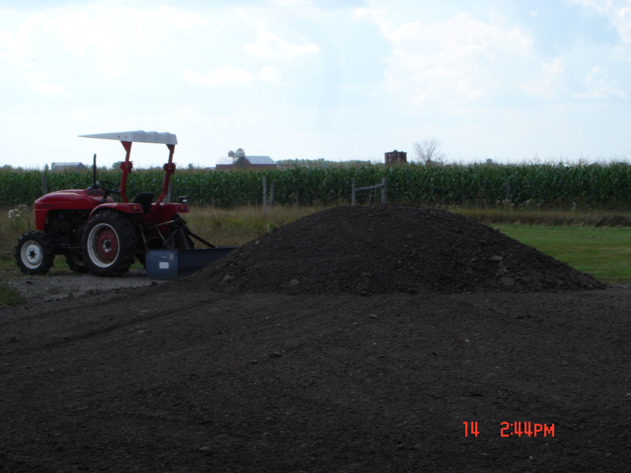

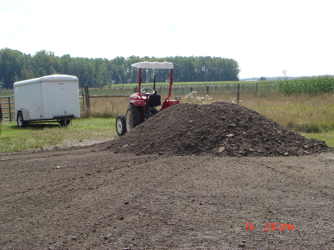

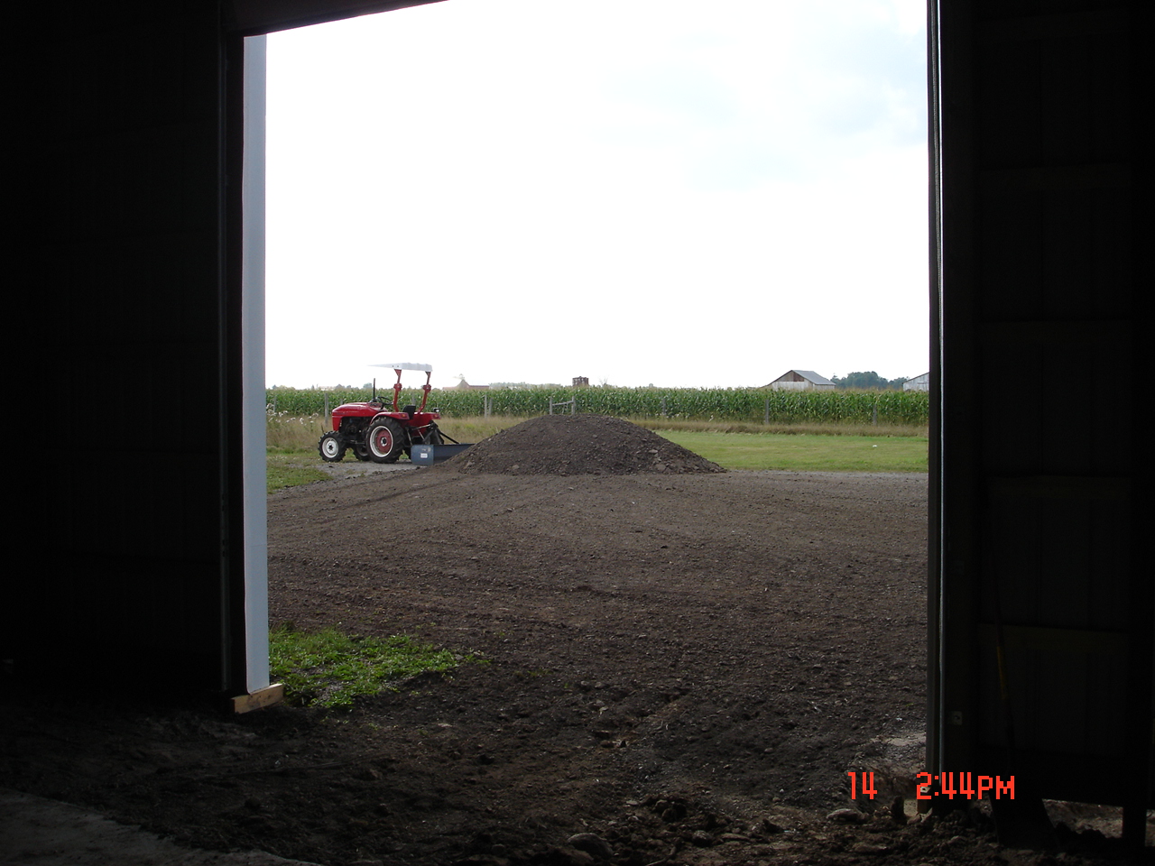

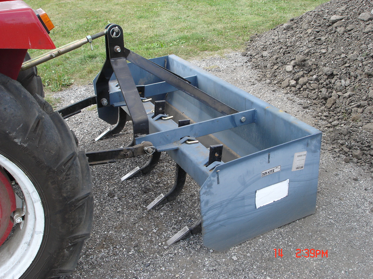

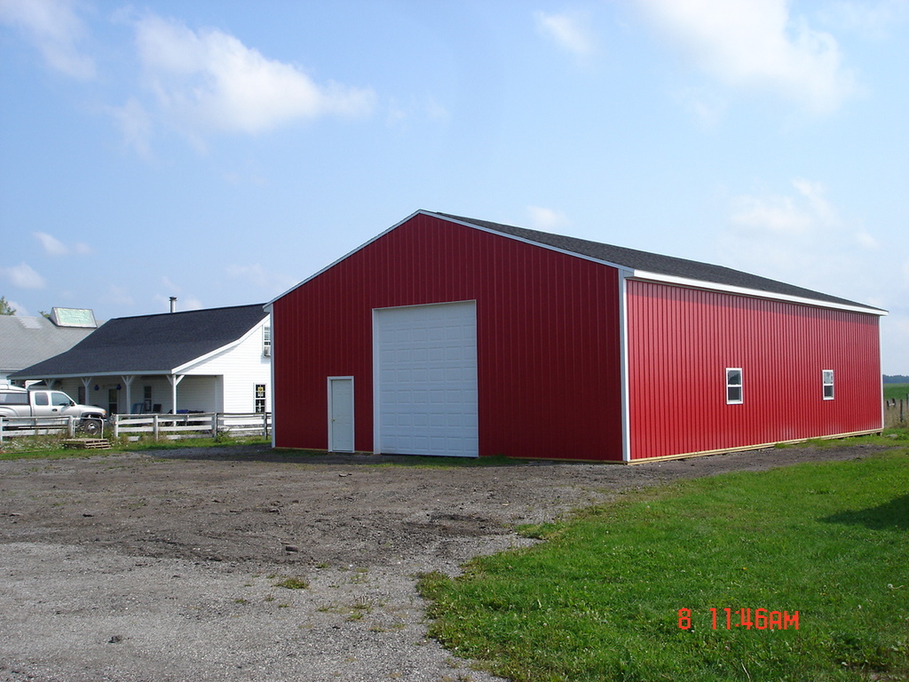

Box blades are not used at an angle. A 60 inch blade will cover your tire tracks. I will sometimes spin my wheels pulling my 60 inch if I fill it and am not using the 4 wheel drive. I don't think my tractor would pull anything larger. It holds a lot of material, probably twice as much as the 48" box blade that was next to it at TSC. With adjustable rippers you don't need any weight to get good results. My parking area was recycled asphalt that had been compacted for several years. My 7 foot sdandard grader blade wouldn't even scratch it. My box blade dug in and ripped it up and moved it without hesitation. I also used it to level an area for an above ground swimming pool. The ground was full of tree roots. The rippers tore them all loose and permitted the area to be graded. A standard grader blade will just ride on top of the roots.
The pictures show the material I stacked up pushing the box blade in reverse. I pulled the blade to rip the material loose and then backed into it to stack it. This was driveway material that I moved a couple hundred feet. My old barn had doors and driveways on the south and the north side. My new barn only has a door on the west side so I had driveways that went nowhere. I removed the recycled asphalt for future use and replaced it with dirt so I can grow some grass in those areas.
