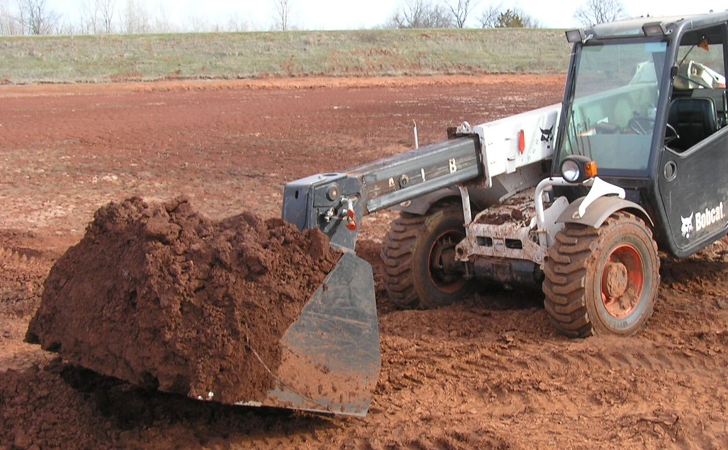

And my compact telehandler will out dig a CTL.
This is a 1 cubic yard bucket in clay:

Those are IMPRESSIVE Bobcat telehandler pictures. But if your telling me you got that bucket load in one efficient movement, then I gotta say you have some kind of ground, I have never seen before.

You could put a yard bucket on the biggest CTLs if you wanted to. I’ve never been on a mini telehandler but I’ve been in mini loaders as in 5 tons or so and their dirt moving performance isn’t even close to a CTL.
I put that same bucket on a bobcat T300 in the same place that I used the V417 just days before and the CTL struggled to fill the bucket with the clay subsoil. You are not considering the extra force available to fill the bucket by extending the boom on the compact telehandler.
It is hard red clay and some sandrock.
The teeth are very sharp and with 14,000 pounds of push, the bucket gets filled:
A 300 is a ton lighter than other CTLs.

So, do you drive into the material, apply brakes and extend the boom? Does that net more breakout force than the wheels can provide? I mean, inability to get a bucket is usually about loss of traction, not lack of HP.
