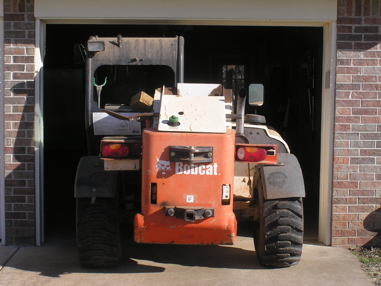

My compact telehandler fits through a standard garage door and the ROPS is up :) .
