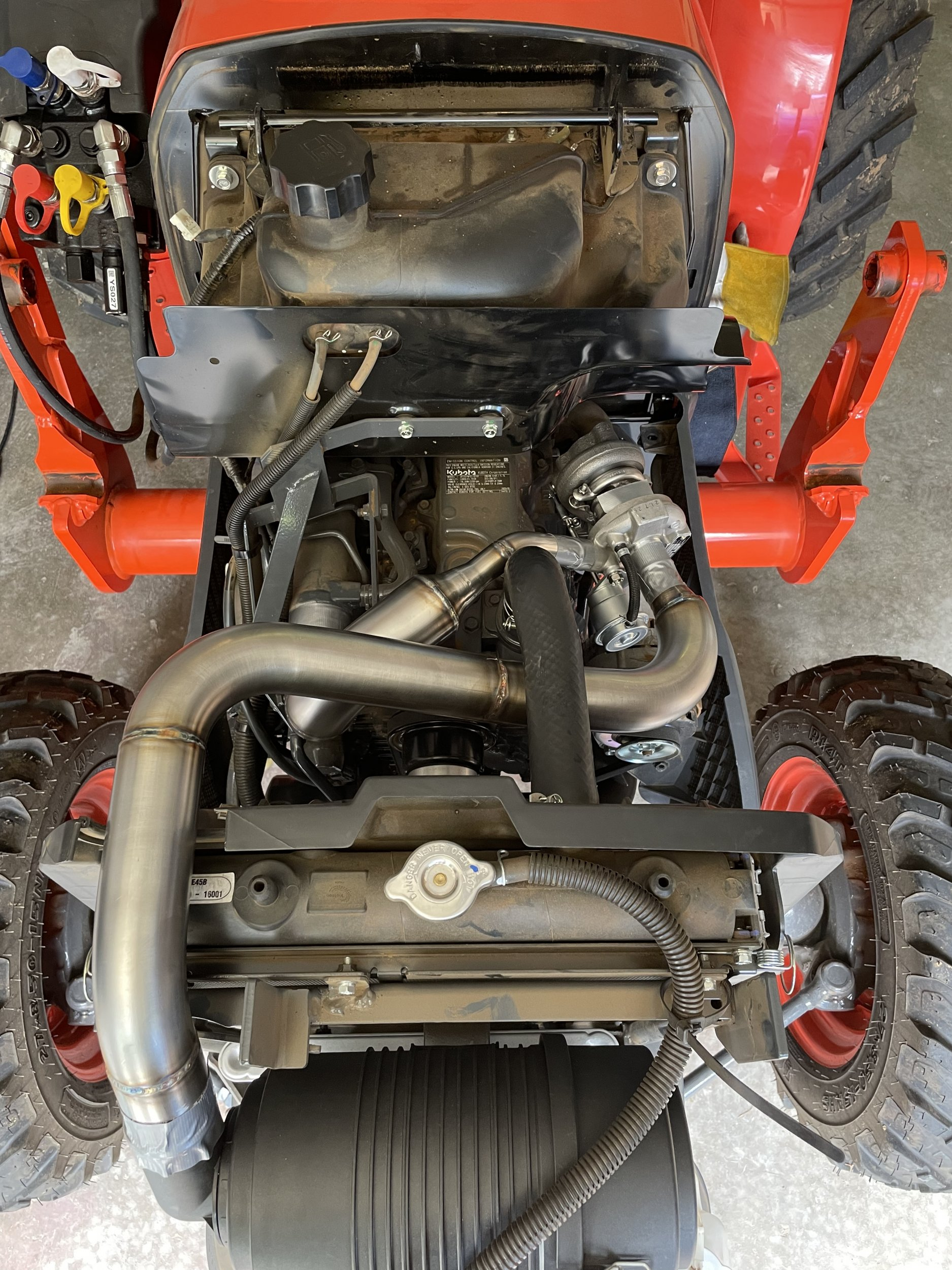

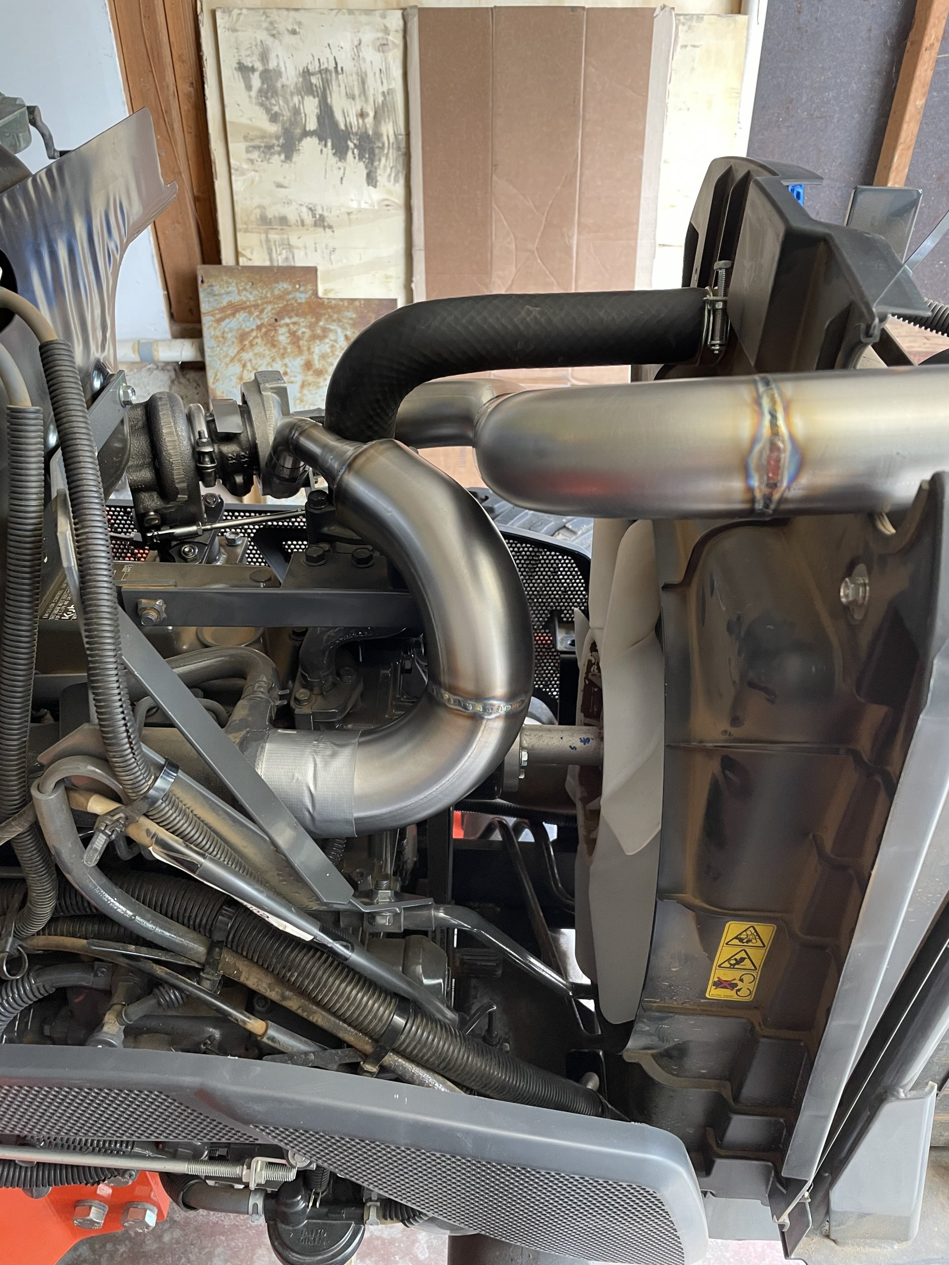

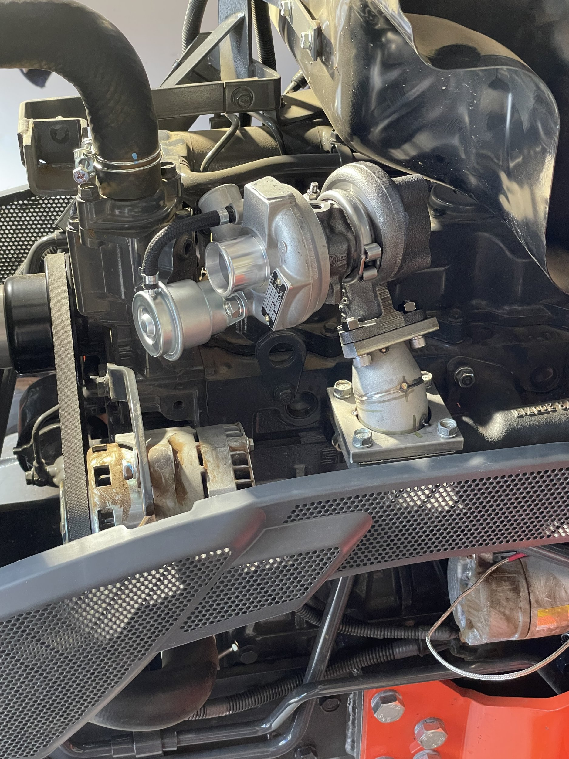

Here’s the progress I’ve been making with my L2501 Turbo setup;
Please forgive the duct tape, the silicone couplers and hose clamps are expected to arrive tomorrow.
We’re working on the down pipe now.
Aside from a small fueling adjustment, this turbo setup will be a complete bolt-on and operate within the OEM RPM range without any modifications. It should produce 45-50HP…and definitely cost less than the price difference of a L3901/L3902 and should be less than even a L3301/L3302.
Mike
Mike
looking good mike! 👊

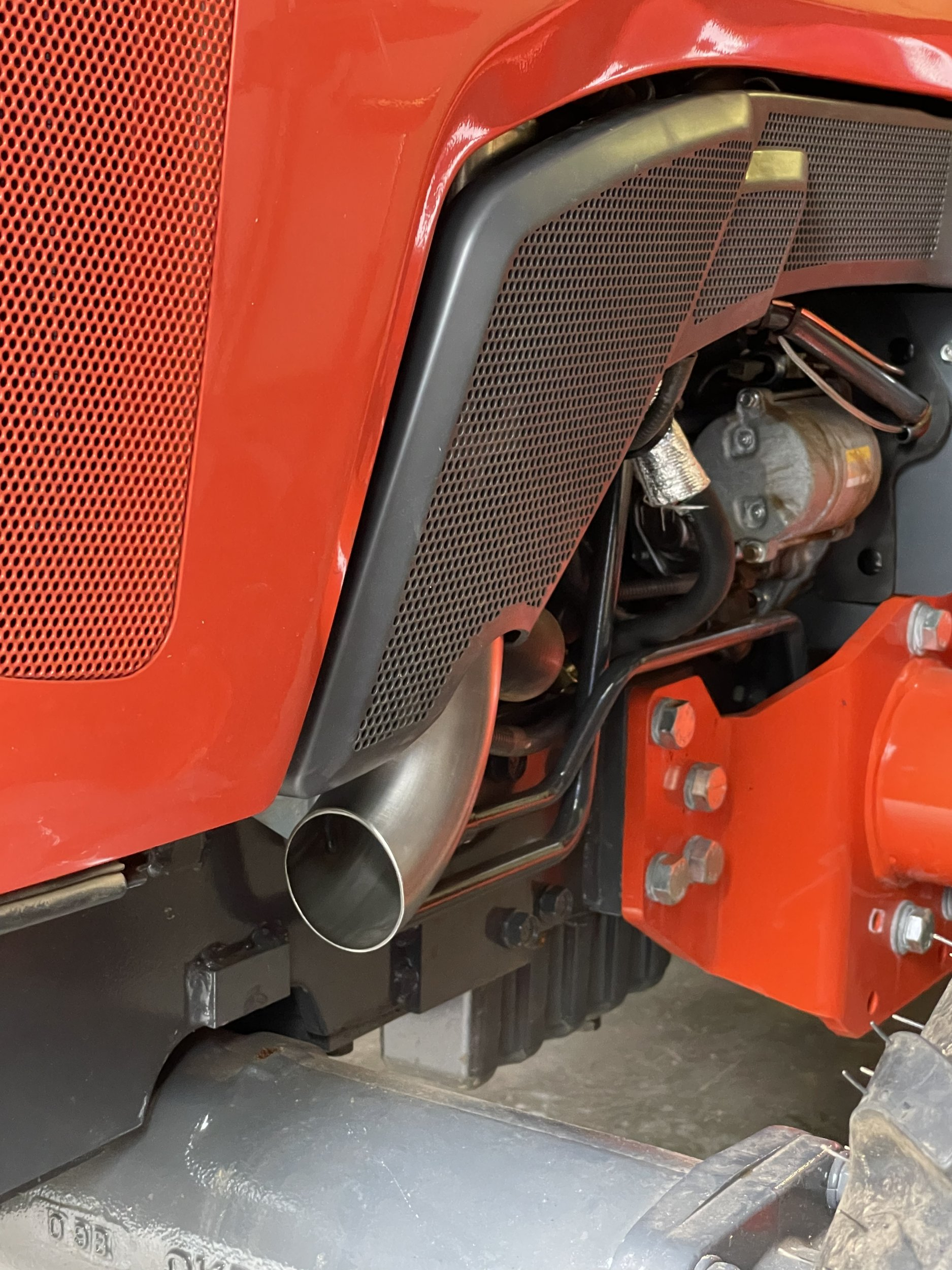

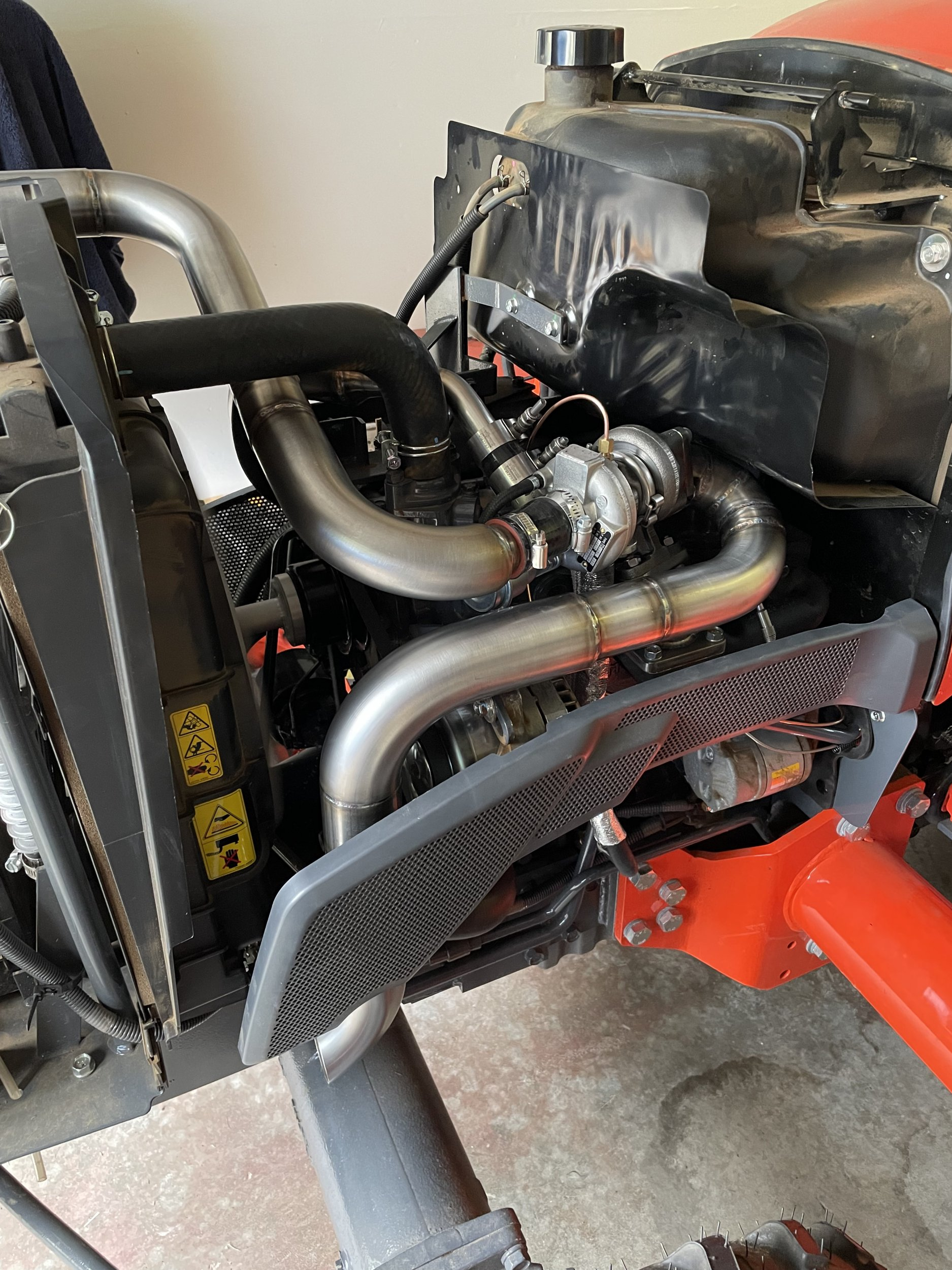

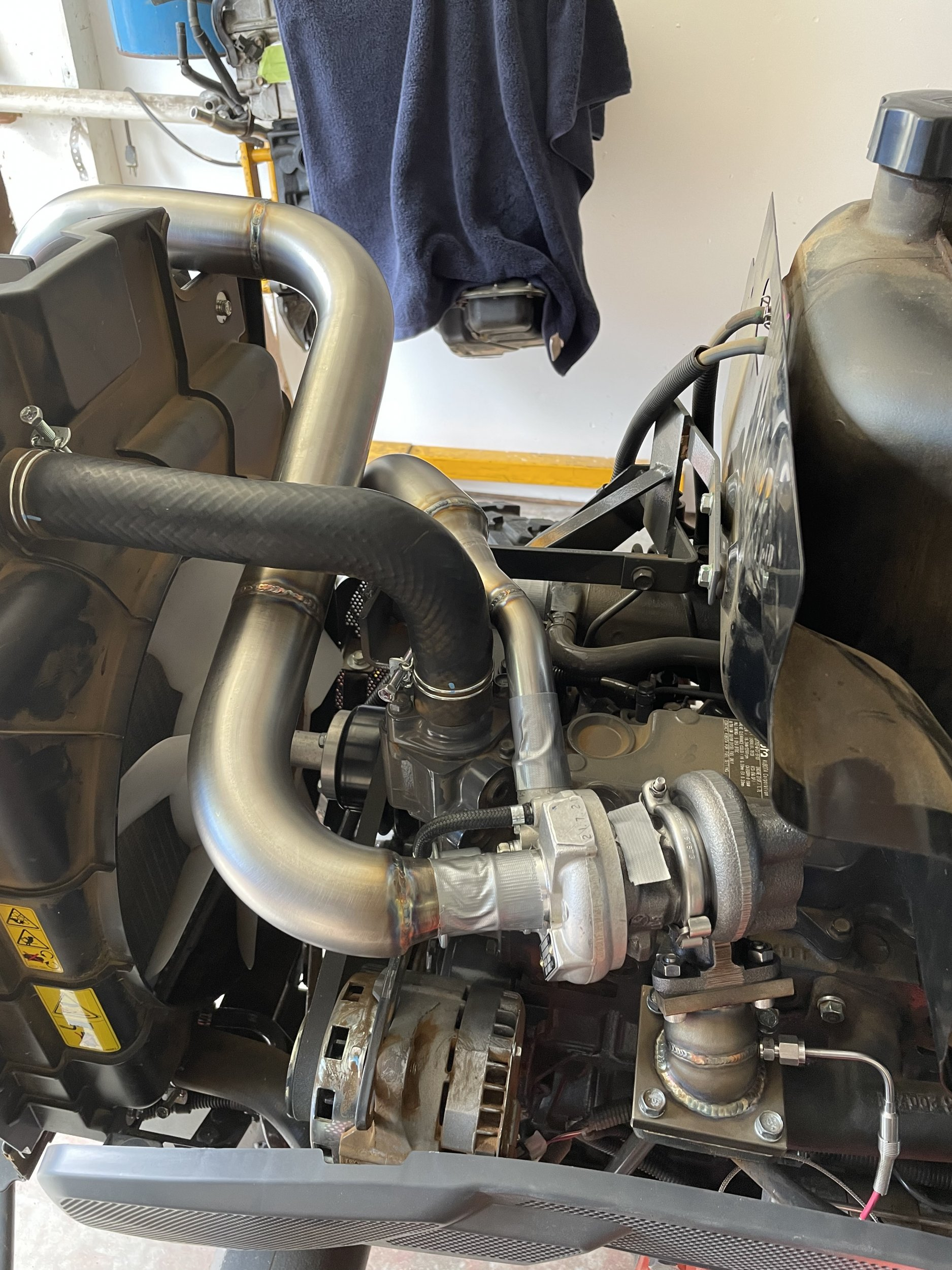

The L2501 Turbo setup is finished and running;
We made one rookie mistake on the intake charge pipe, we didn’t account for the hood prop-rod/absorber. So, we’ll have to redesign that pipe in the near future. Shouldn’t be a big issue.
I’ll have the tractor back on the property tomorrow and should have some time to run it around on Sunday. I’ll start making fuel adjustments next week.
Mike
