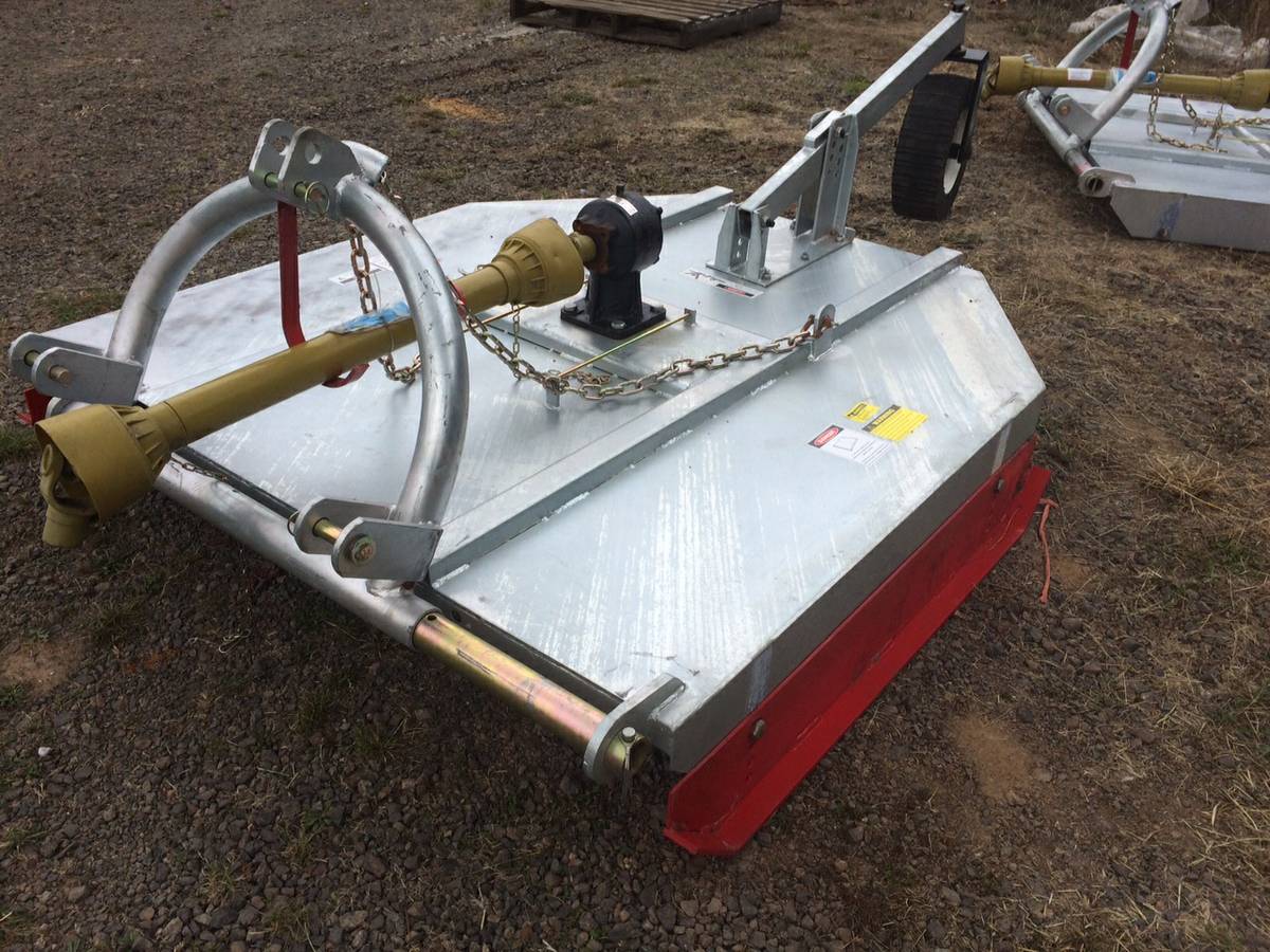

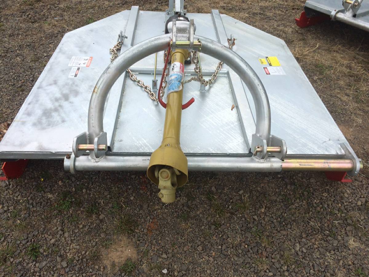

That would be cool. Never saw one that swings across the rear of the tractor for use on either side. Would definitely be hydraulic driven. Would require one remote to run the cutter, one remote to swing the main boom, one remote to change the angle of the wrist. Doable, but complex. I'm sure someone will chime in with a pic of such an animal. :)
Use this idea with a hydraulic cylinder and offset on both sides..
