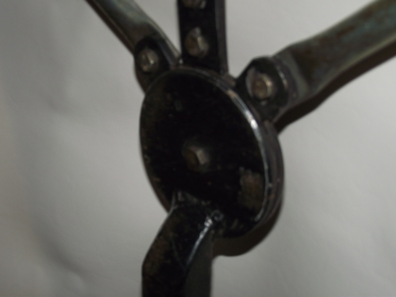

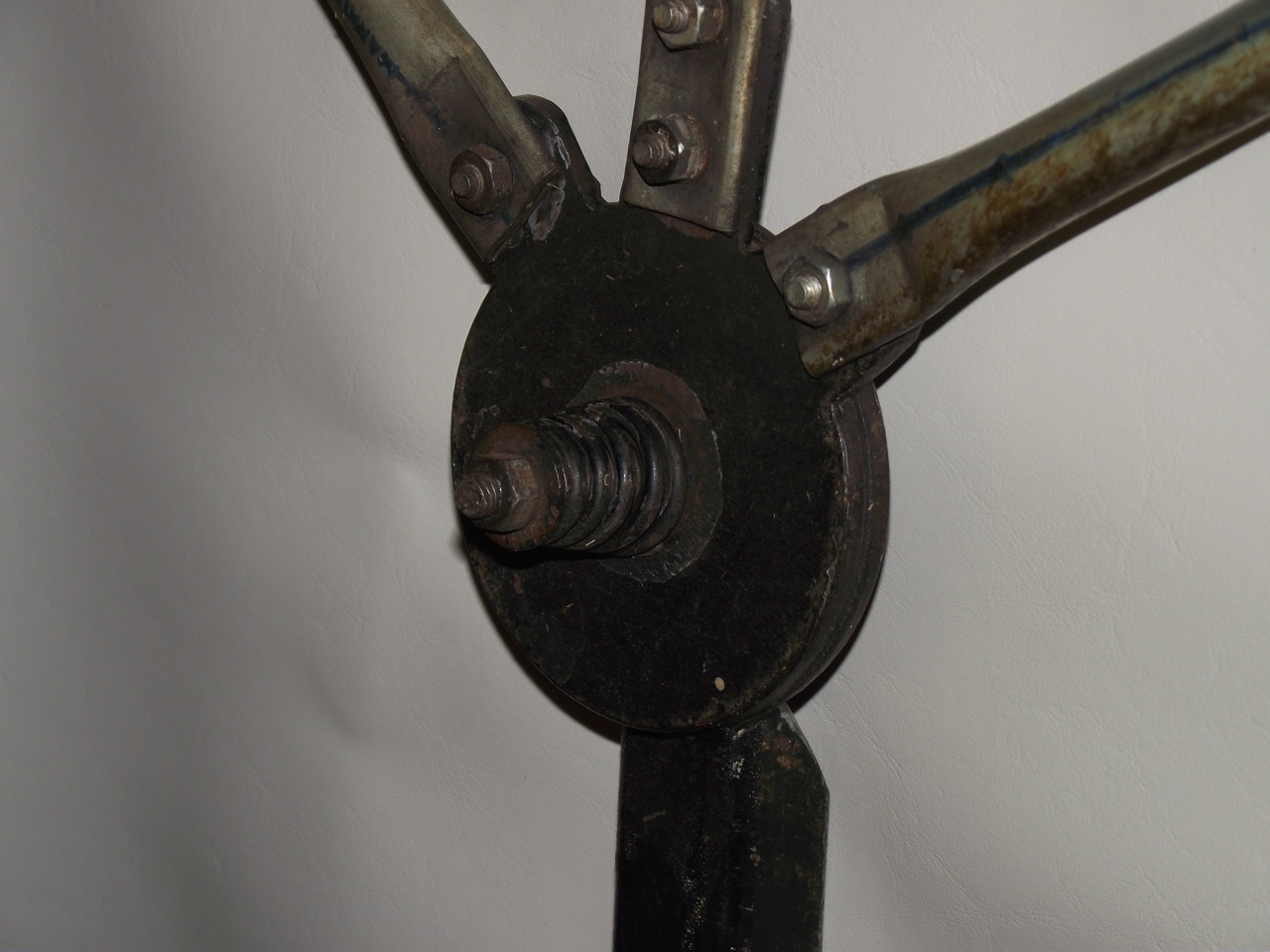

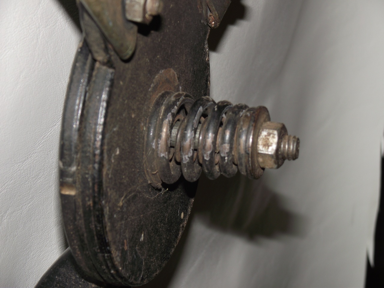

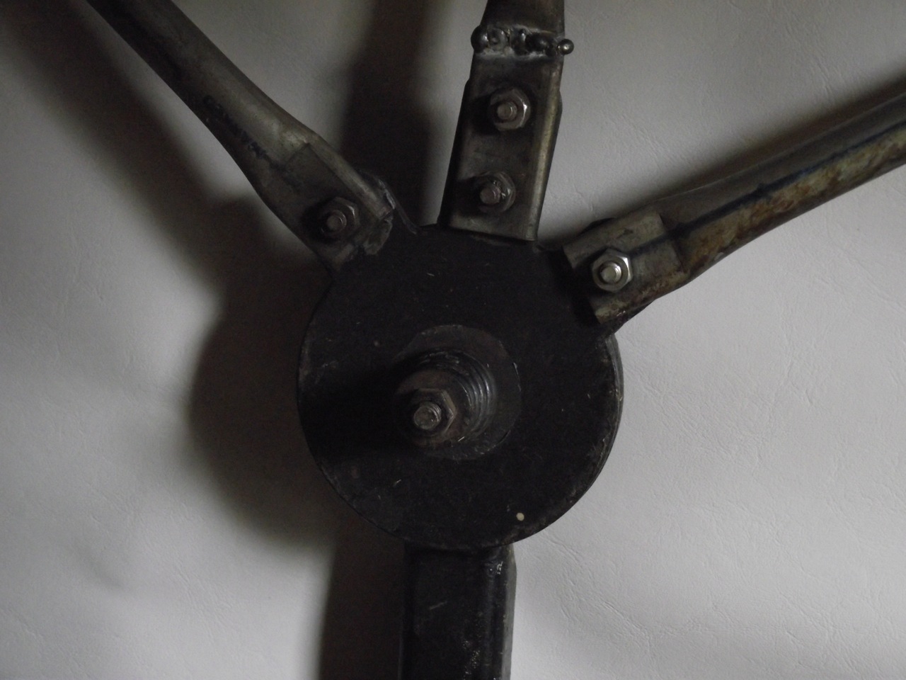

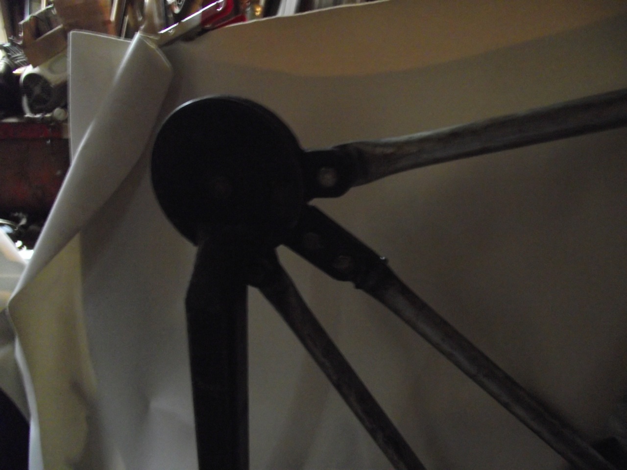

Here are the photos of "spring/disc/ball assembly". Not as good as I had hoped, but the best I could do.
The Build:
I went to a local auto parts store and found he stocked some 3/8 SS balls. I needed 2 but bought 4.
I cut out the four = 1/4" steel discs drilled a 3/8" center hole, and welded one to each of the upright supports. I welded 3 tabs on the other two discs for the bows to bolt to.
I then bolted each pair together and drilled a 1/8" pilot hole with the center tab extending straight up. I unbolted each pair, and enlarged the 1/8" hole in the one that was welded to upright to 3/8" and deep enough to let the ball go in about 2/3 of it's diameter. I enlarged the hole in the discs with the tabs using a 3/8" bit, but drilling only about 1/8" deep.
The depth will depend on how easily you want it to fold back, how well it is lubricated, and how strong the springs are. I did not grease mine, but after several years, I took it apart to weld a broken bow and greased them. After that, I had to get stronger springs or it would fold down without any reason. I am now using 2 springs on each set of discs, one inside the other. They are all old brake springs etc. that I have collected over the years.
The Build:

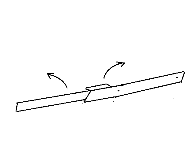

Thanks guys. I hope that's enough info. I could not get good enough pics of the braces that hold the bows out, so I didn't post them.
The braces are about 3/16" x 1/2" flat strap steel. I needed 8 pieces, about 10" long with a hole in one end to bolt loosely to the bows. Joining them together to make 4 braces was the problem. I drilled holes in the other ends of 4 of them. On the other 4, I set the hole back about 3/4" from the ends. On this end, I welded on a small "L" about 1/2" long. This allows the brace to hinge upward, but not downward. When the brace is extended, it move downward slightly past center to lock in place. I pinned the 2 pieces together and tack welded instead of bolting to make it smoother.
To collapse the shade by moving the bows toward each other, I must raise the brace slightly. It's the same action used on an A Frame ladder to keep the two sections apart and used on some briefcase lids.

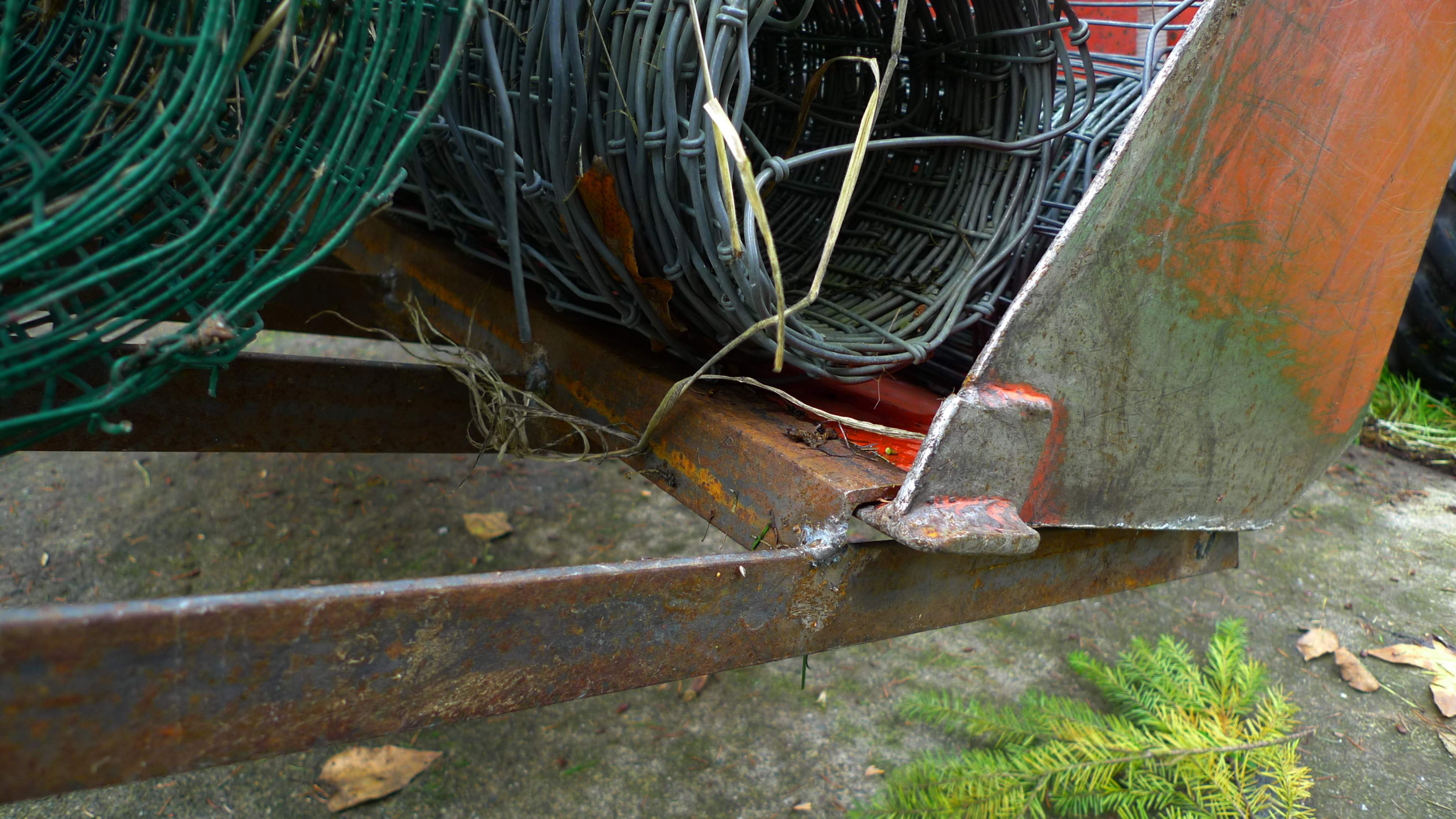

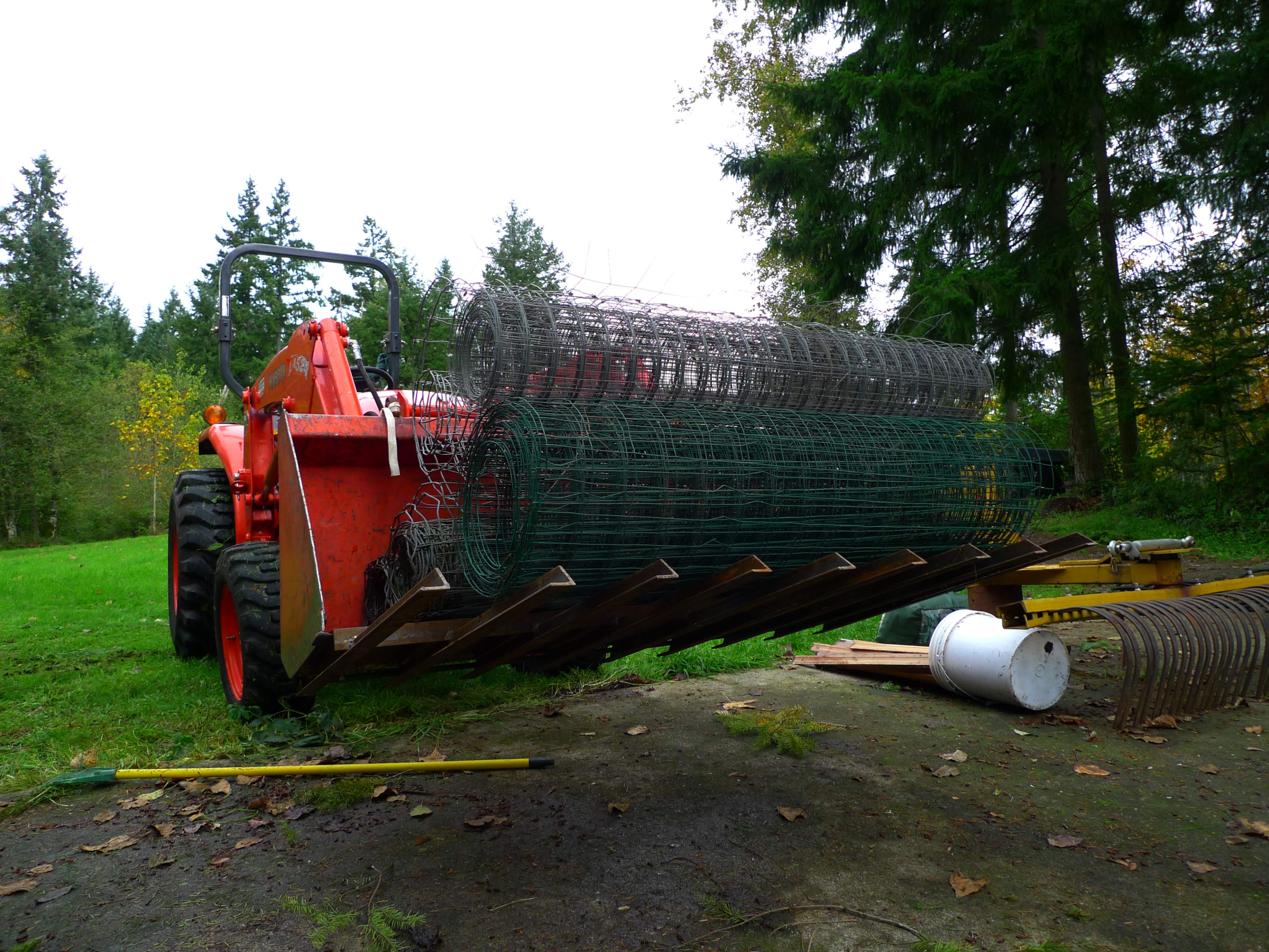

Some angle Iron forks, joined by an inverted angle iron to catch front lip of bucket.
The back edge of the forks are joined by tube and attached via ratchet straps
Greatly extends the width of items I can carry. Holds more light weight stuff too.
