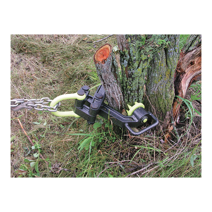

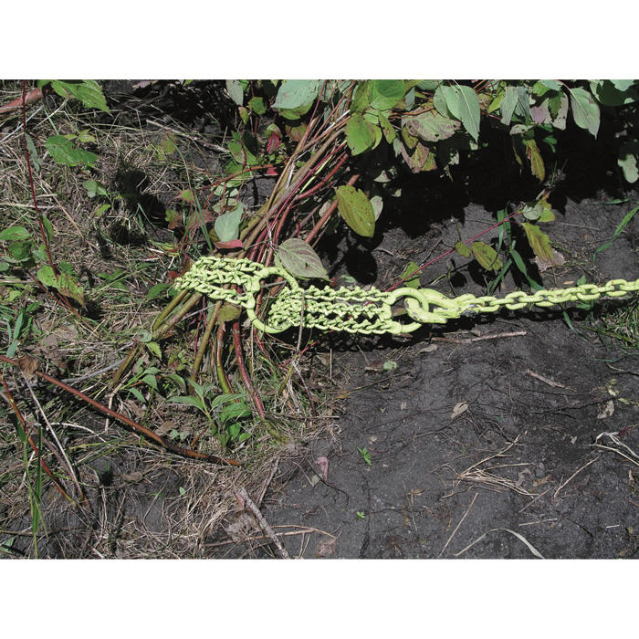

I made this choker for pulling trees and bushes. Just used it a few days ago works great. The choker hook posted here would go well with my choker. So I'm going to make choker hook.
If you feel your ears burning- it's because I'm copying that :thumbsup:
I didn't make this, but I'll take some diluted credit for re-purposing it:
http://www.northerntool.com/shop/tools/product_200679287_200679287
See below.
We use ours to pull shrubs, small trees, or I guess pallets- but basically anything the jaws will fit around- and for some of the smaller ones, they actually fit into the gap left when the jaws close completely, making the connection even more secure.
They were less expensive than the purpose built brush pullers/"grubbers" with the same capacity, and have a higher rated capacity than ones that are priced similarly, so I thought they were a good deal:

Then that family of tools also has shrub grubbers- but I like your design a lot more:
Brush Grubber Shrub/Clump Grubber, Model# BG-16 | Weed Control Brush Removal| Northern Tool + Equipment
shrub grubber 45.jpg $45

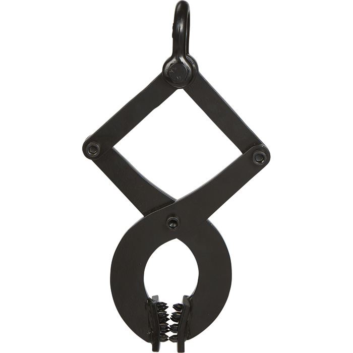

FYI if you already possess one of these "grubbers" it can also be used as a pallet puller.
One example might be not being able to reach that pallet of feed at the front of your pickup truck. Hook the puller to the vertical, center 2x4 stringer (NOT the top boards) and chain it out to the tailgate where you can reach it with your forks.
Terry
See- that's what I like about TBN- we make things work in ways they were not originally created for.
I also use ours manually sometimes with a short length of chain [or rope with a loop in the end] to shift pallets that we can't get into with our forks.

Here's an actual pallet puller. I gave mine away to my (trucker) neighbour quite a few years ago.

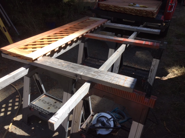

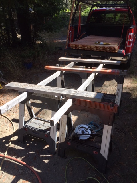

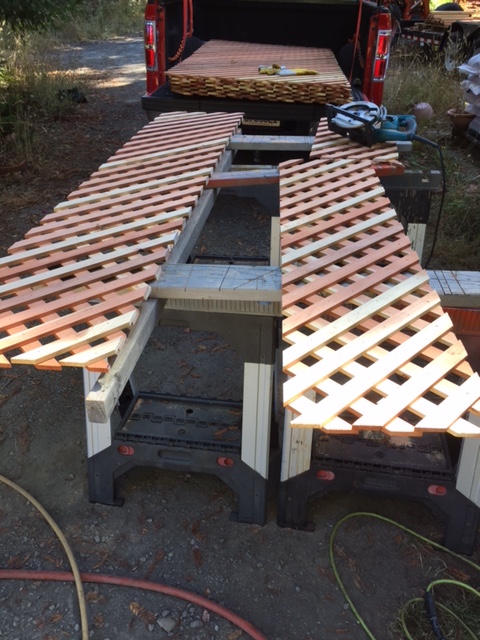

OK I know I posted this before, but that was a long time ago. This thing makes me smile every time I use it. Just a few boards screwed together, makes it very easy to cut plywood and other sheet goods accurately, without sagging or binding.
In this case it is 4x8 sheets of lattice, an awkward material. But cutting to size is a piece of cake with this setup, it is probably 12 years old now.
