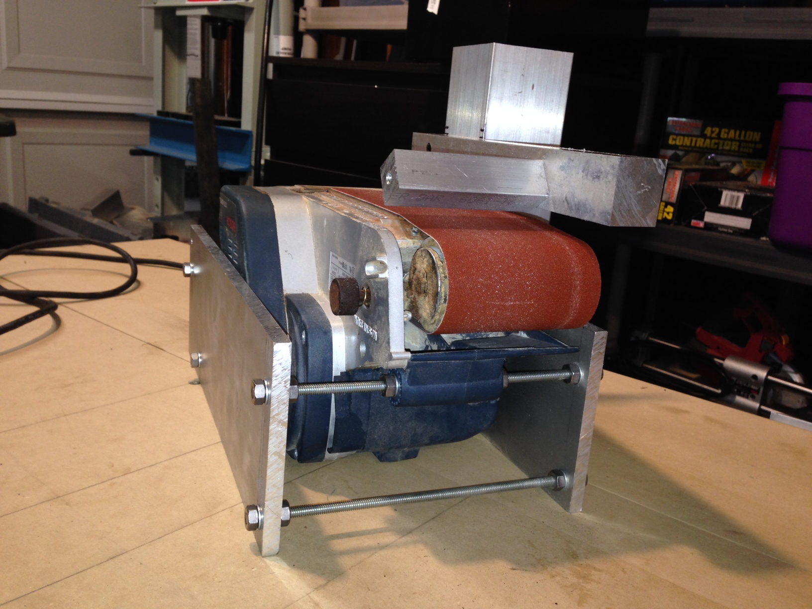

This is a belt sander stand I made. Bosch wanted 60 dollars for their stand made of stamped sheet metal with no fence. I put this together in a morning out of stuff laying around, it is very sturdy. The side fence works better than a grinder for getting a smooth square edge on metal. The front fence angle can be adjusted for different chisels. Kitchen knives are easy handheld.

Nice idea. ive set mine upside down on my table saw and used the rip fence jambed up against it to hold it to the table. and then the switch was on 'hold' and plugged it into the toggle for the table saw. Worked well. only got away from me once.

Now, I think I prolly gotta go find myself a belt sander, as it seems more utilitarian to do this with a portable one than to buy a fixed table sander, but still gives one the ability to use it for sharpening, etc.
